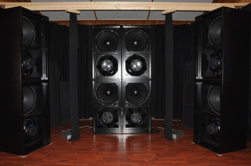

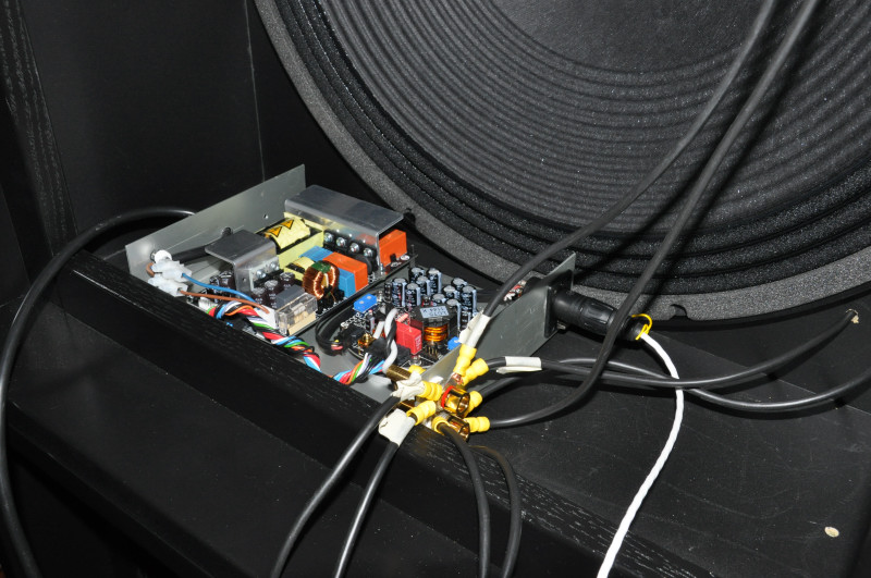

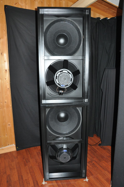

Ok, here's the last update, and it might be the very last thing I do with this system.
The news are:
Hypex Ncore amps - two driving the RD-75 ribbons, and four driving the woofers - and now there's sixteen of them.... a few pics without front grilles on the woofers below.
The news are:
The news are:
I can't see the system there are woofers standing in front of it.
The wall of bass.
- My open baffle dipole with Beyma TPL-150
