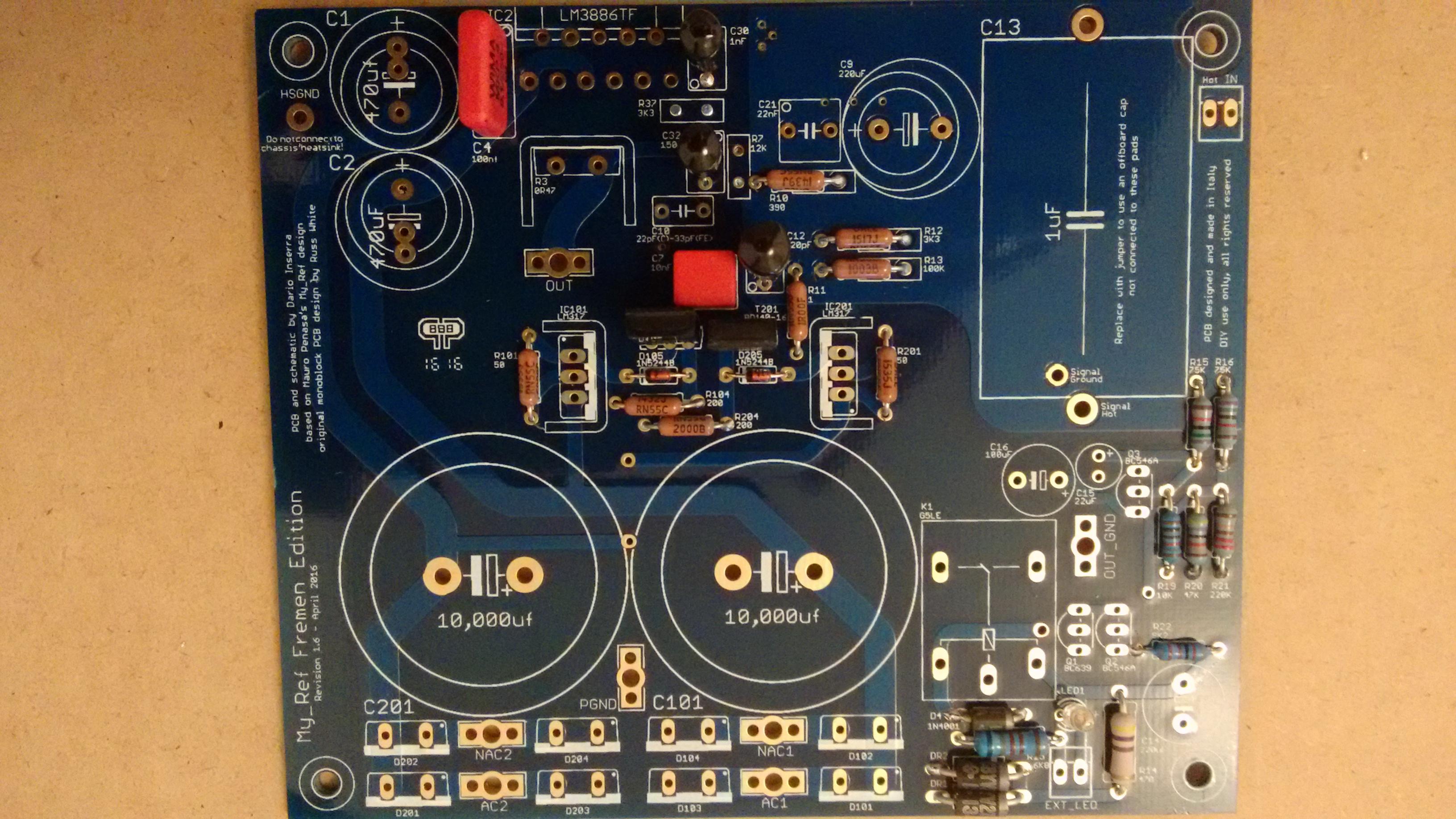

Nothing fancy... C21 will probably go and R11 orientation will be fixed, will be updated also orientations for Z-Foils, things like that.

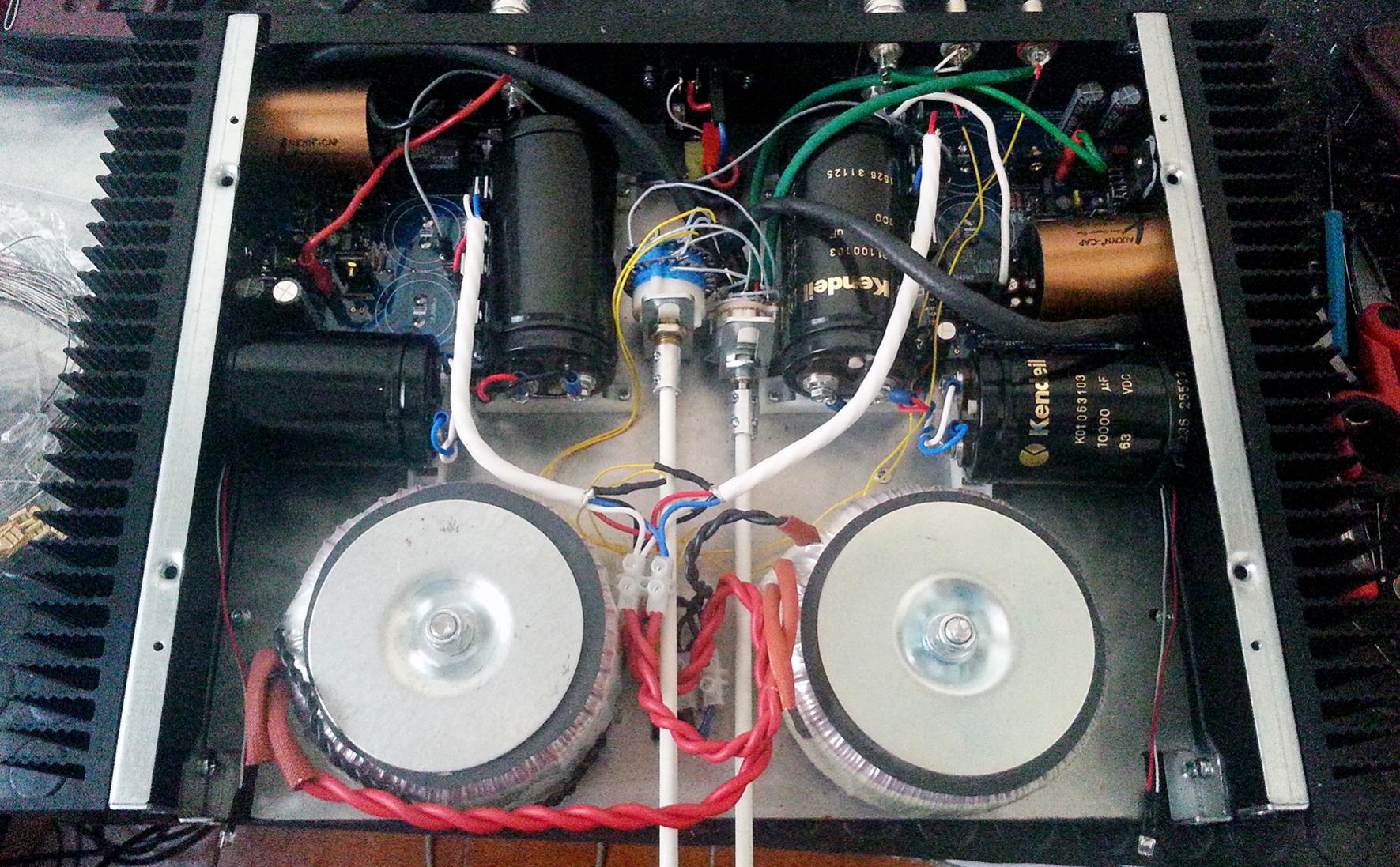

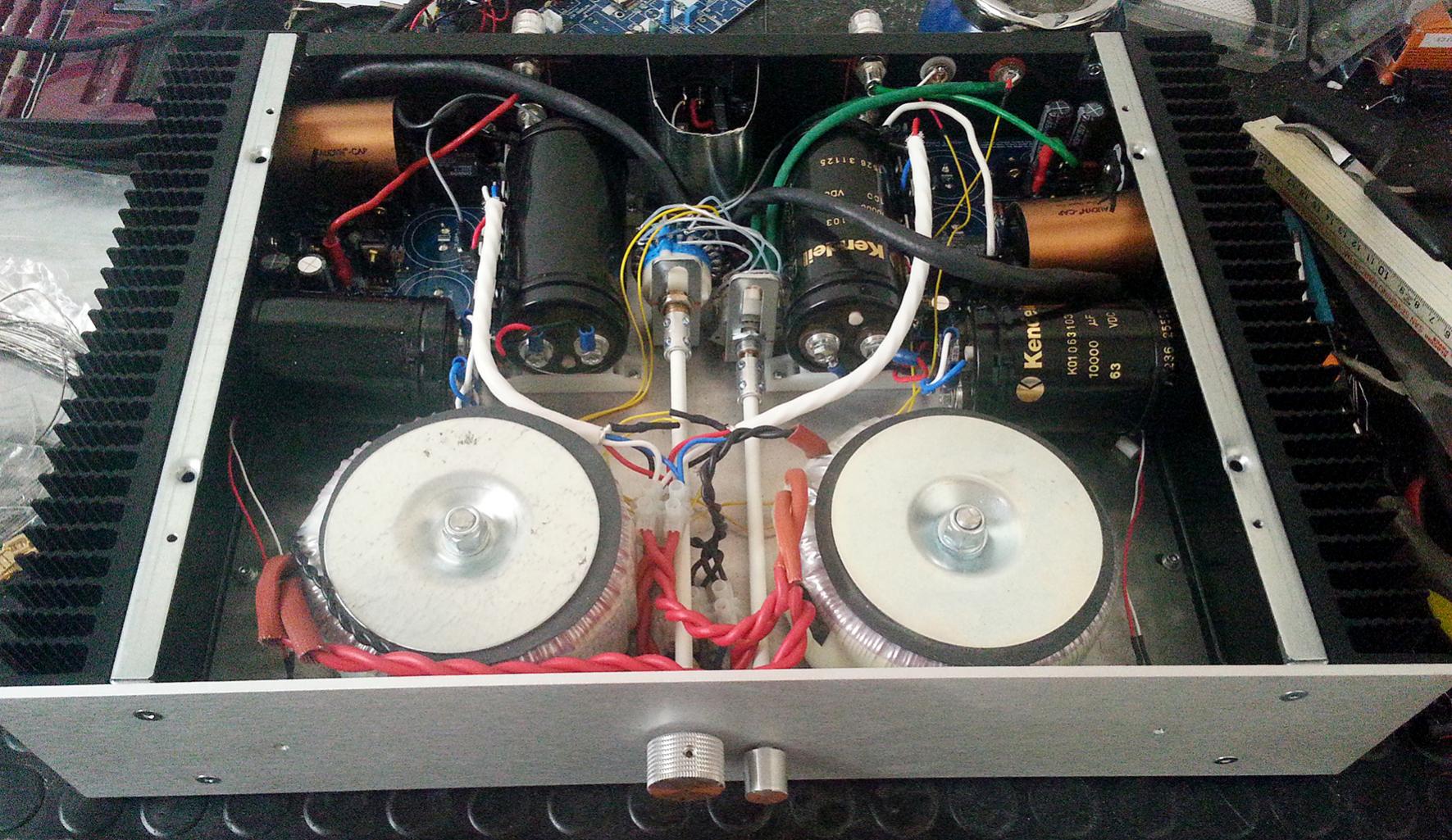

Hello, i finally completed my build, you can see below:
Very good sound. extremely detailed!
Lacked a bit of dynamics, something damped, but it's improving very much as times passes: absolutely needs some hours of burn in to start sounding really good.
No hum, no hiss, crystal clear!
Sorry for my low-quality pics...

Nice build
I would not have used such big cans outboard, though.

I would not have used such big cans outboard, though.![]()
I had them from a previous build, so i thought it would be interesting to prove them on My_ref FE. They sound good for now, we'll see after burn in...
Absolutely, the amp needs a few tens of hours to settle.
But it's getting better fast! After nearly 10 hours it has got to an higher quality level yet.

Good Job!
And perfectly clean boards, nice
