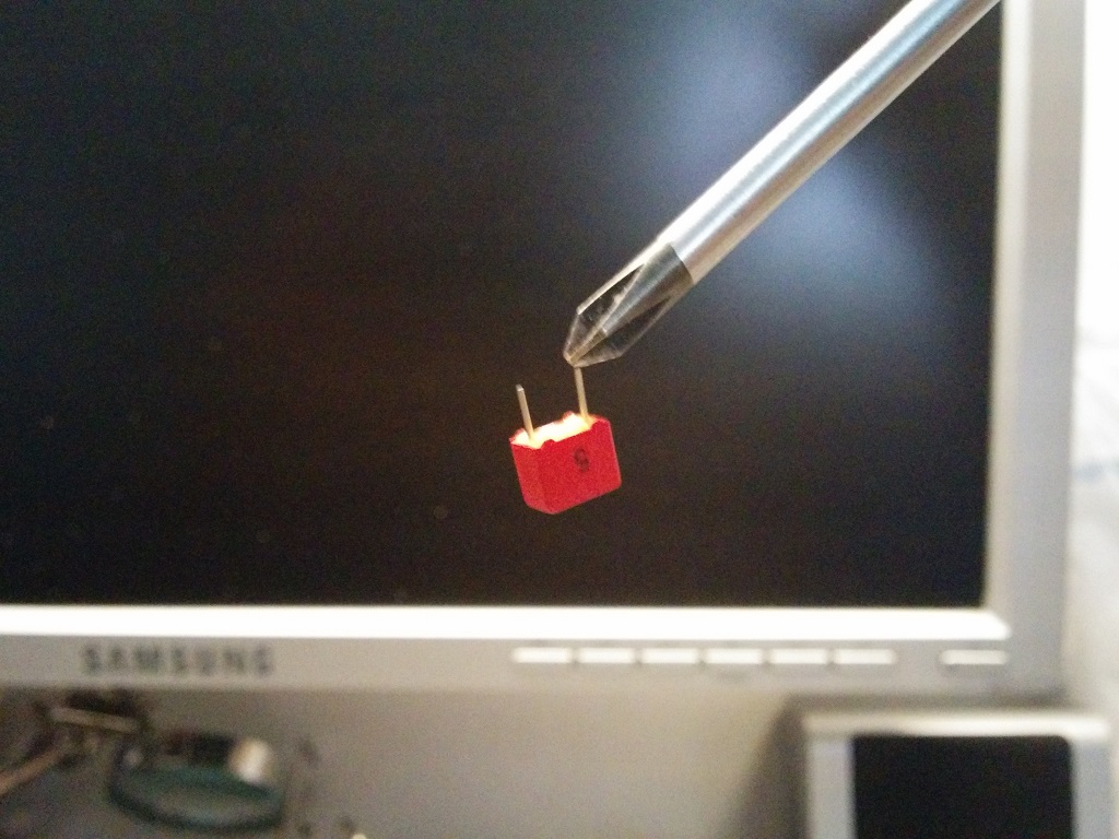

All Wima FKP's have non-magnetic leads, which is definitely a good characteristic for quality of sound.
Magic!
attachment.php
As far as a 100V sounding better than a 63V, well that's probably an easy call for anyone who can tell which direction passive parts should go in a circuit.
Hi Tom,
Unless I'm misunderstanding... It's quite surprising reading such a comment from you...
It's a known fact, among who believes in sound difference between different parts, that higher voltage rating caps usually sound better.
And in case of FKP2 it's so, just try for yourself.
Magic, or superglue, or fake?
Much simpler... magnetic leads.
While all 2.5% FPK2 have copper leads, the 5% and 10% parts could be shipped with steel leads or copper leads, quite all the ones I've bought in last 5 years from Mouser and/or RS Components have steel leads.
You can be a magician too... just try with a recent 5% FKP2 ;)

I just tested all my FKP's and found none to be magnetic. They are all 100V, some are 5%, some are 2.5%. There is no data sheet that specifies different materials between 63V and 100V, or for different tolerances. It's impossible for me to believe WIMA would make different construction for different tolerances; it makes no sense, and no company that I know of does it that way.
Hi Tom,
I don't know when you bought them but most of 5% FKP2s I have (bought from Mouser and RS Components) have magnetic leads.
I can post a video on you tube...

I don't know how old my caps are. Couple years? Then WIMA is cheapening their parts. Sad to learn that. The 2.5% tolerance parts might be older stock, and eventually they will run out of them. It is absurd to believe WIMA makes two different FKP's for different tolerances.
Hi Tom,
not all 5% are magnetic, from Mouser sometime you receive steel leads, sometime copper, no guarantees.
From RS Components and Distrelec always received magnetic parts (they stock 5% only).
I've first noted this difference at My_Ref Premium BOM times so we're talking about 5 years ago and Mouser re-plenished its stock several times.
Nothing changed, so I don't think 2.5% FKPs will become magnetic too.
It's not so absurd... from Wima's point of view, IMHO, if you need 5% or 10% precision steel leads will not harm that much and BTW they will be used in contexts where the added strenght could be useful, when you need precision 2.5%-1% copper leads are a significant improvement and still used.
Prices reflect that IMHO.
Another example are DALE CMF-55 which could be magnetic or not magnetic, it depends on how they're ordered.
