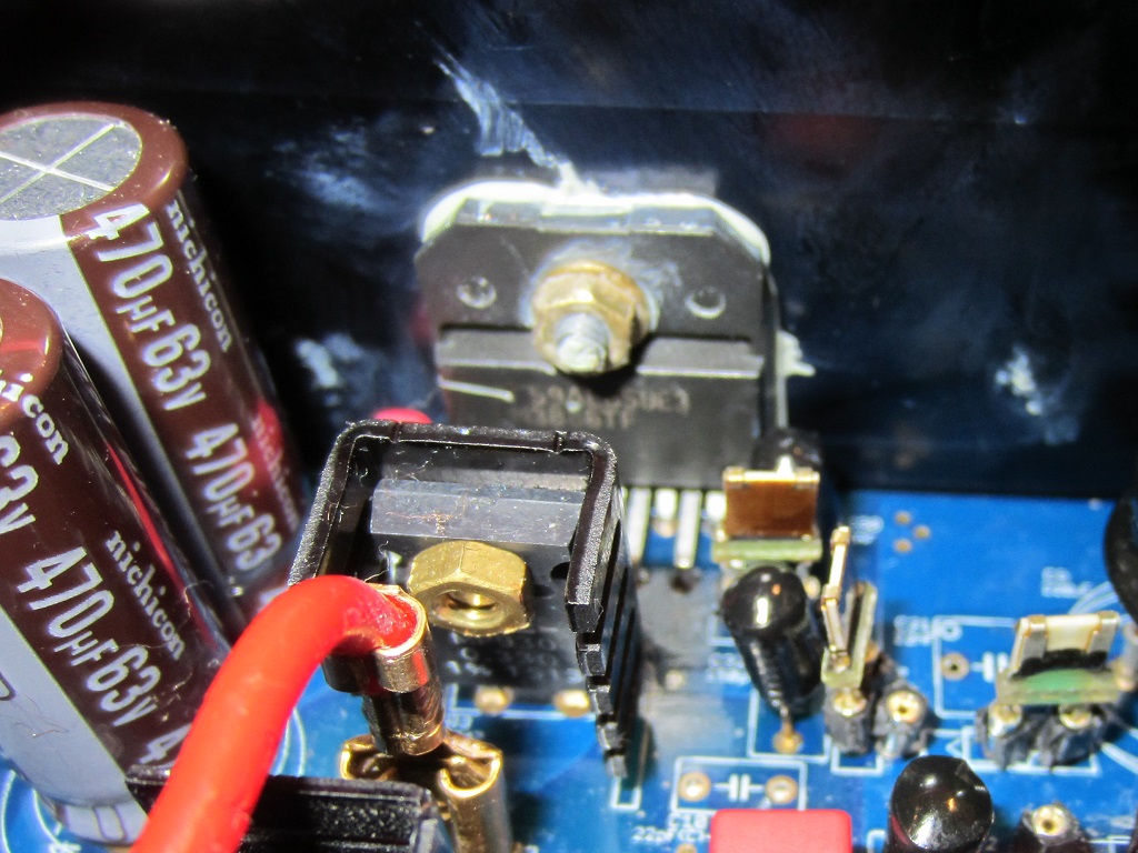

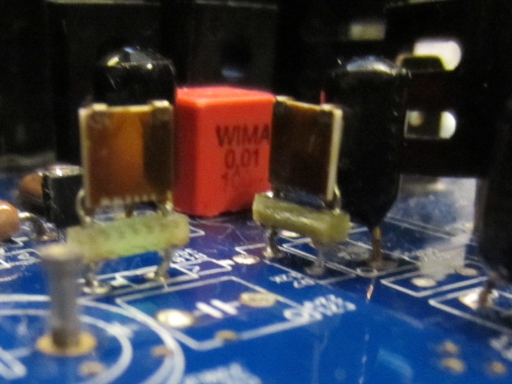

5 - Vishay VAR/Texas Components TX2575/Charcroft Electronics CAR in R7 and R10
I strongly suggest to upgrade them together, if not possibile R7 is more important.
What you can expect:
  • A more neutral and life-like timbre
  • More detail and deeper soundstage
  • An higher harmonic content
  • Cleaner sound
Z-Foils advantage increases as more of them are used, see orientation here.

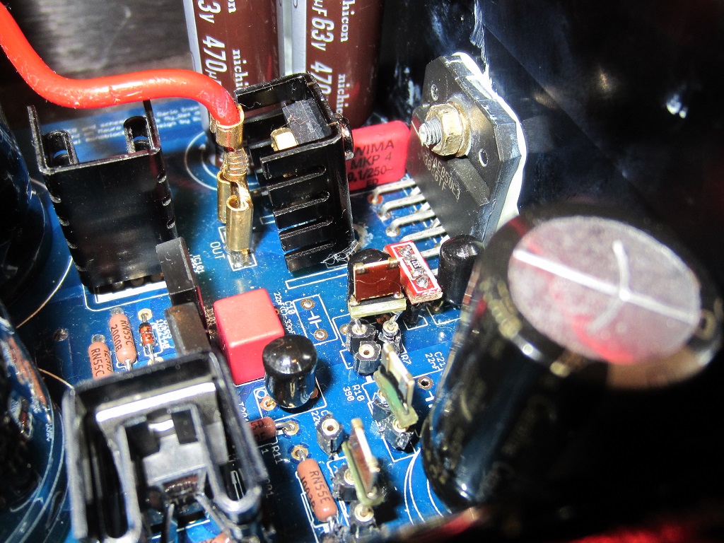

7 - Vishay VAR/Texas Components TX2575/Charcroft Electronics CAR in R37
  • Cleaner sound
attachment.php

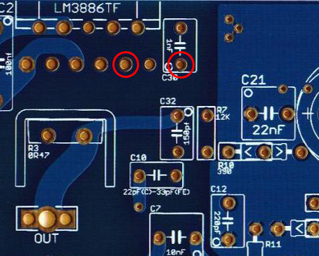

Hello,
in my v1.5 boards there are no through hole pads for R37, just smd pads.
How did you mount a z-foil resistor in R37? I can't see enough in the pics...

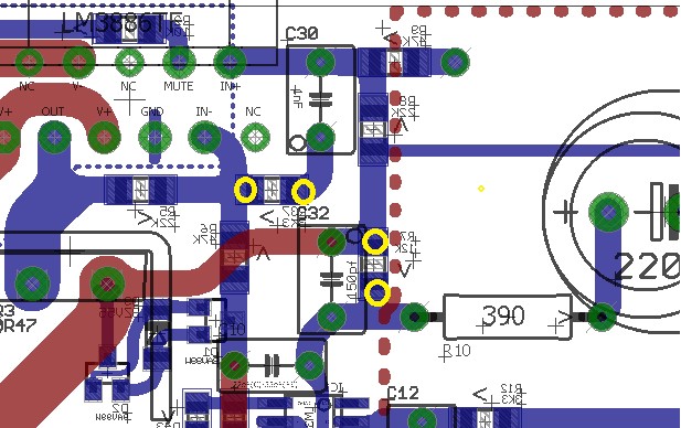

Same here, i think you can bend the legs into a small 'L' and solder that to the smd pads on the bottom of the board.
v1.5 boards have only SMD pads for R37 and previous ones also for R7.
But it's easy if you have a dremel or similar with a 0.8-1mm drill bit to make holes from the bottom side of the boards then you can mount through hole resistors.
No planes or traces are present over those smd pads on the upper side.
Just make attention to R7 which is near the 0V ground plane, you simply have to be precise.

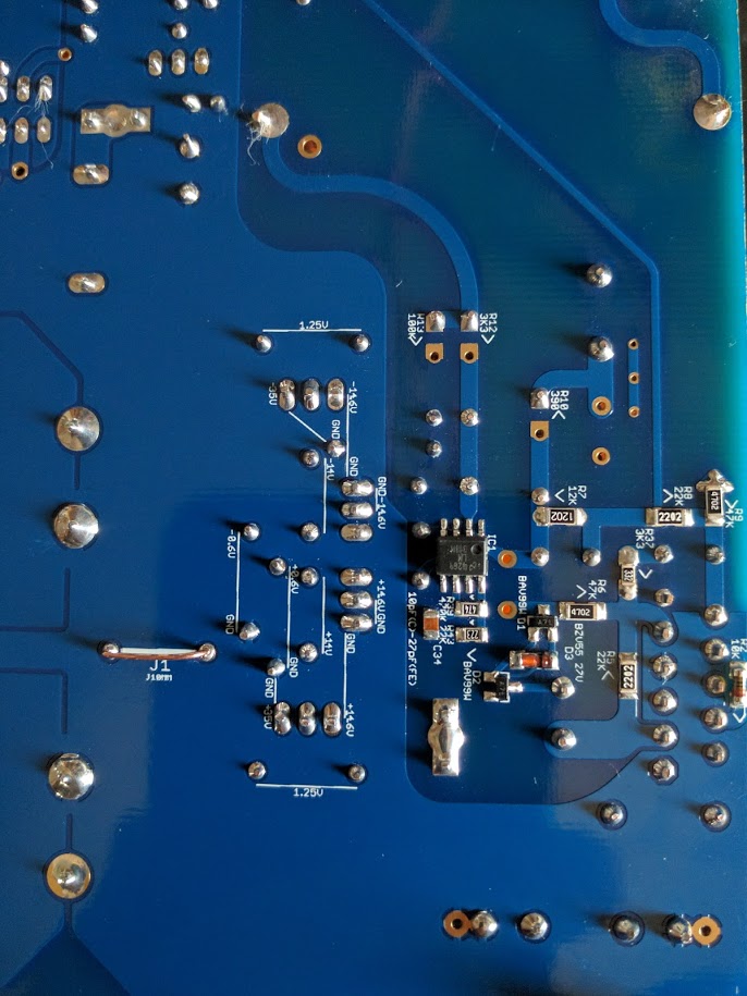

But... there's no risk for the Dremel bit to tear away smd pads on the bottom?
Maybe could i solder, on the upper side, z-foil legs to C30 lower pad and LM3886 second pin of the lower row? (see red circles in the following pic)
I had no problem with R7, as holes are on both surfaces: i just had to remove solder inside smd pads holes on the bottom, using my desoldering gun.
Thank you! I'll try...:xfingers:
You're welcome :)
I don't think so, those pads are part of a trace...
Obviously you must take care, use moderate to low pressure and rotational speed.
For more precision and safety you can use the smallest drill bit you have and then repeat drilling with increasingly larger drill bits until you have a hole large enough to let leads pass.
Using a powerfull drill with percussion enabled is not advisable, though... ;) :D :spin:
you will have longer leads and the added inductance could be a problem there...it's a delicate position, that net is critical for stability.
