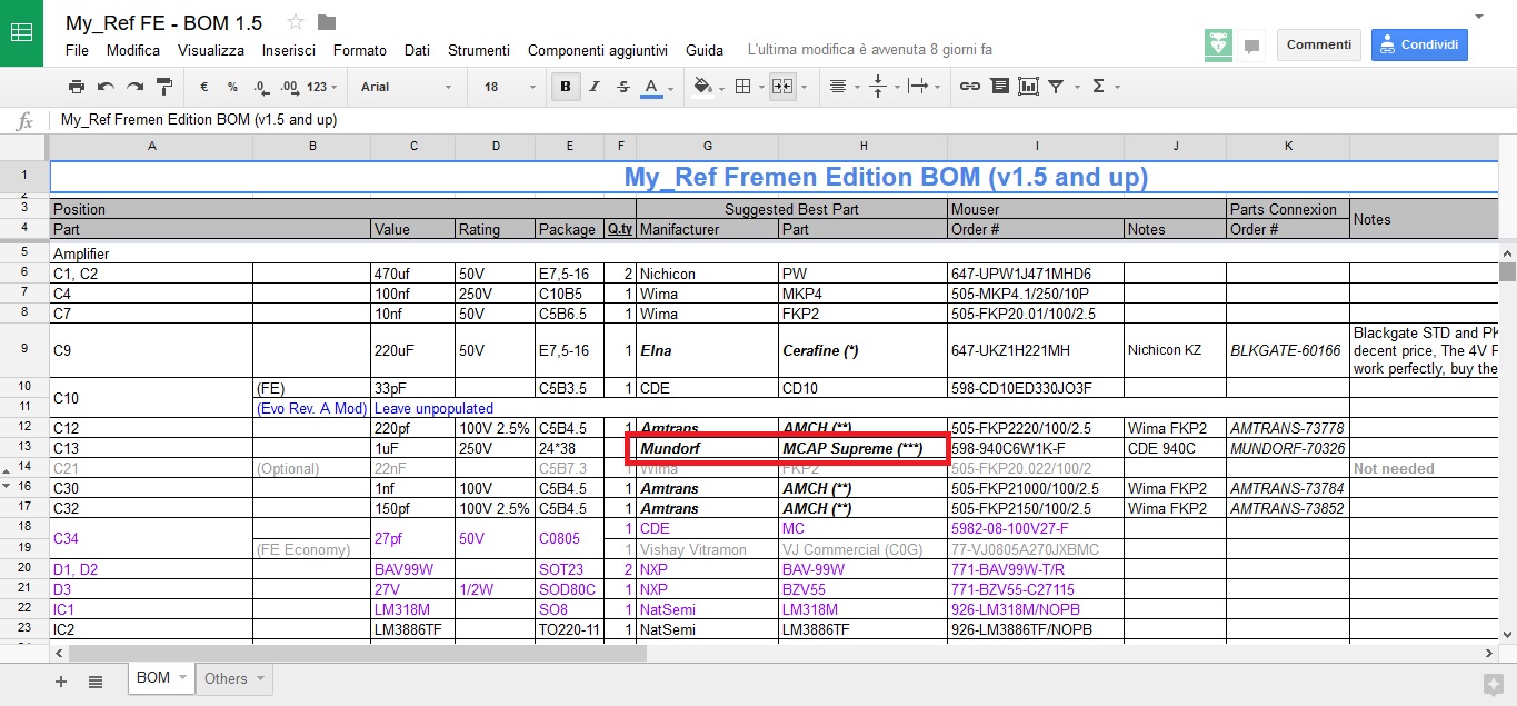

What I have to do to have the same configuration?

Yes, it is, in the 'Suggested best part' column:
In the same file there are in practice two BOMs, the official one is under the 'Suggested best part' column while there's also an 'industrial BOM' which can be ordered entirely from Mouser.
The two BOMs are identical except for a few parts which are not available from Mouser and that must be purchased elsewhere (Parts Connexion, HiFi Collective, Sonicraft, eBay, etc.).
A My_Ref Fremen Edition built using the plain Mouser BOM will perform and sound great and a lot of builders will be fully satisfied.
But, if you believe that different parts could sound differently, to exploit the full potential of the amp the 'Suggested best parts' column should be taken in account.

Using the 'Suggested best part' column AKA making all or at least part of the parts upgrades
But rest assured that the instrial BOM with added Cerafines will give you almost the same performance level, but to a lesser extent.
My suggestion is always to start with the industrial BOM+Cerafines.
Then, if you like what you hear, the timbre, the way it presents music follow the upgrades path according your budget, you will have the same sound with increasing detail and balance as the various upgrades are implemented.

Yes this part was clear for me. I'm referring to industrial bom, so for me Mundorf is not present...
What is not clear for me is that if mundorf supreme is the suggested part but it is a bottleneck, is it better to use the industrial cap?

But my comments were referred to the official full BOM, where the Supreme is present.
What I've said is that the Supreme could be a bottleneck after all upgrades are applied.
But in part I was joking.
Nevertheless the Supreme is superior to the CDE940C.

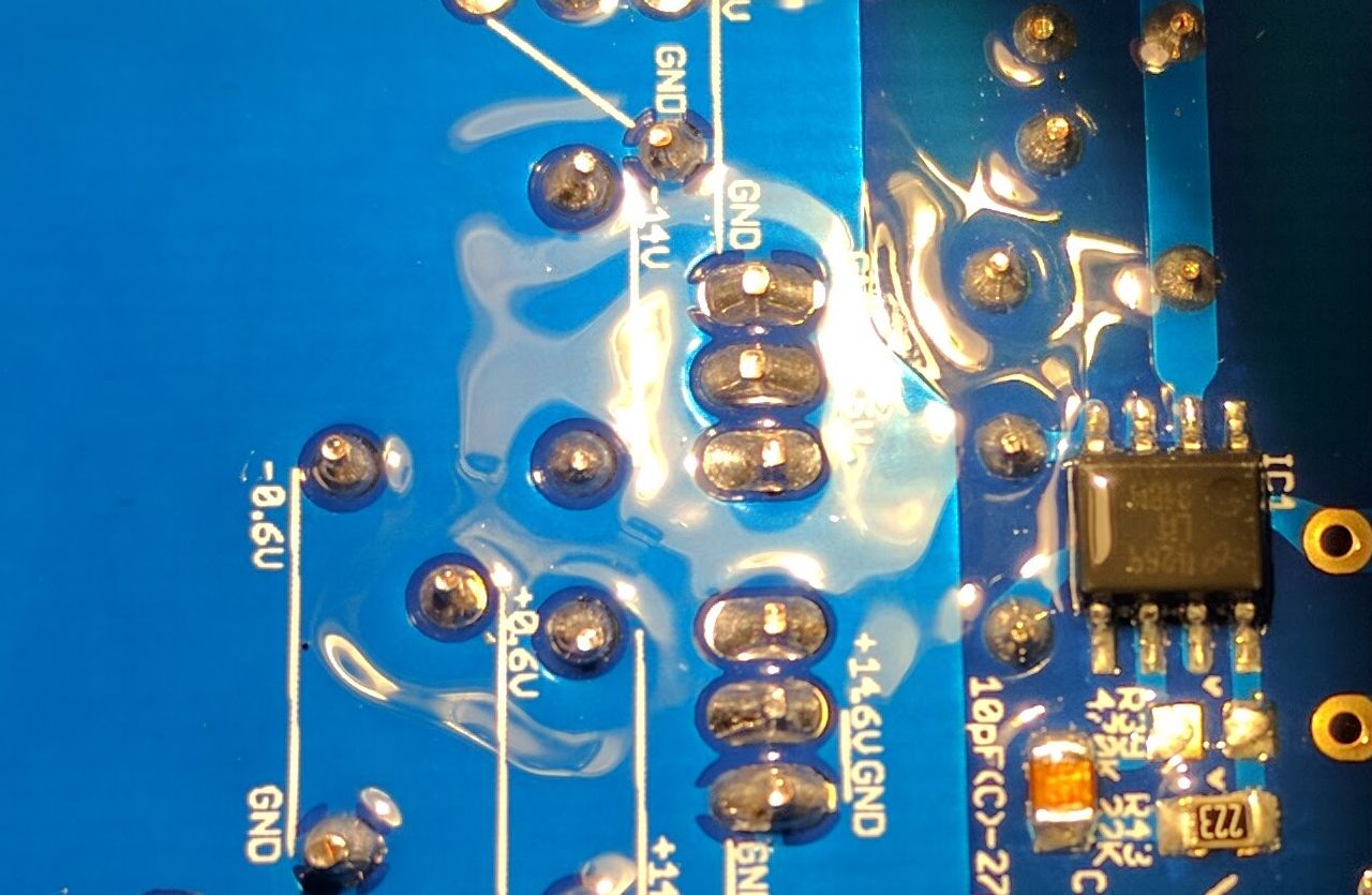

Today I started the first PCB (I'm buying parts for one PCB at time so I can get something in itinere keeping the free shipping.):

Do you see any orientation mistake? Hope not... I couldn't get to do so the side-by-side soldering "bubble", still dunno why. Anyway I checked all the joints and are OK.
BTW, I've used a silver based solder for the RN55s (got it from eBay a few time ago), but I got the ugliest joints I've ever done:

To obtain side-by-side soldering with ROHS solder often you have to add flux and an high enough temperature (not less than 340-350°C)
Pads on planes will never get hot enough, anyway.
Probably you used a too low temperature...or possibly a not good enough solder

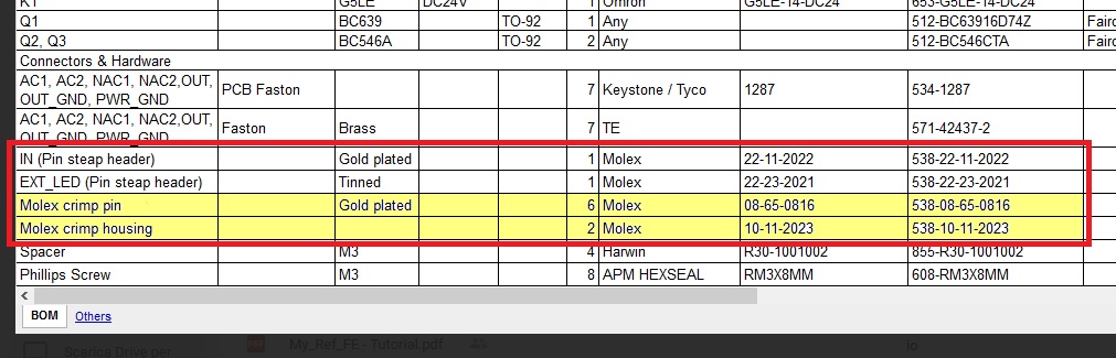

BTW: I've seen the IN has gold plated pins. Should I look for gold plated faston headers too, for out?
The fastons on BOM are very good quality ones but if you prefer you can order gold plated ones... I did.

Maybe both, that silver solder looks like needing higher temperature, and my iron is cheap one. I'm quite satisfied anyway, all pads are filled - just didn't get side by side. They are just.. opaque!To obtain side-by-side soldering with ROHS solder often you have to add flux and an high enough temperature (not less than 340-350°C)

Maybe both, that silver solder looks like needing higher temperature, and my iron is cheap one. I'm quite satisfied anyway, all pads are filled - just didn't get side by side. They are just.. opaque!![]()
ROHS solder often is opaque, it will look better after thorough cleaning.
The solder I've used for SMD parts is this one:
https://it.rs-online.com/web/p/saldatori/7568884/
And the final finish after soldering is pretty shiny for a ROHS one.
It's a strange beast, though... it melts quickly when you apply it but if you reheat it later it's pretty hard to melt.

Wait a moment... fastons are to be used on faston tabs...
On the Molex 2 pin goldplated input connectors you must use the mating connector, it's in BOM along with its crimp terminals:
http://eu.mouser.com/Search/Product...816virtualkey53810000virtualkey538-08-65-0816
http://eu.mouser.com/Search/Product...023virtualkey53810000virtualkey538-10-11-2023

Sure I did. When I asked "Should I look for gold plated faston headers too, for out?" I meant the PCB faston - since I have gold plated (molex) IN, I thought to have same for OUT.
