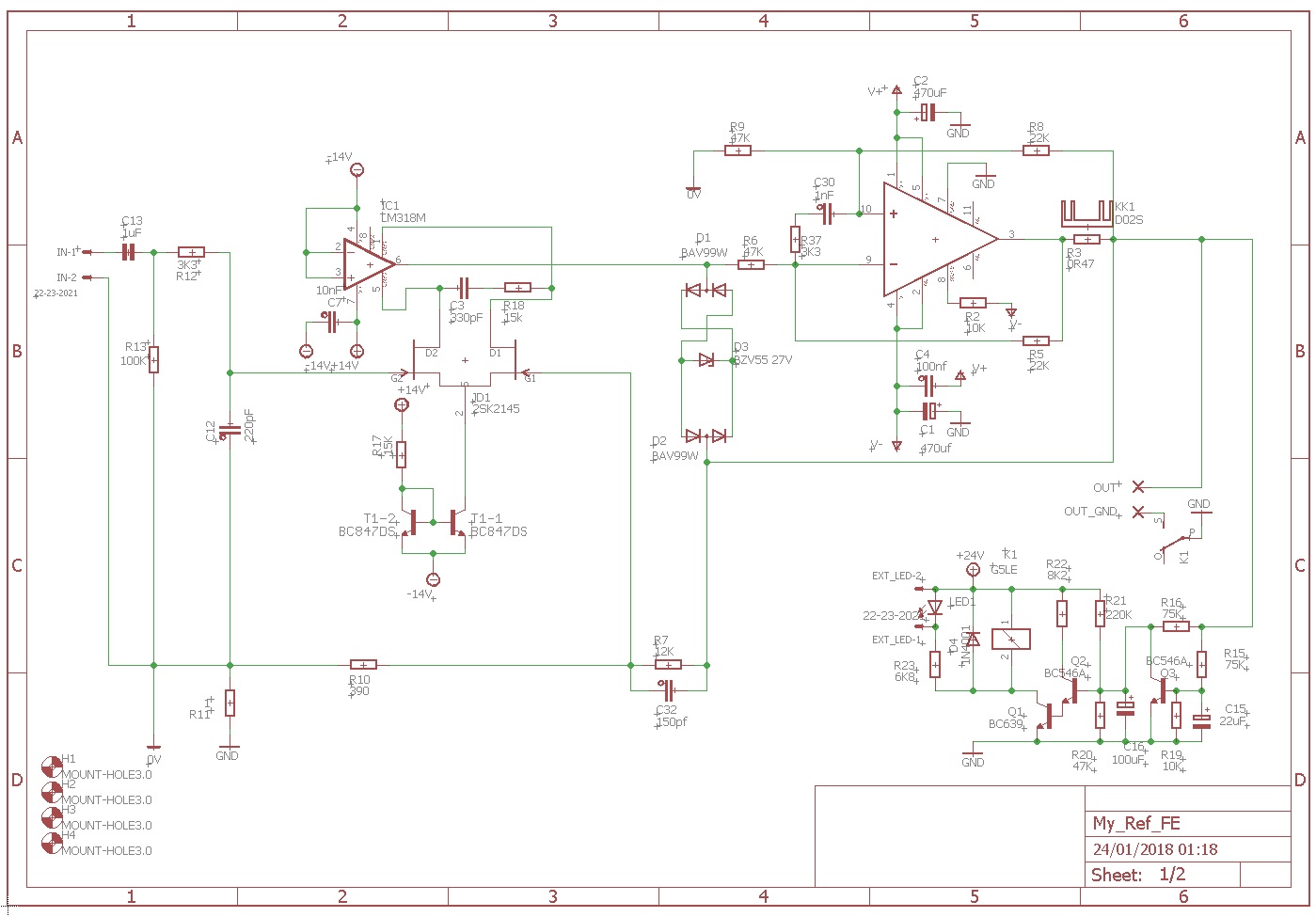

The whole input stage of the LM318 is disabled and it is replaced (using pins 1 and 5) by the jfet LTP, biased using a current mirror and compensated by C3 and R18.
In practice it makes a jfet input opamp the LM318.

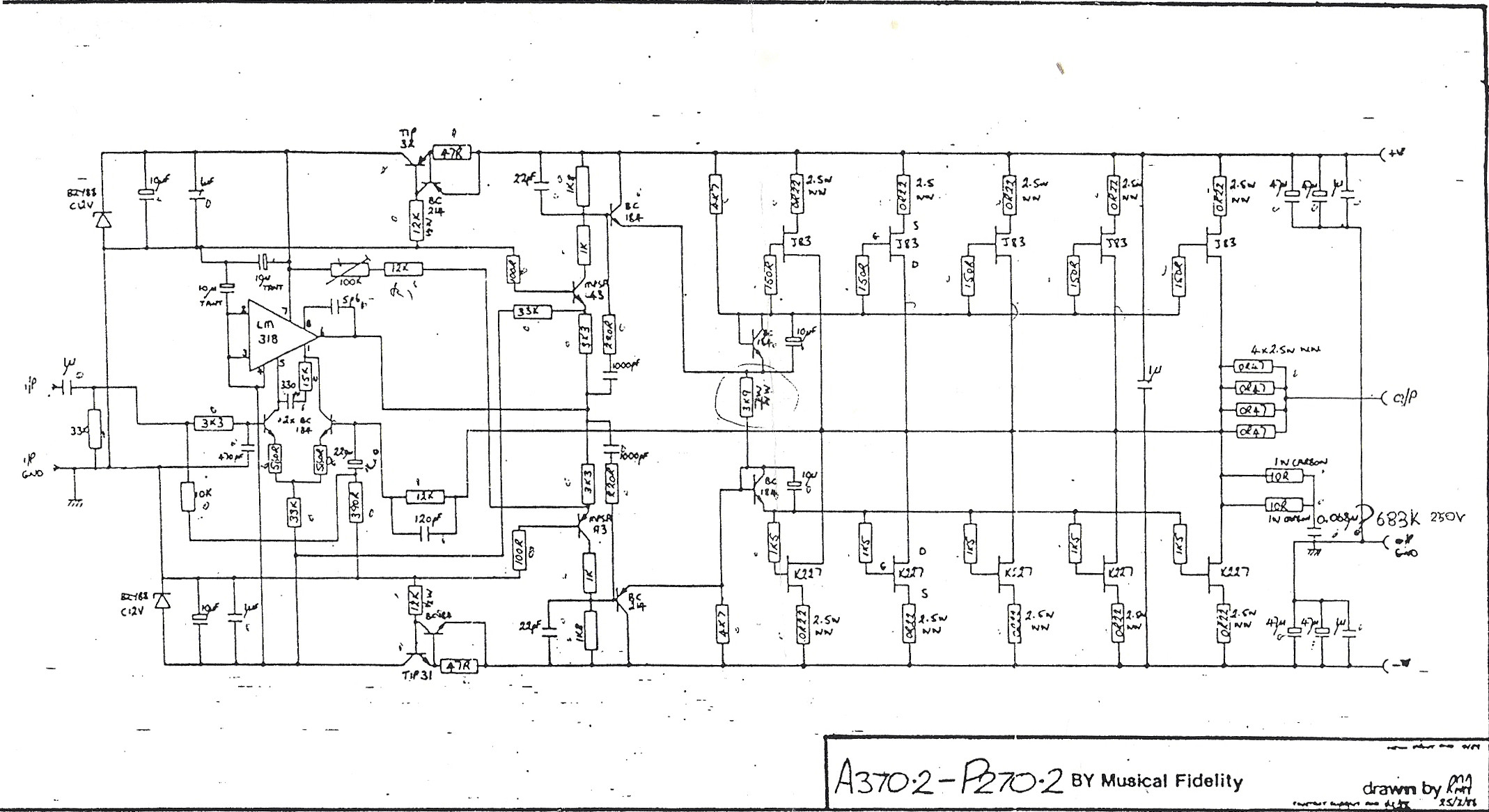

This has been done (using BJTs) by Musical Fidelity on later versions of A/P-270 and on some preamps

OK. I see a little better what you are doing. If I understand it correctly, you are bringing the signal in at the compensation pins (1 and 5). I've never seen that done.
From the 318 datasheet, pins a and 5 are directly connected to the output of the input stage. With your input to pins 2 and 3 being equal, the output of the input stage should be zero. Your external jfet input stage has gain and so does the 318 input stage. When those two signal pairs are connected to each other, I don't know what would happen. Again, not being a circuit design guy, I worry that the jfet input stage is controlled by feedback, so it's gain would be 30 and the input stage about 100. I'm not sure what the output stage would see.
Honestly, I think it would be cleaner to either use a jfet voltage stage without an opamp or use a jfet opamp.

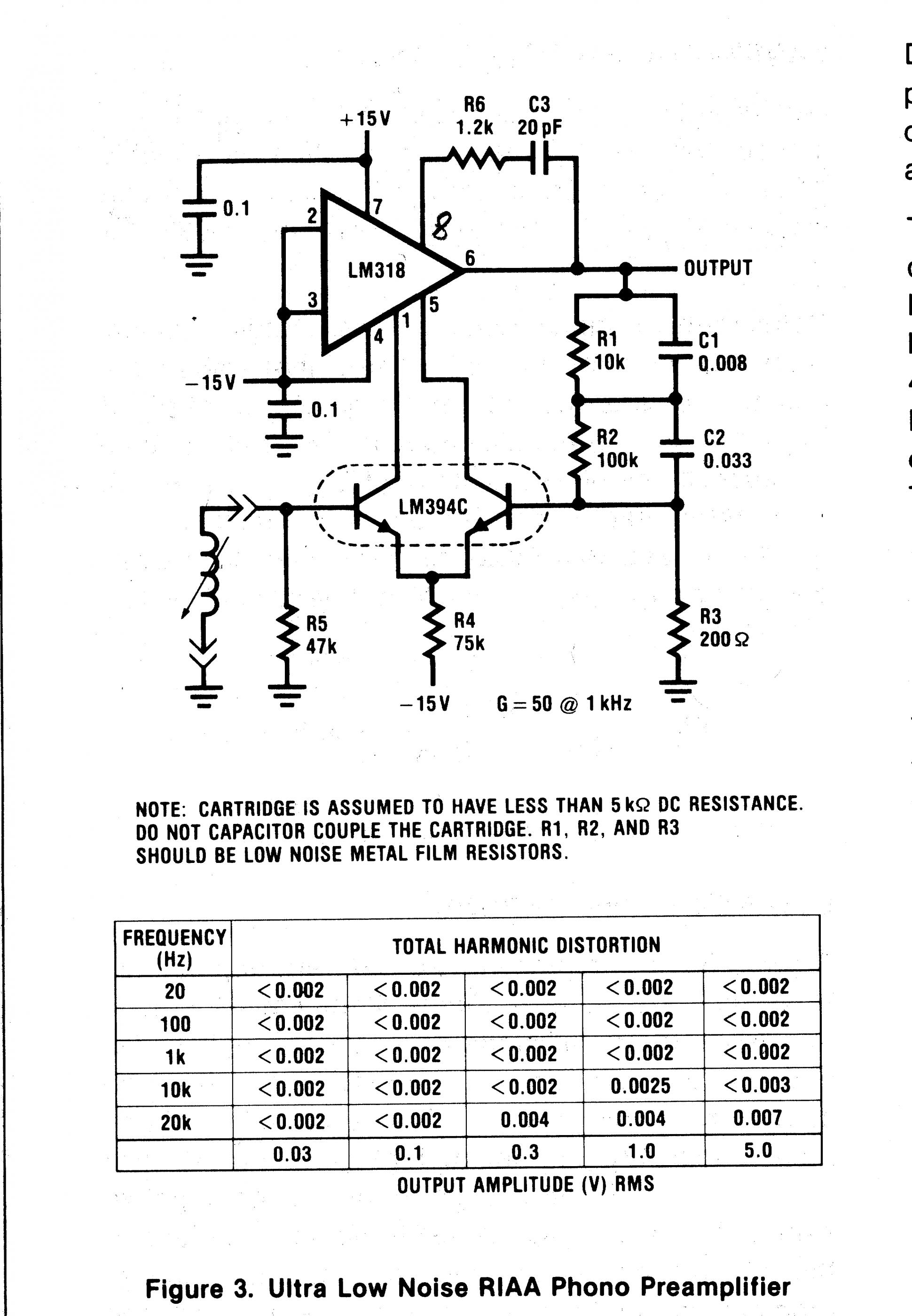

The replacing of the internal input stages of LM318 has been introduced by Carl T. Nelson in July1979 in the National Semiconductor AN-222 Super Matched Bipolar Transistor Pair Sets New Standard for Drift and Noise" obtaining straordinary results in distorsion and noise. In my opinion, this is a promising way to follow.
Fascinating! Very similar to Dario's proposal and exactly the same input method. I would have thought the two input stages would interact, but it seems it's OK.

In general you're right but I like the idea on following Musical Fidelity (which inspired Penasa) path with these amps.
And, while on different circuit, I didn't find a JFET opamp that give me same emotions of the LM318.

The replacing of the internal input stages of LM318 has been introduced by Carl T. Nelson in July1979 in the National Semiconductor AN-222 Super Matched Bipolar Transistor Pair Sets New Standard for Drift and Noise" obtaining straordinary results in distorsion and noise. In my opinion, this is a promising way to follow. View attachment 673335
Thanks for the reference, I knew it existed but never managed to find it
One thought, Dario. I remember reading somewhere a comment from SY that using a constant current source rather than a resistor tail in a long tail pair is preferred and easy. In the Impasse pre that I built, he uses 2 DN2540 depletion mode mosfets and three resistors to provide a very robust constant current.
Jac, the circuit I have posted doesn't use a resistor tail in the LTP but a current mirror (that is a CCS).
Current mirrors are widely used in opamps design.
While it would be going away from the chip/modular/simple elegance of the original implementation, I would think that a discrete op amp may give some gains while maintaining the overall tonal balance of the lm318.
It would be still be modular if one used an available discrete op amp I suppose.
