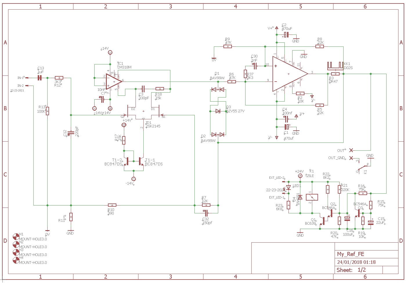

BTW, as an hypothesis, I've also explored other ways to achieve the same result keeping the LM318:
This approach it's not plug'n'play like yours and will need pretty different new boards (much more space is needed), and in this case a second HCPcould be added.
Also a competent engineer will be needed to correctly size the circuit and compensate it, George do you know someone?
I would like this approach best since it would maintain the LM318 loved by Penasa, improve it's performances as Musical Fidelity did in latest versions of the A/P-x70 amplifiers and the resulting amp would have the double pump option... but possibly years of work will be needed.
An afterthought: in this post at #3843, this 'trick' with the swapped out input pair -- had been tested and suggested for transistors.
I stated that it could work even in the configuration shown by Dario.
I feel to make a step back, and say: should be tried.
The problem is: FET's need a much higher bias to provide some gain, and even in that case it is much less gain that with the original input pair, or with the substitute input configurations mentioned.
The problem with higher bias is that still the original chip's internal upper branch current mirrors are used; those are the ones which must handle this higher current flowing, and it's not given at all that they are tuned OK for it.
That is, usually 2mA for the input pair - in a chip - is a lot; on the other hand at **1mA 'only' input FET's are not at their maximum capability.. (**each FET sees only the half of the bias current)
(2mA the bias that Dario had configured; 200uA the bias in the article; 300uA the bias in the A270/370...)

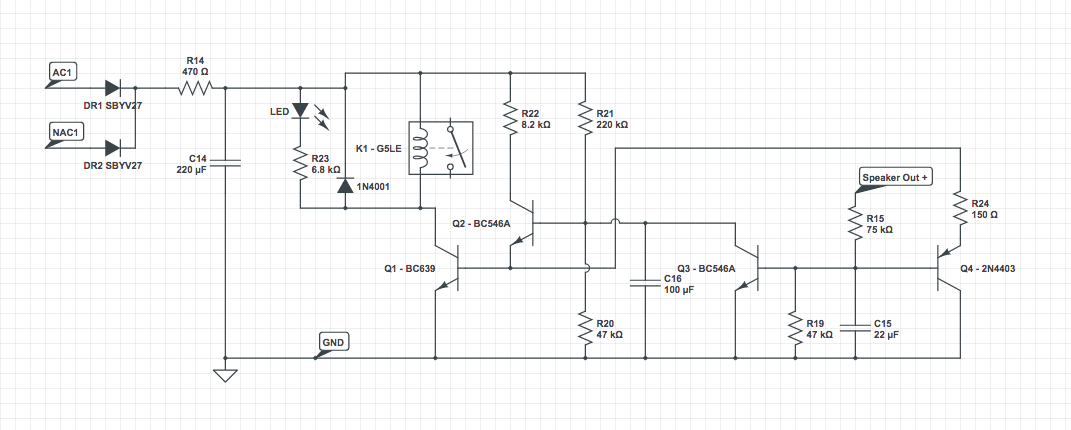

Speaker Protection from DC
My recent experience with DC offset has reminded me that the speaker protection circuit requires a fair bit of DC to open the relay. I found the relay typically opening at about +5VDC with my DC offset boards. In my opinion, this is on the high side and I would like the speaker to be protected from about +/-2 VDC. What do you guys think is an appropriate level?
I think 1V.
Jac,
I think it was a play of balance, from Mauro.
Probably the dynamic behaviour with music contents was the determining factor.
You could experiment: replace the 10k component in each branch divider ( 75k/ 10k) . 22k and finally 33k.
33k would give a static 2,2V limit.
You could decide if it is still stable at high level dynamic music peaks..
Ciao, George

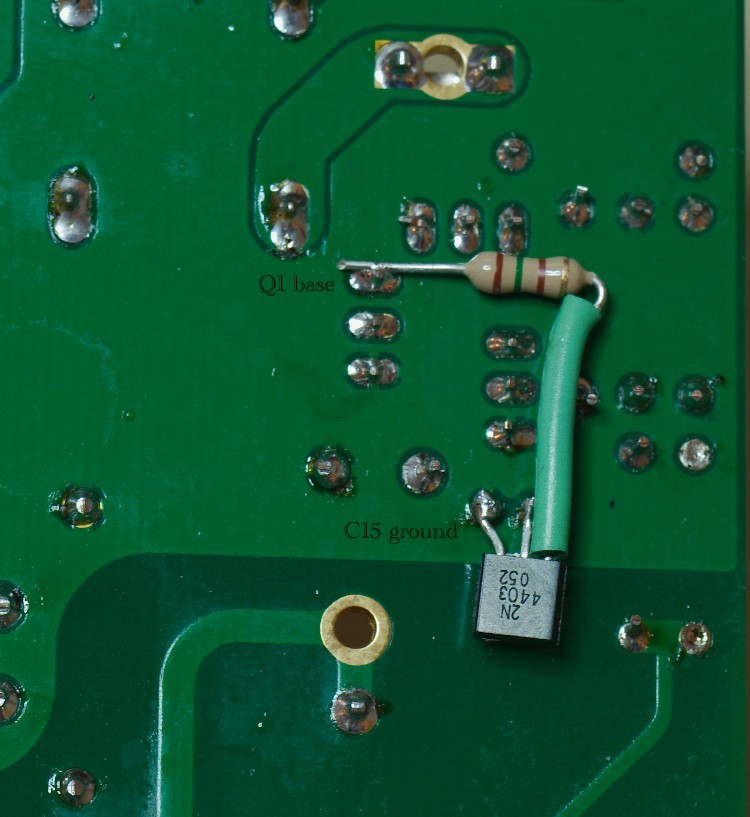

Actually, I have played with this (see post 451, page 46) and have been using a small circuit modification since 2013 (test boards) and for about a year on 2 more pair, all without problems. What bugs me the most is that a negative DC voltage isn't actively switched. Well, sort of.
The circuit diagram below shows what I have been using. As shown, it opens the relay at +1.5/-1.7VDC, but of course, this can be easily and independently changed. Note that I used a 2N4403 as a PNP in the Q4 position, but most any PNP could be used.
I would like to see some change to the BOM or the circuit to improve this.
Great! I'm happy this circuit is starting to intrigue you
It's for this exact reason that I need your help
Values on schematic, though, are just placeholders... never made any calculation/sizing on it...
Nevertheless you're perfectly right, the needed bias for a jfet LTP would be around 2-3mA as we can see in this other example:
Ref: https://www.edn.com/Home/PrintView?contentItemId=4419861
I didn't consider that the LM318 internal CCS would have been still in function and possibly overloaded... this could be a problem that with BJTs as used in AN222 is not relevant.
