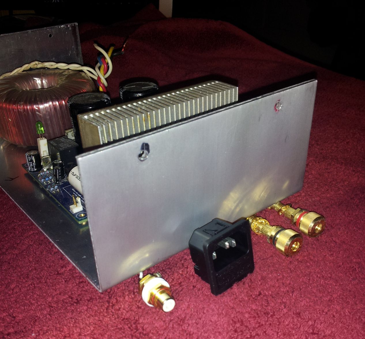

Remember this....
Well, it turned into this by the time it got to Denver.
The cause was flying transformers. The straps and the wooden wedges broke and the tranis were free to fly as they might.
Jim T. sent back the mess along with this advice: "The best way to check your packaging is to hold it above your head and drop it on the floor." :D I took up the challenge.

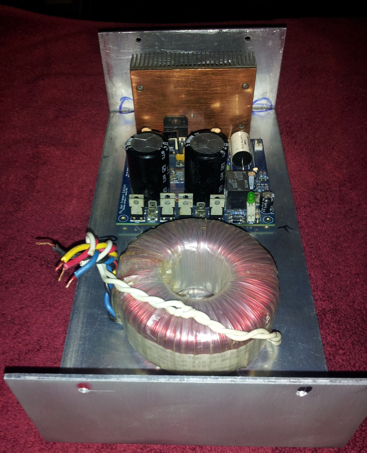

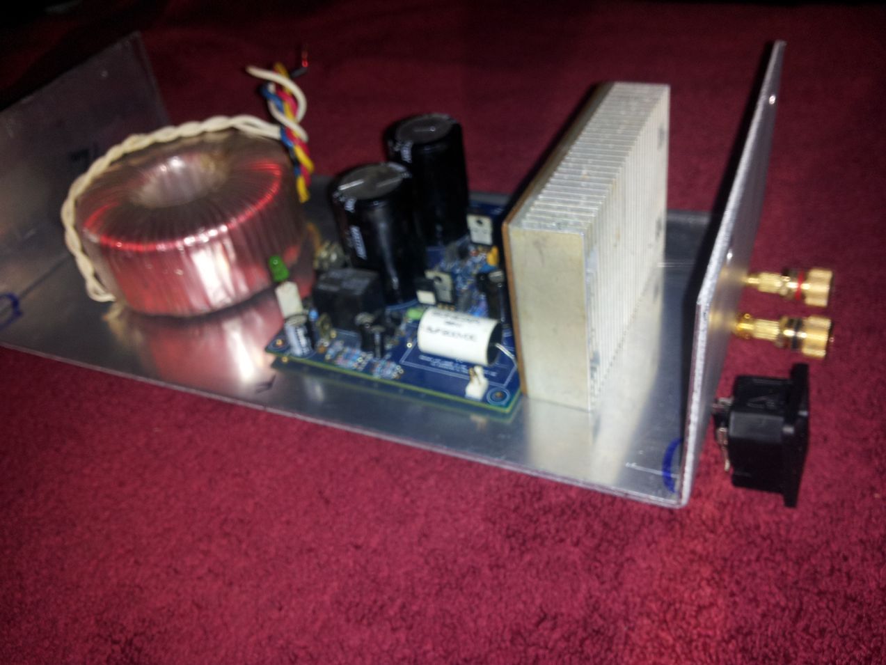

I'm still going to do the original super compact design in all metal , but I decided to make wide monoblocks just to do something different. To hold the transformer in place I used a piece of 5/16" NC-18 threaded rod, a chunk of round stock and three 3/4" long 8-32 wide head screws from the bottom. The threads are continuous through the puck and into the floor. All the panels are 1/8" Alu, the spanners are solid and the rest of the screws are 6-32 steel (aluminum screws cost a fortune). Let's see that come apart.:grumpy:
The traditional arrangement for a chassis this size and shape is front to back. I wanted to keep the signal leads as short as possible and this setup did the trick. The heatsink is a piece of leftovers from Heatsinks USA. I did't do an air flow cut-out on the top yet primarily for aesthetics. With all the aluminum pieces bolted together I'm hoping I won't have to.
The LED leads are pieces of tiny copper tube and heatshrink tubing. Signal leads are hard wired, but the placement allows for easy removal if necessary.
In the end, only the LM3886s had to be replaced - the cap that appeared split was only forced out of the pads. A stud that is seated through the entire web of the heatsink is used to fasten the LM3886 with a 6/32 nut. That also eliminates the struggle to fit a screwdriver between the AG caps and over the top of R3 and it's HS.
Lots more work to do in an attempt to get a good brushed aluminum finish (tips and techniques welcomed), but that will wait till after the Post Office gets another chance to do it's "Handle With Care" trick!! :cuss: I haven't done the 6L6 overhead test yet, but chances of survival appear significantly better. :rolleyes:
Both amps sound great and special props go to Dario for developing a super strong board. Not a single crack or pulled pad on either board. :worship:
