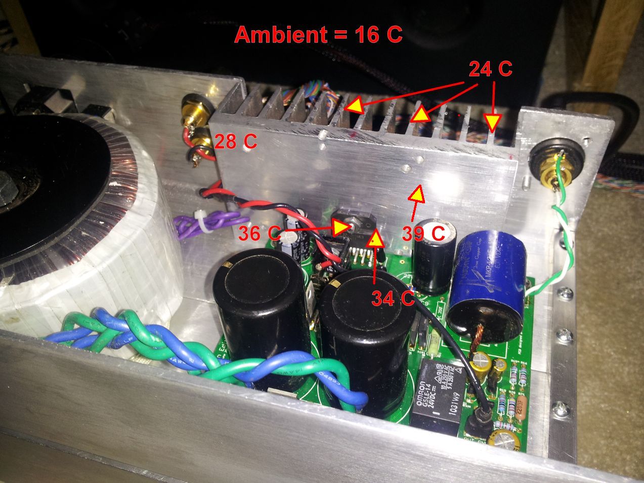

FWIW: Here are the heat readings taken after an hour with big music (M. LeGrand Big Band & Shostakovitch Sym #9) pushing the FSs at a fairly high level. Case is warm ~ 24 C, but nowhere near hot. Vent holes won't be necessary.
The 39 C is an anomaly - it's like a little black hole that is sucking in heat. Gonna have to watch more Discovery Channel.

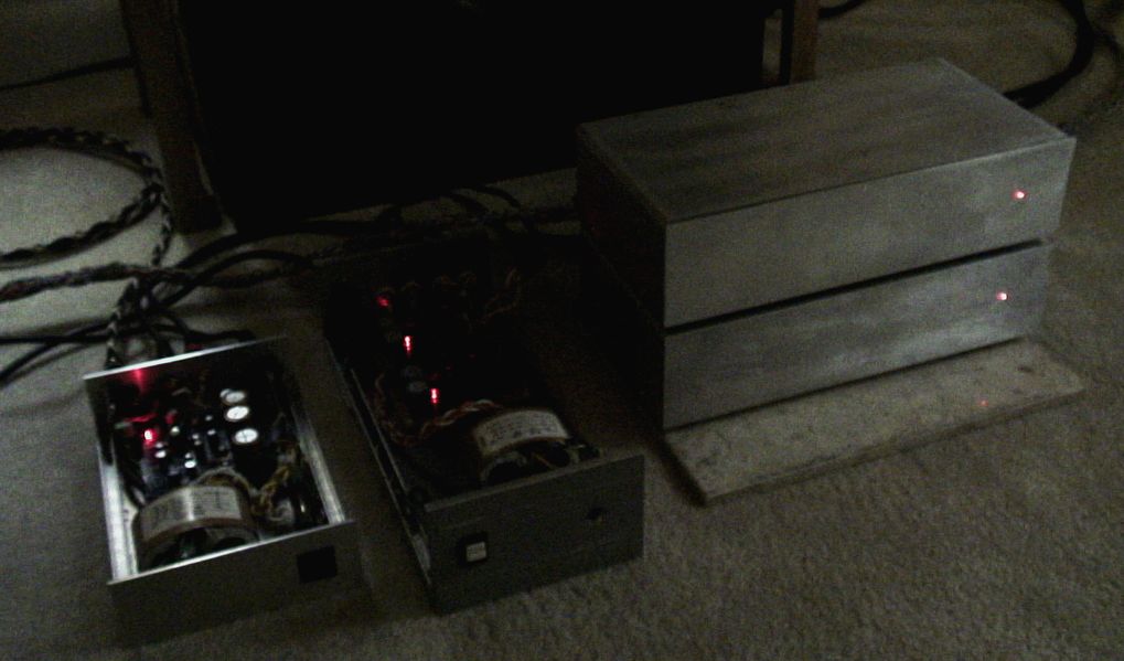

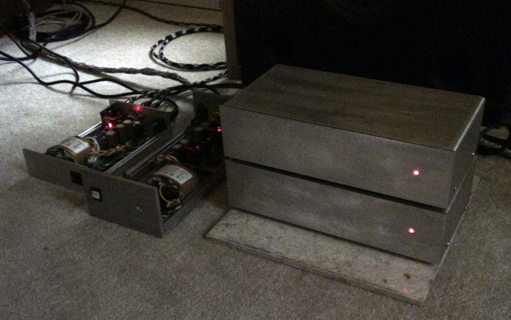

Added the highly anticipated "Night Shots"

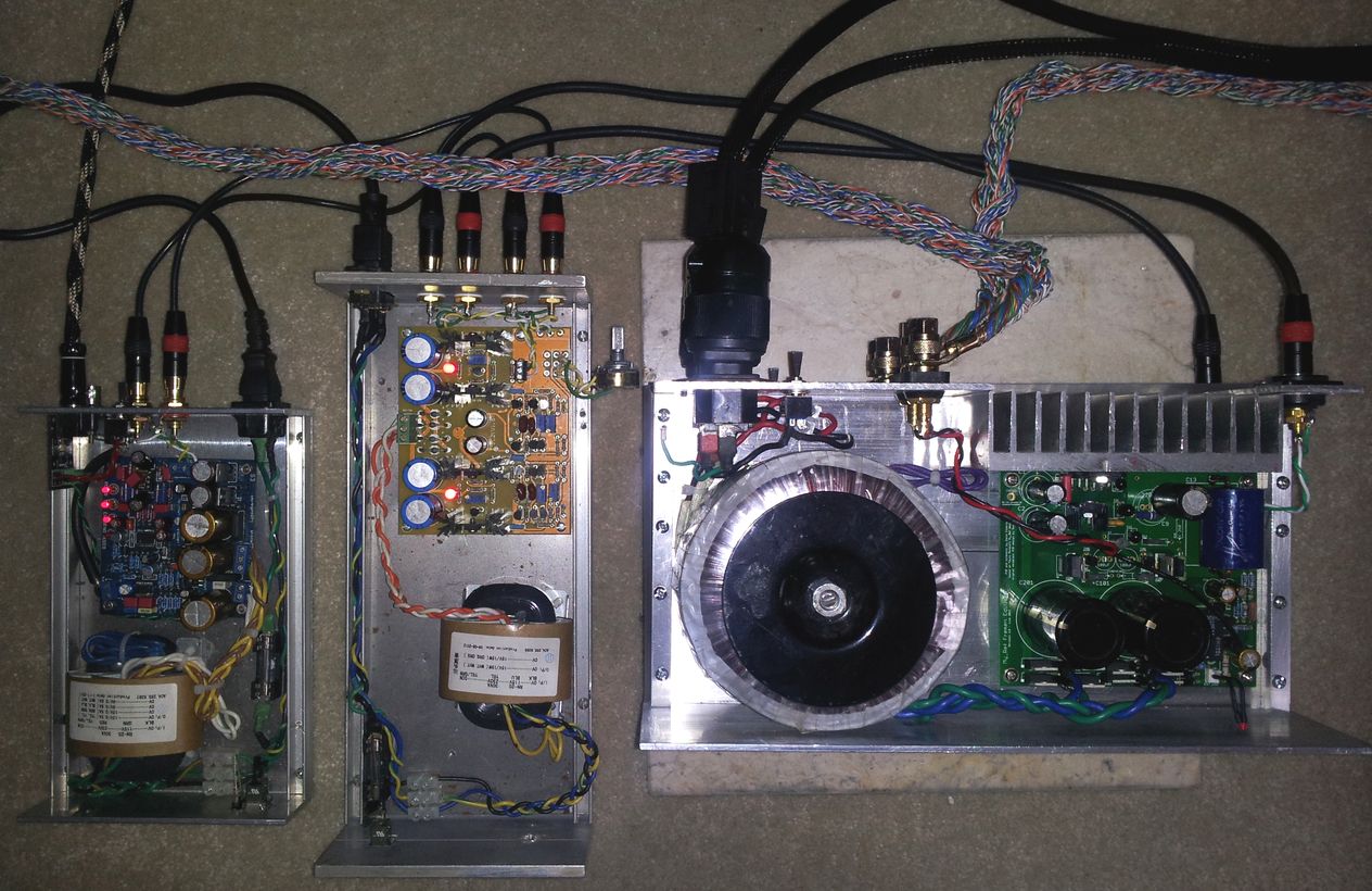

A couple more inside pictures, both amps are identical.
I tried moving wires around and even disconnected the transformers screen but no use. The biggest improvement to the hum came when i changed the digital coax lead from my V-LINK to DAC to an optical one, still getting hum but not quite as loud. When i turn the volume up it gets really quite loud. Any suggestions folks?

For your encouragement, here is a shot of my current configuration. It is hum free but it took a long time to determine the hum was from bad continuity at the FE PCB entry point - and a defective RCA socket. At some point I was convinced the problem was the DAC and/or the Pre, but simply wiggling wires identified the glitch. Hang in there!!
BTW; Shoom, I left the trani shields unconnected this time. Don't think I ever tried connecting them directly to the mains inlet ground tab. I'll give it a shot.
Connect them to the point the AC Mains attaches to the chassis. Not directly to the ground lug of the IEC socket.
(I think that's what you were saying, but I wanted to clarify.)
