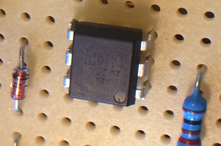

Question on picking 4N35 optocoupler
Hopefully I did not mess up, just getting ready to solder in the optocoupler and was looking close at the picture in Teabag's blog to make sure I oriented them properly and noticed a difference between his and mine.
Tea's, like mine have printing on the top , 4N35, with V 33924 inscribed underneath. Looking with a magnifier, I noticed mine said 4N35 as well, but the inscription underneath was V 32724.
mine is this part:
4N35 Vishay Semiconductors | Mouser
There a a few variations, so I looked at the specs. A few are SMD type, but several are DIP 6 type. Most of the specs are similar, most having a power dissipation of 150mW, but the one I chose, first on the list has a dissipation of 70 mW. There were a few other minor variations as well.
Is this part sufficient? Or should I have selected one of the others? I was just about to solder them in when I noticed this and thought I better check!
Thanks for your thoughts on this. I should be able to finish wiring tomorrow.

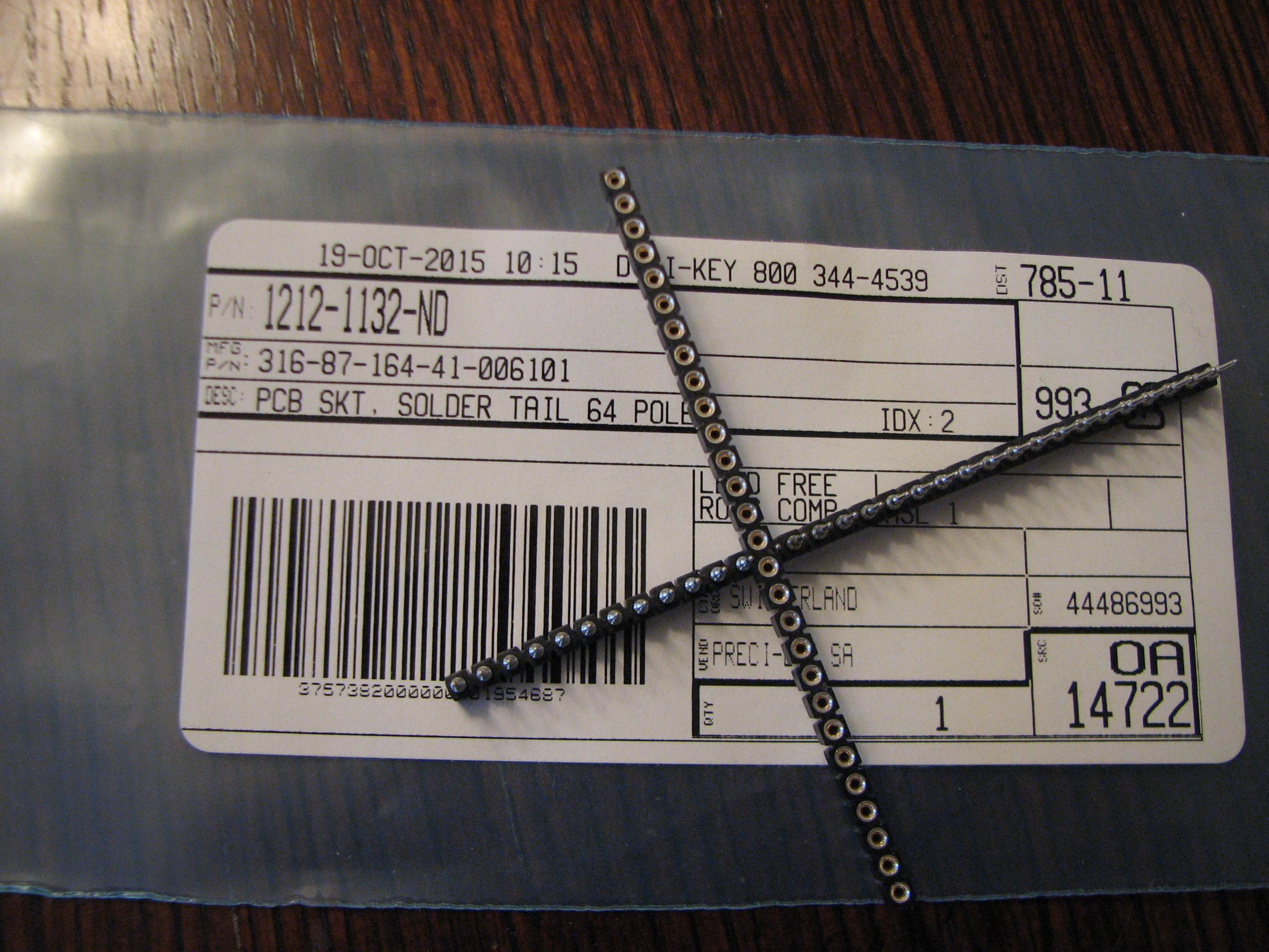

I thought of leaving long leads as well, I also have some of these little sockets I thought I might use in those locations:
You just snap off what you want, 1, 2, whatever and solder in the hole.
