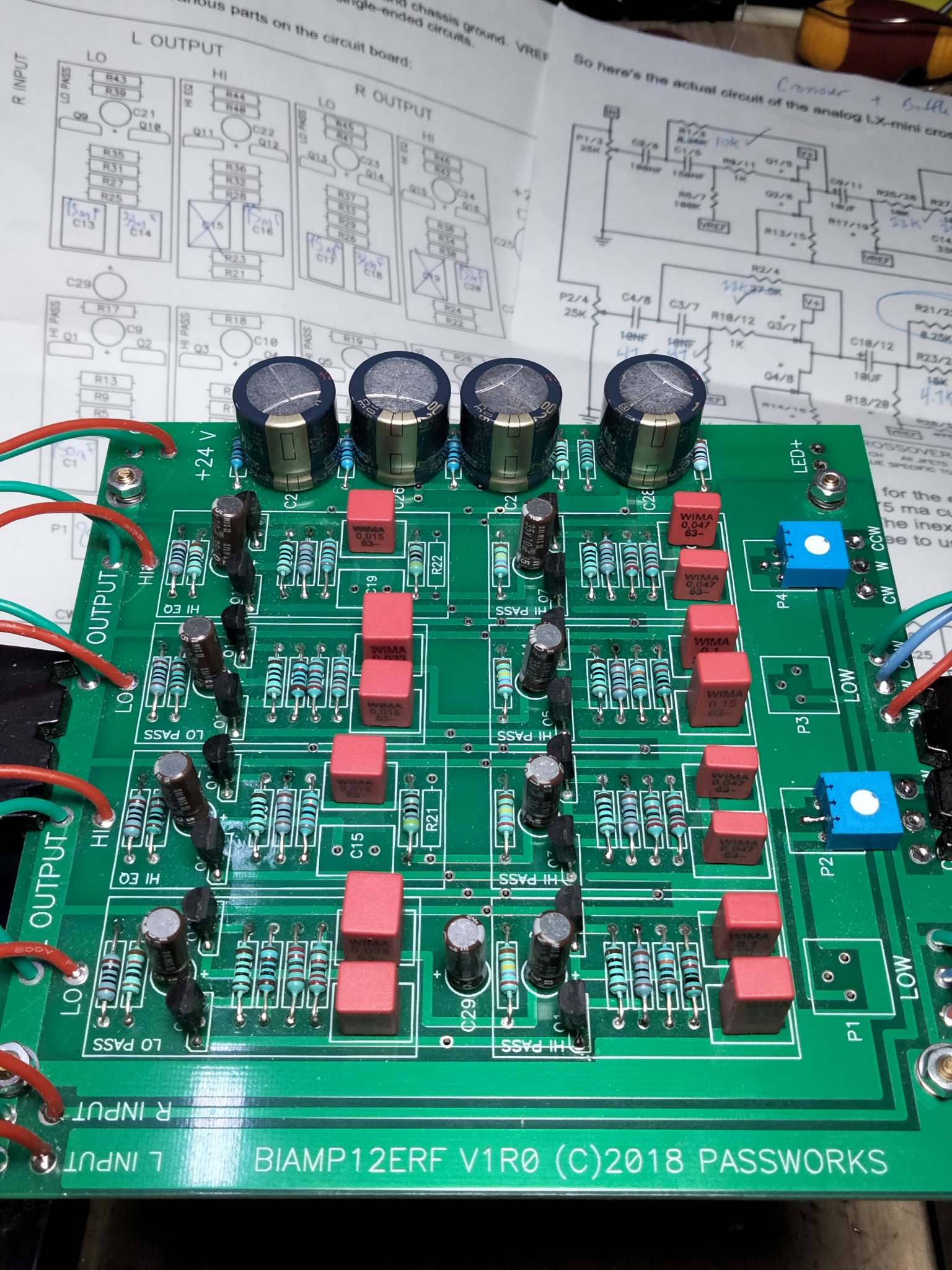

This is an old post, I realize, but I have a question. From the curves your posted, and from my own simulation, the values above give an EQ boost centered at about 35Hz, but the original SLOB has it at 20Hz. Am I misreading this, or is there some other explanation? Thx.Here's the info on my ACN/LX Mini set up for Papa's SLOB.
I've attached two documents- (no idea why they are upside down- saved correctly.)
1. The ACN crossover schematic with updated values hand written.
2. The file of the crossover slope with updated values on the right, but it is not a complete schematic. Use the complete schematic with the hand written values.
Schematic changes from original values-
For the low pass-
R1/3 to 10K ohm
R25/26 to 22K ohm
R27/29 to 22K ohm
For the High Pass-
C4/8 to 47NF
C3/7 to 47NF
R2/4 to 22K ohm
R6/8 to 22K ohm
C15/19 removed/left open
C16/20 to 15NF
R23/24 to 4.7K ohm
R28/30 to 8.2K ohm
R32/34 to 1K ohm
The crossover calculations were done by another member- Ylab. He and I had a bit of back and forth and the values posted are what he proposed and I followed. I have not run them through the simulator. I just updated the values on my ACN board and listened.This is an old post, I realize, but I have a question. From the curves your posted, and from my own simulation, the values above give an EQ boost centered at about 35Hz, but the original SLOB has it at 20Hz. Am I misreading this, or is there some other explanation? Thx.
Ylab did say, much like Papa, that each person should experiment with different values for the resistors and caps to get a sound they like. I was happy with the performance when I followed his updates and I haven't made any changes. I think the values are a good starting point but by no means should be the end all, be all.
I posted the info figuring there were others like me who are a bit challenged when calculating crossover values.
