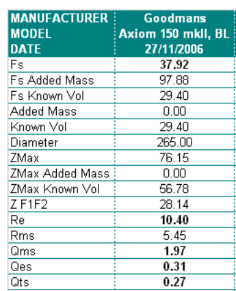

The Definimax has a QTS of 0.5
From Soundhappy's link @Eminence website:
"As a general guideline, Qts of 0.4 or below indicates a transducer well suited to a vented enclosure. Qts between 0.4 and 0.7 indicates suitability for a sealed enclosure. Qts of 0.7 or above indicates suitability for free-air or infinite baffle applications."

I get the general rules of thumb you mention, however, and in retrospect I didn't put this very well, I was questioning if the SLOB is a different use case where those rules of thumb don't work as well - when looking for alternative bass drivers to the Definimax, do we know what the important parameters are in the the SLOB context?

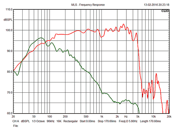

Also Troels Gravesen (that has a completely different audio philosophy) abandoned hi Qts driver for low with powerful magnets in OB. Here Faital 15PR400 with a Qts of 0.33 in OB with passive eq:
OBL-15

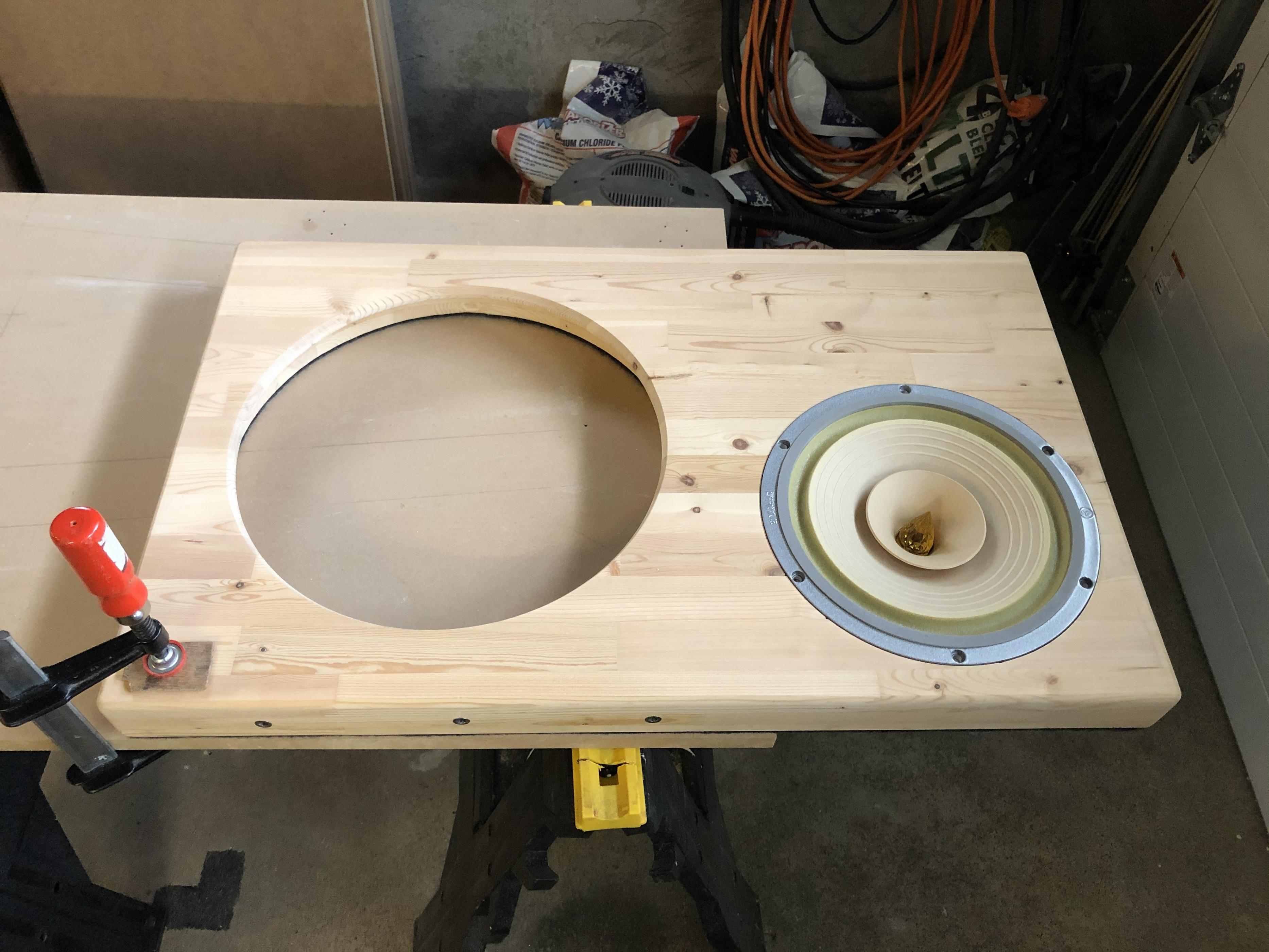

I’m just about done reworking some baffles I made a while ago to fit a pair of the Lii Crystal 10 drivers in.
The woofers will be AE Dipole 15 driven by Hypex amps.
I am think the one AE 15 will do the job, if not, I will add a slot chamber below with an AE Dipole 18.
