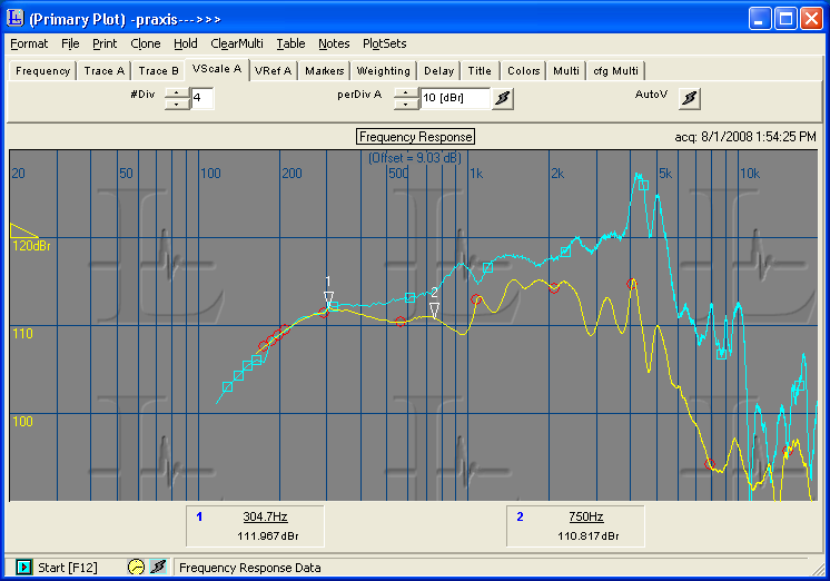

Removing the dust cap on the Flat 8's kills the response above about 8Khz - it falls by many dB. A large portion if not the majority of the treble is radiating from the dust cap, so frivolously cutting it out completely changes the treble response.

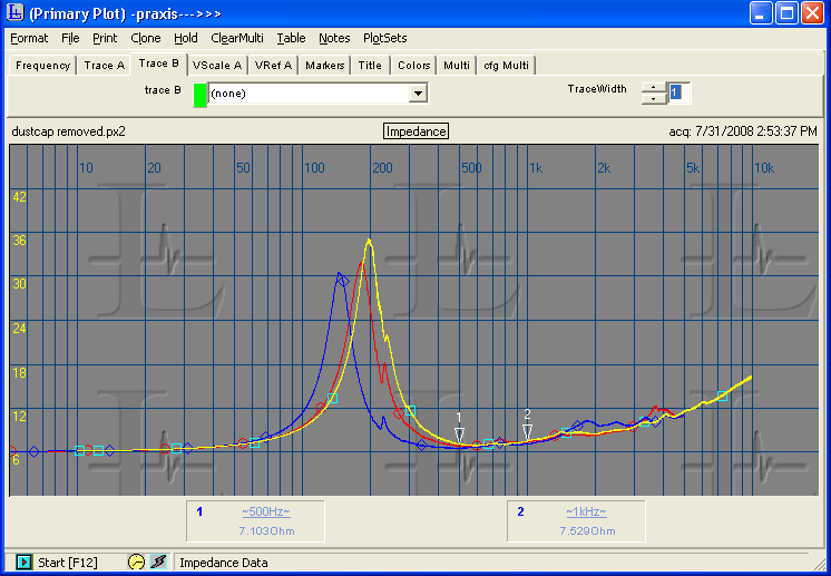

The blips I've seen in impedance curves are more typically from the surround resonance, one of the lowest frequency resonances. I can't recall anything related to a back chamber Helmholtz resonance. If such a resonance exists I wouldn't worry about it varying with frequency but would just treat it. Many drivers have either venting through the pole or damping under the dustcap to deal with cavity resonances.
On the frequency response this shows up as a whole series of small but significant "ripples" which look like comb filtering which gradually start to appear from about 8Khz up which "slide" up and down in frequency with the cone position - you can see it clearly change with a real time FR analyzer when deflecting the cone with a DC bias. (It doesn't show up on the impedance curve though)
I assume that they only show up in the response at higher frequencies even though the fundamental cavity resonance is lower because only at the treble frequencies is the dome the majority contributor of the radiation of the driver. At lower treble / upper midrange frequencies although the resonance modulation of the cavity behind the dust cap is still occurring the dust cap is a rather small proportion of the total radiation area and is thus swamped by the response from the rest of the cone...

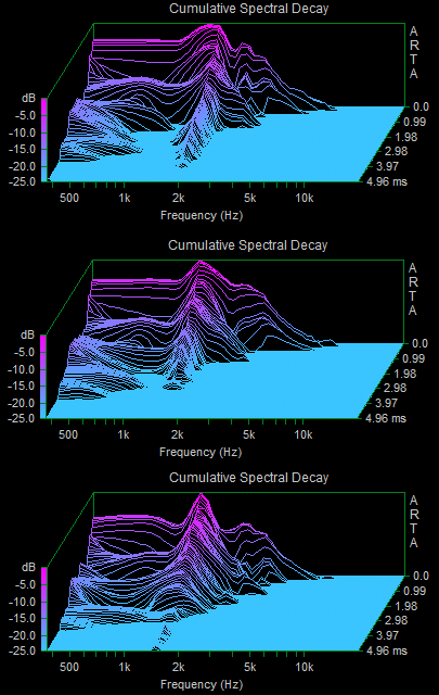

Didn't notice this at first, but something is very screwy with your CSD graph - 79ms on the time axis ?CSD is before and after.
If you really did use a 79ms gate time you'll be collecting a ton of room reflections, so most of that decay will be room reverberation decay not the drivers own decay response, which should typically be at least ~25dB down in under 2ms.
Your CSD graphs also look very different to mine graphically even though I use ARTA as well. Old version of ARTA perhaps ?
Thanks DBMandrake. I was attempting to extract off axis information from the on axis measurements, but I didn't mean to post them that way. Allow me to try again
First and second are before picking up the razor and after adding the plug. The third is without the dustcap.

There is an across the board 3 to 4 dB sensitivity drop. If the mass you previously added was removed (as shown in your impedance curves) and the area loss doesn't account for it then what is the difference? You can't claim that the dust cap resonances caused an across the board sensitivity difference, it just doesn't work that way. I also note that the measuring windows are different (fine fuzz on the cyan curve indicates a long measuring window). Plus a periodic wiggle around 1 k for the yellow curve indicates a strong reflection in the measurement not present in the other case. There are similarities in the dual peaks at 4.3 and 5 kHz, suggesting the same woofers but the other differences are too great for the changes you suggest.

Not to be obtuse but I'm still not following your woofer comparison. They appear to be very different woofers measured under different circumstances.
I'm not sure what you aren't understanding here. This is the same woofer, measured on the same baffle with same windows. Measurements are taken one after another. Yes, the loss of area on a small 6.5" or 7" driver will cut some efficiency slightly. The breakup of the dustcap itself is not the only issue as I mentioned. The standard cone may have one major resonance. As you put a dustcap on you are attaching mass at another point. You now have 3 unique resonances. The area of the VC to dustcap, dustcap to outer edge, and dustcap itself. These all contribute. The additional efficiency difference may very well be from the loss of about 7% of the area.
It's clear that there is more of a wide band issue and not just at one point. The red curve shows a peak in the impedance curve that starts at about 3KHz and ends at about 5KHz. While it's typical to have small bumps, look at the magnitude of this one! Then look at the dark blue impedance curve. With a little mass added on the dustcap there is now an affect from 1500hz to over 4KHz. You can clearly see 3 distinct bumps indicating there very well may be 3 resonances that are all contributing.
A point on woofer peaks. Although most people assume that HF woofer peaks must come from the woofer center, most modal analysis shows that strong upper modes come from activity around the woofer cone's perimeter. Removing (or adding) a dustcap can be enough of a change to modify the output, but this does not indicate that the effect was purely happening on the dustcap (as evidenced by the 4.3 and 5k peaks still being there for both curves). At the same time your premise was that a strong resonance existed in the volume under the dustcap, the primary impetus for removing it. I'm still not seeing any evidence of that.
Correct that there are many causes and they don't all come from the center. The issues are often at the perimeter. Putting a dustcap towards the center has little to no effect on this. It will lower the distance from the perimeter to the first solid glue joint and often push the resonance higher in frequency as a result. Damping a resonance at the perimeter should be done at the perimeter. Various surround materials can make a difference. I always coat the back side of the paper cones where it attaches to the surround. This also makes a big difference.
In this case though, the 4.3K peak has dropped by 10dB and the 5K peak by nearly 15dB. The bump at 8K is gone and the 10k bump also decreased by 15dB. IMO this is a positive effect. The fact that adding mass to the dustcap itself shifted this resonance by an octave and broadened it so significantly indicates a dustcap issue. This wasn't the only testing done on this driver either. I added mass at many points around the cone itself. I added a felt ring around the ID of the surround. Neither had any affect on the large peak.

Your measurements don't back this up. The primary top end resonances you show in your measurements (4.3 and 5 kHz) are there both with and without the dustcap. They must be cone resonances. The only way I can think of to prove your assertion would be to measure frequency response with the woofer in different static positions, say when shifted with DC offset.
In the absence of that, I'd say the variable resonance argument is a straw man. As pointed out by others, any under dustcap resonance (if it was detectable) could be easily damped with an absorptive plug, or removed with a vented core pole.
There are further errors in your measurements. 1 (or 2 or 3) resonances can only raise level at their peaks and slightly in their skirts. Resonances will not cause a broadband efficiency change, yet your woofer curves show a 3 to 4 dB (and rising) response difference over multiple Octaves. Something else is going on. You mentioned felt rings, damping compound, and such. Were they still in place? The differences look more like considerable added mass, raised inductance (yes, unlikely) or a measurement from further off-axis. Other questionable differences between the curves are a different resolution ("fuzz" on the "dustcap" curve implies a longer measuring window, a regular periodic wiggle in the "no dustcap" case indicates a significant reflection in the measurement window). These are not comparable curves. They do not reflect the typical difference between a woofer with and without its dustcap, and they do not provide proof of any resonance under the dustcap.
I'm also not buying your assumptions about narrow air paths being silent. Adding flow resistance doesn't mean that air flow stops. For the most part a narrower path will increase velocity and make air noise worse. An absurd case would be to compare a small leak in a box (with attendant high air noise) to a vented box. Considerably more air can flow through the vent with no air noise at all. One of the most bizare cases of woofer noise that I've run across was a woven fiberglass cone with poor sealing. The minute holes in the cone mesh made a noise that sounded identical to crossover notch distortion and wouldn't go away until every last hole was sealed. High flow resistance did not stop the flow.
I'm not saying that you haven't cured all the potential problems of no dust cap with your woofer designs, just that the issues are there and the pitfalls, in my opinion, outway any possible benefits.

To throw in my rather simplistic tests of a driver that has an extended dust cap, not a phase plug, it was surprising how small changes to cone and also directly to the dust cap improved the response. This dust cap is actually integral part of the cone (it's a cheap driver), but may add to the discussion.
As you mentioned John, the first thing to do may be to add damping to the surround if that resonance exists. A common treatment, but it does not seem to work well for soft cones that I've tested. That's the first thing I did to the driver tests shown here. It has not been a benefit on hard cones in my limited testing.
Blue - Untreated driver
Yellow - 3 coats of "The Wet Look" on the surround
Notice that practically all resonances were modified in one way or another.
The final configuration when I stopped testing did use damping on the dust cap. Much more than this quickly became detrimental.
Yellow - 3 coats of "The Wet Look" on the surround and with damping "dots" shown
I did not make impedance measurement changes with the testing.
![surround_app_only.jpg](https://www.speakerdesign.net/midrange_tweaks/kef/f15/pics/surround_app_only.jpg)
![new_app1_app3.gif](https://www.speakerdesign.net/midrange_tweaks/kef/f15/graphs/new_app1_app3.gif)
![final_config_2b_adj.jpg](https://www.speakerdesign.net/midrange_tweaks/kef/f15/pics/final_config_2b_adj.jpg)
![final2_vs_untreated.gif](https://www.speakerdesign.net/midrange_tweaks/kef/f15/graphs/final2_vs_untreated.gif)
