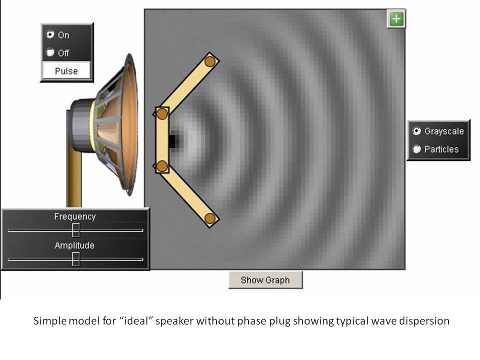

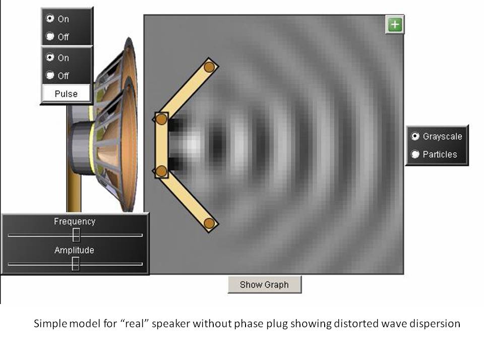

A few wave simulations from one phase plug web document are attached.

If these simulations are real then the phase plug actually makes things worse (in my view). To bad, because the SEAS Excel Magnesium drive with it's copper coloured phase plug is a very beautiful driver (in looks).
How so? It looks worse near the phase plug, but in "far-field" it seems quite a bit more uniform.If these simulations are real then the phase plug actually makes things worse (in my view). To bad, because the SEAS Excel Magnesium drive with it's copper coloured phase plug is a very beautiful driver (in looks).
I think this is the idea behind the simulation.
The wave simulation of the "real" speaker without the phase plug shows a dark shadow on axis of interference representing lobbing. The wave simulation of the "real" speaker with the phase plug shows less interference lobbing.
The multiple point sources on a speaker cone can cause lobbing effects. The power is radiated in a very small angle. With a phase plug one side of the cone is "separated” from the other side. There is no lobbing or wave cancellation at high frequencies. The phase plug can extend the speaker
response.
