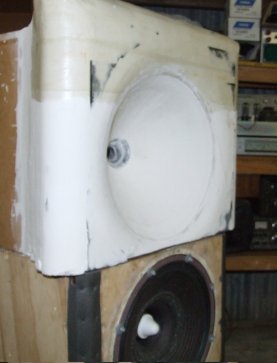

About 10 years or so back I cut the dustcap off 15" drivers which I intended using up to 1200Hz.
I cut away the dustcaps and used a spice container which was made from a cardboard tube, and had a steel bottom plate so it attached to the magnet. Here's another shot...
There was no problem with chuffing. In fact, there wasn't much gained from the phase plug at all. I did get results from that ring of foam weatherstripping you can see about a third of the way out.
