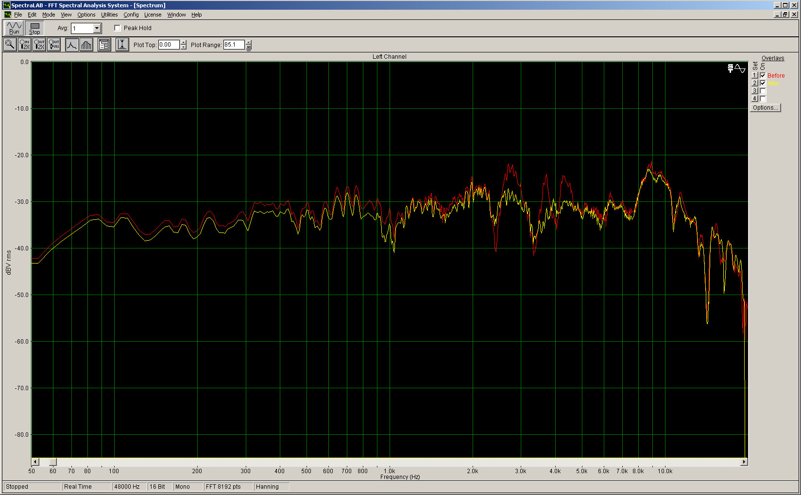

Image 1 is a before/after measurement taken around 2003 with SpectraLab so it's only a slow swept tone measurement, with no gating and is full of room reflections etc. It was also taken with the speaker in it's normal playback position in the room, relatively near walls, mic at about 1 metre.
Red is before, Yellow is after the strips were added. I was very careful that nothing was moved or changed between the two - the driver was unscrewed from the front of the cabinet and taken away to have the strips added, with cabinet, microphone, and measurement system all being left exactly as is, so although the absolute accuracy is poor due to reflections (and uncalibrated mic) the relative change is pretty accurate.
I think the change from 2.5Khz to 5Khz speaks for itself really. The notch at 3.5Khz present both before and after I think in hindsight is a microphone stand reflection, not a real notch in the driver - Image 2 is the same driver measured on the same baffle (but in a different room) 8 years later with ARTA using a 4.2ms gate time and a bit more care and attention to avoiding mic clamp reflections, and the 3.5Khz notch is nowhere to be seen. (I'm not 100% sure if I used the same microphone for the older measurements either - it was around the time I switched mics)
Below 2Khz there is about a 1 dB loss in overall sensitivity due to the approximately 1 gram added mass from the foam strips. In the treble there's no real change in sensitivity since no mass was added to the whizzer cone which along with the dome is dominating the response by about 7Khz.

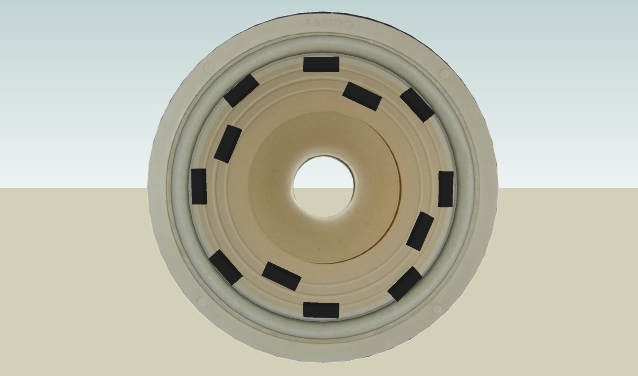

I don't have any good photos of the strip layout, no, because they're largely obscured by the frame of the driver, so a picture from one angle would only ever show a couple of the strips. What I do have though is a Google Sketchup model of the driver I made a while back, so I've hidden the magnet, frame, etc and placed strips on it which give a good idea of their location and proportions.Interesting...do you have some pictures ?
Image 3 is looking at the rear of the cone straight on, don't be confused by what looks like a whizzer cone in the middle, it really is the back of the cone, it's just that I used the same texture image to model the front and rear of the cone, as you don't normally see the middle of the rear of the cone in the completed model with magnet/frame/spider etc in place

I think that the lack of much effect above 5Khz is due to the driver being dual cone.Hi Simon,
Your figure 1 looks like a very useful improvement in the 2 to 5kHz range. Interesting that there was minimal effect above.
The main cone by itself (as measured on another de-whizzered unit) rolls off above about 6-7Khz.
Also looking at the excess phase curve shows excess phase starting to appear just below 4Khz and reaching nearly 180 degrees at 10Khz - the half way point of this shift is around 6Khz, so I assume this means that the accoustic crossover point between the two cones is occurring around 6Khz, and is approximately 2nd order ?
In either case, the whizzer cone and dome are dominating the measured response above 6Khz, so even if the damping were improving the smoothness of the stop-band roll-off of the main cone it wouldn't show up significantly in the summed response. On a single cone driver I'd expect to see an improvement in the smoothness of roll-off with the damping strips in place.

I first started off with 4 strips at 90 degree intervals near the edge of the cone (top/bottom/sides in the diagram) and there was significant improvement but it wasn't enough. I then added another 4 strips in between them at 45 degree intervals, making a total of 8, and this made a big improvement, especially around 3Khz, however it still left quite a big peak at 4Khz.
I then tried adding 2 strips further in opposite each other, then later 4 strips as shown in the diagram, which pulled down the peak at 4Khz a lot. (There is still about a 2dB peak there which I equalize in the network, along with the broad 3dB peak at 2Khz)
(On another pair of similar but different drivers, I only added the 8 strips around the perimeter and found I didn't need the extra 4 further in, and that all they did was put an unwanted dip in the response)
The interesting thing is that I found pairs of 2 strips didn't work very well for me. When going from only the 8 strips around the edge to adding 2 inner strips it reduced the resonance at 4Khz somewhat but it actually added a new low level resonance at another frequency nearby. I forget if it was higher or lower, but despite its low amplitude the newly added resonance had a very long decay time of several ms. It wasn't really noticeable on the frequency response plot, only on a CSD as a low level but long lasting ridge. I think I could just hear it too, on certain music.
Adding 2 more strips to make it a group of 4 spaced at 90 degrees eliminated the spurious new resonance, as well as further reducing the original 4Khz resonance. Staggering 2 of the opposite strips further in by half a block width improved the response at 4Khz slightly more, but if I staggered them any more than that (such as a full block width) the spuriously added low level resonance would return.
It seems that there must be at least 4 blocks equally spaced around the circumference at any given radius where there is a block, although I'm baffled as to why. This is what got me wondering about whether there is a secondary effect going on which is affecting bell modes - maybe the spurious low level resonance is a bell mode, and only adding damping/mass at two 180 degree intervals stimulates (or allows) a particular bell mode, while adding damping/mass at 90 degree intervals (or less) suppresses the same mode.

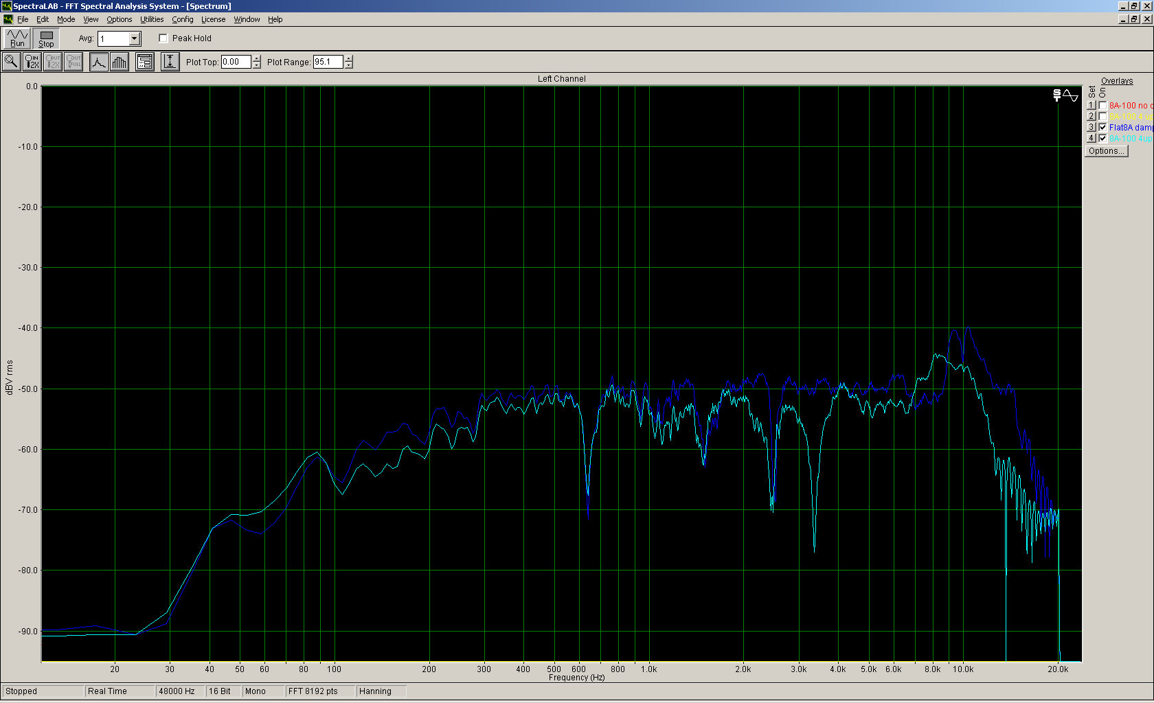

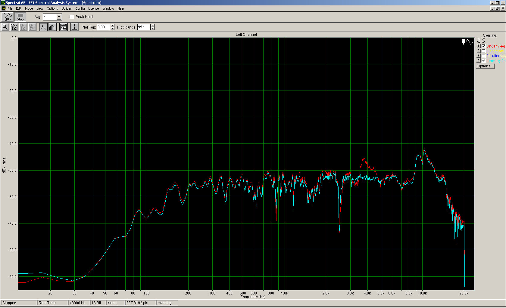

While looking through old measurements I've found some more damping experiments measurements on two different drivers that may be of interest. (Apologies to those only interested in phase plug discussion for derailing the thread again, although I have some on-topic phase plug measurements I can post later as wellHi Simon,
I'd spent many hours in years past playing with doping compunds, cutting slots, etc. The only problem is trying not to do permanent damage on a path that doesn't pan out.
What's interesting about these measurements is that they're from two different yet similar models of driver - to the eye they look like a very similar if not identical design (8" paper dual cone) yet they measure very differently indeed, showing how the largely invisible to the eye materials properties and composition is just as important if not more important than the actual physical geometry of the design.

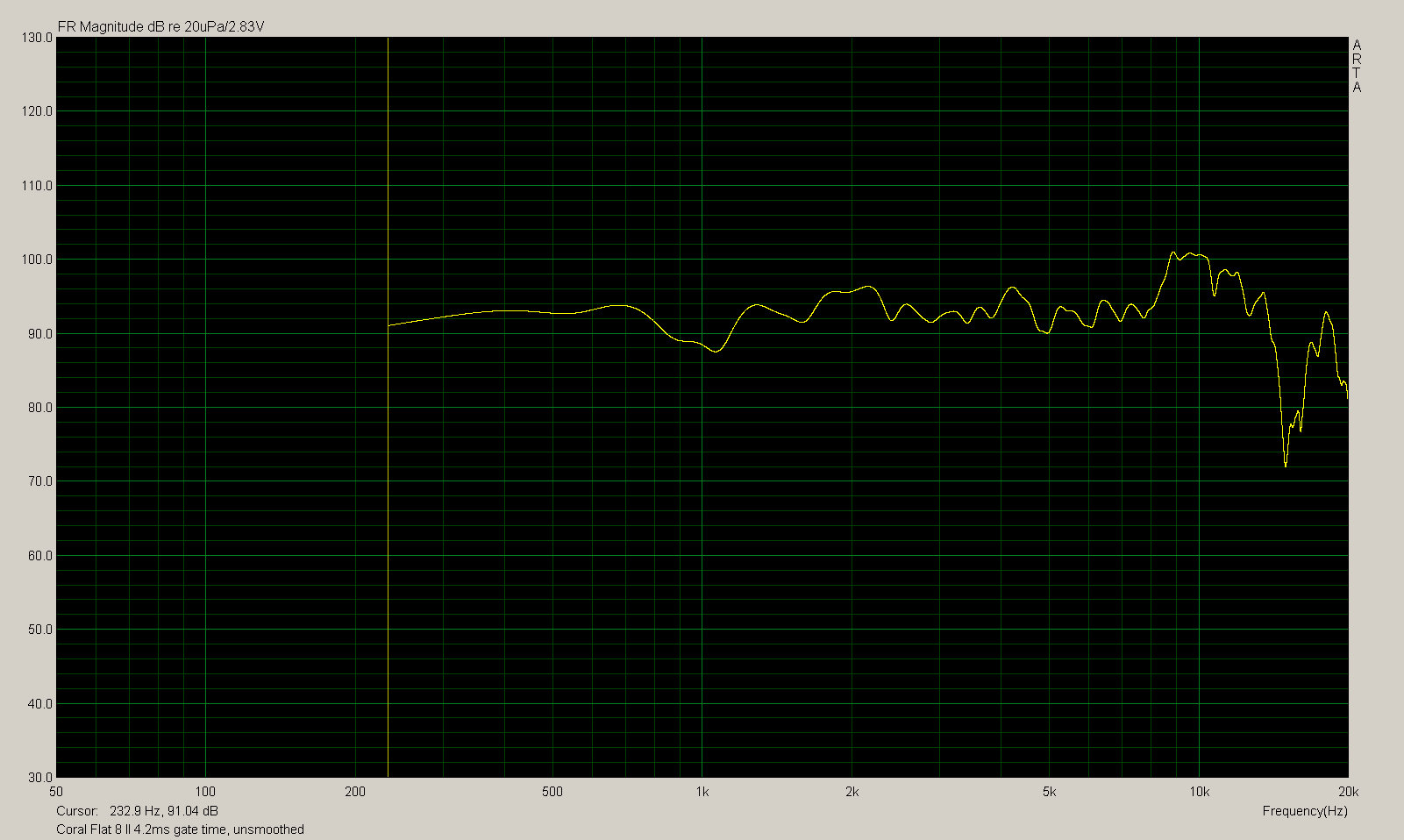

For reference the driver I posted response graphs of previously was a Coral Flat 8 II. (The driver in my signature pic)

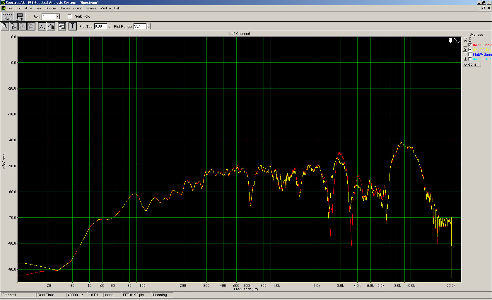

The ones I'll post in this message are the Coral Flat 8A. Visually they look like the same driver, but there are some differences - in the particular pair I have, they have very stiff surrounds, probably suffering from stiff surround syndrome with age. (They're close to 40 years old now)
Supposedly a fabric surround but it's so stiff that it's either heavily doped with resin or varnish that has gone hard over time or it's some other material, maybe even phenolic. The Fs is 105Hz because they're so stiff.
On the other hand the Flat 8 II surrounds are extremely soft and supple fabric, (probably porous too, as they don't seem to be doped with anything) so soft that for the same cone mass the Fs is around 38Hz.
An additional difference is that I (very stupidly, in hindsight) coated both cones with a couple of thin layers of a water based rubber and carbon compound. (Otherwise known as the stuff that you coat tyres with....) This had surprisingly little effect on the main cone, but a rather unfortunate effect on the whizzer cone. Unfortunately I don't have a directly comparable before and after measurement for this change, so the baseline measurement I'm providing is after this coating but before adding foam strips.
Given all that, the first response shows the "unmodified" (before foam strips but after ill-advised coating) response of the driver in red - which looks almost nothing like the zig zag response of the previous driver. There is however a dip around 3.2Khz and a large peak at 3.8Khz on the order of 6dB, which is a classic cone breakup resonance, albeit quite a lot better controlled than the other driver.
From what I can remember, the coating I applied made very little difference to this part of the response, so I can only assume that either the paper internal composition is a bit different, or the rather hard, stiff surround is better terminating the edge of the cone at high frequencies.
In any case I wanted to try to smooth out that spike at 3.8Khz, so I experimented with foam strips. I have 3 different combinations which I kept measurements for and I think they're interesting in showing just how much the response can be tailored by the number and position in strips, and the iterative approach I took.
The yellow response in image 1 was my first attempt - consisting of 4 strips at 90 degrees right near the edge of the cone and another 4 in between them spaced in about 20mm from the edge. The big spike is clearly tamed down and the dip at 3.2Khz improved slightly, but I thought I could do better than this.
Configuration 2 in dark blue in image two was achieved by doubling the number of strips but keeping the same basic layout - so now there are 8 equally spaced strips at the edge, and 8 equally spaced strips in between these and offset in by about 20mm. This pulls the response down even further, with the response at 4Khz where we want it but now we have a bit of a hole around 3.2Khz.
4Khz corresponds to the inner strips while 3.2Khz corresponds to the outer strips so I tried removing every alternate outer strip - leaving 8 inner strips and 4 outer strips. The result is the light blue response in image 3. This is flat within +/- 2dB from 2.7Khz to 6Khz, quite an achievement for an 8" whizzer cone driver IMHO, especially compared to the original red response. The droop from 7-8Khz and the peak from 9-12Khz are both due to the aluminium dust cap resonance and its interaction with the whizzer cone output.

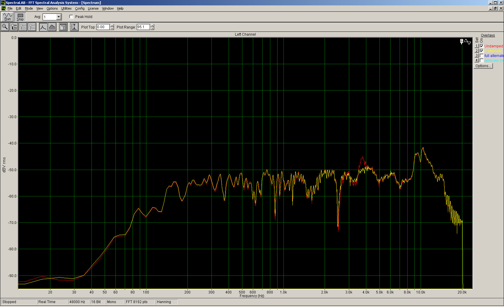

What about the large dip at 2.5Khz ? None of the foam strip mods altered this in any way, and this notch is real, not some measurement artefact. Sadly, the cause of this notch is the coating I applied to the whizzer cone.
The fundamental mechanical resonance of the whizzer cone at ~2.2Khz which is normally fairly low Q, and in phase with the response of the main cone (well, at least less than 120 degrees) causing a modest bump in the response that can be corrected quite well with an RLC compensator or PEQ.
Somehow the coating has altered the cone properties to affect the phase shift and Q to the point where the whizzer cone and main cone are 180 degrees out of phase and almost equal in amplitude on one side of the resonance, so a notch appears.
Nothing I've done to try to undo this mistake has ever returned them to their original no-notch response, and there is nothing that can be done electrically to compensate for it either, so sadly those drivers were never used in a completed design, (and have become a bit of a driver tweaking testbed) because the resonance of that notch is actually quite audible and annoying.
So on this particular driver I think the foam damping strips were highly successful, but the overall response of the driver was ruined by the tampering with the whizzer cone. Pity. If I knew what I knew now I would never have touched the whizzer cone or applied any coatings - I would have gone straight to the foam strips.
In the next post I have another driver where foam strips whilst altering the response, didn't give a satisfactory final result. (Just to show that they can't work miracles on a really bad driver

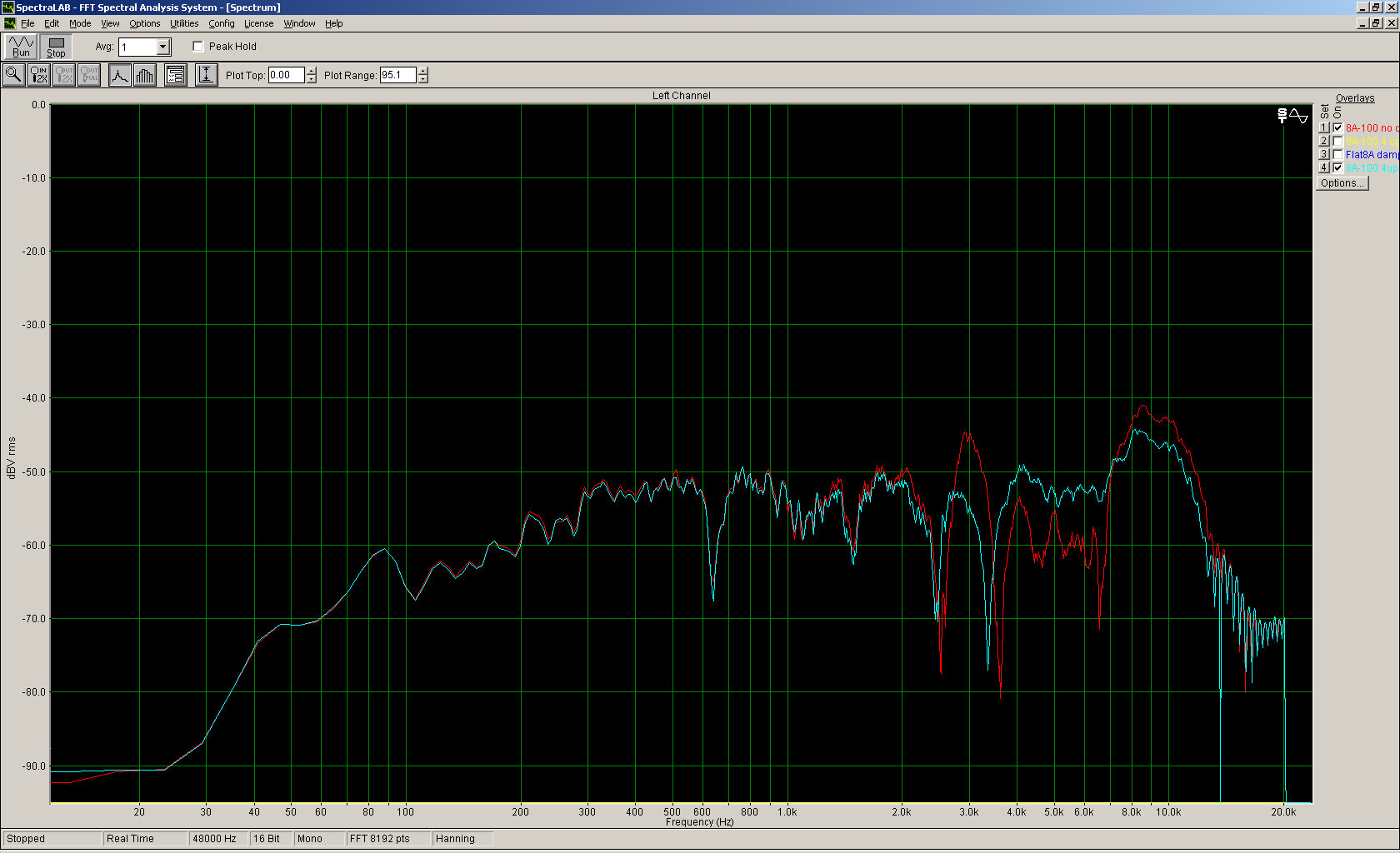

This is yet another Coral driver - The Coral 8A-100. My Dad had a whole bunch of these and these were actually the first drivers I experimented with foam block damping on, because there were such obvious resonance problems with them to the point where even just touching the perimeter of the cone with your fingers made a big difference to the sound of the resonances, which is what got me thinking about sticking foam blocks on in the first place, and where to put them.
The one I show the measurements for was the worst one by far - most of the others measured considerably better in the treble, although all of them had the notch at 2.5Khz and peak at 3Khz, and all measured quite differently from each other.
Again physically they look much like the Flat 8, but from what I understand they were a "budget" model manufactured using the same moulds but not necessarily the same materials (or level of quality control...) and sold OEM without the Coral brand. (None of them have Coral written on them, only the model number)
They have a relatively soft fabric surround with a lot of travel like the Flat 8 II, but they're clearly doped with something. They also have a paper dust cap at the base of the whizzer cone rather than the vented aluminium dust cap of the other two models. The cones are jet black, compared to the pale cream colour of the other models, but otherwise appear to be the same geometry, including perimeter stiffening rings. Their sensitivity is about 2dB lower with a higher Qts and the magnet looks a bit cheaper.
The unmodified response is in red in image 1. Yuck! That really is pretty bad, and it's no wonder that particular driver sounded so bad, in fact I would go so far as to say it's defective in some way, as the other 8A-100's whilst not exactly flat, were nowhere near that bad.
The difference between the peaks and dips is close to a staggering 35dB. Yellow in image 1 is more or less the same configuration of strips applied successfully to the Flat 8A in the previous post - you can clearly see a reduction in the peaks at 3Khz and 4Khz, and an improvement in the notch at 3.5Khz, but it's still pretty awful.
No combination that I tried would give significantly better results than this - it just moved the peaks and dips around in frequency. I then started to wonder if a whizzer cone resonance could be the problem, so I tried adding 4 foam strips behind the edge of the whizzer cone, the result is in cyan in image 2. There's a clear improvement from 4-7Khz, but there is still a big notch at 2.5Khz and 3.5Khz.
From this its pretty clear that there are serious cone breakup problems within the whizzer cone on this driver. (But not the others) From memory in this particular driver the whizzer cone was sticking out at least 5mm, maybe 10mm further from the main cone than all the other drivers, so it's possible that this shifts the resonances and relative phase shift of the two cones to the point where destructive interference becomes a problem.
Or it may be a difference in the materials composition - maybe the coating applied to make the cone black (it looks like its been spray painted matte black) has enough of an effect on the critical damping and stiffness to weight ratio of the whizzer to cause problems. (The cone is not nearly as "crisp" as on the better drivers - it feels a bit soft and soggy) Whatever it is, both cones have serious breakup problems that cause a rather ugly summed response which is full of destructive interference and resonances and makes for an essentially unusable driver.
Image 3 is comparing the best damped response I could get from the Flat 8A (dark blue) with the best damped response I could get from the 8A-100 (cyan) - even with all the tweaking its nowhere near as good, despite being largely the same design of driver. (The 650Hz and 1.6Khz notches are measurement environment reflection artefacts, but all the other notches really are in the drivers responses)
