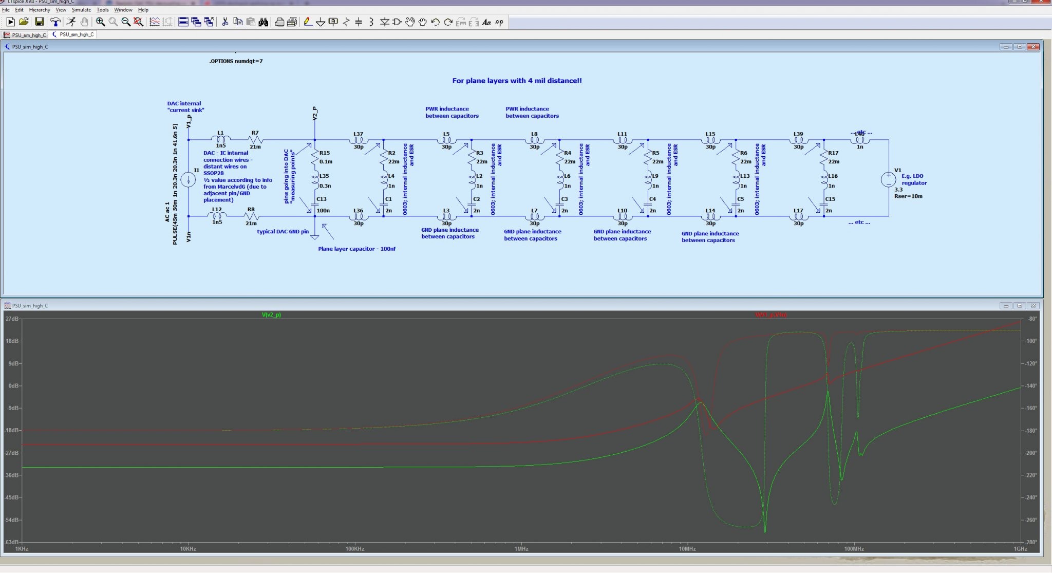

I suspect your plane modelling in the sim is not fully depicting what's really happening in a plane capacitor at RF, I would think it does much better in practice.
As for the package-limited parasitic L (and R) we want to arrive at, I could imagine corner cases where some true resistance (at RF) in GND and VCC feeds to the chip pins might improve things in that it could help dampen the effect of antiresonances formed by internal capacitance to lead-frame inductor to decoupling cap tank circuit. Give them nervous potentials some wiggle room to live and relax rather than putting them into a straight jacket, so to say

@KSTR : Hi - & thanks for your elaborate feedback. Well ... I guess there may be a lot of phenomena to observe in DAC etc. decoupling which is why I hope to arrive at a reasonably predictive simulation model. It just would make things much easier than actually building the considered design each time something is to be tested ...
That may very well be - although my guess is that LTSpice would be quite precise in such relatively simple simulations. Do you have any suggestions as to what could/should be different? The included values for the plane capacitor (100 nF, first capacitor) is the resistance and inductances of a via connection plus the distance from the plane capacitor through to a top layer placed appr. 0.25 mm above the plane capacitor layers ... The other capacitor values (2nF) are taken from Kemet's capacitor simulation tool (I use a download version but also available on the internet).
Hmmm ... interesting and somehow also what I was suspecting. BTW - here assuming that one of the reasons you are not using your W&G analyzer that much is that it could be a comprehensive setup/adjustment process - have you seen these new analyzers coming up? Possibly accessible price-wise and looks like an interesting dynamic range:

‘Im a bit late to this very interesting discussion, but looking at Jespers model, are the trace inductances at 3 nH per side right next to the pulsed load (assuming this is the DAC) not a bit high? If the cap is placed right at the supply pins and there is an assumed good quality ground plane I would have suspected lower trace inductance. The trick of paralleling capacitors to flatten the resonance points out (I guess the equivalent of reducing the Q) is well known. If you have signal components in the 100’s of MHz due to fast rise times, the required decoupling caps will be very small - a few nF at most and in very small packages - in order to reduce package inductance.
IIRC, maybe it was from Ott, putting two SMD caps right next to other in parallel, then grounding the opposite end of each cap, and driving them in parallel from the ungrounded ends causes currents to flow to ground though the caps in opposite directions. To the extent their magnetic flux partially cancels, the net inductance is reduced.
If I understand it correctly, those are meant to model the DAC's package and bond wire inductances. They are of the right order for a typical SMD package with leads and wire bonds. I suggested putting a coupling factor of about 0.5 between them if the package pins are adjacent, though.‘Im a bit late to this very interesting discussion, but looking at Jespers model, are the trace inductances at 3 nH per side right next to the pulsed load (assuming this is the DAC) not a bit high? If the cap is placed right at the supply pins and there is an assumed good quality ground plane I would have suspected lower trace inductance.

The inductances of the DAC part pin measurement point (to the left of the V2_p) was taken from a package inductance specification document I think by Amkor. It is for an SSOP-28 package and the 3nH is the appr. inductance of the most distant pins (pin 1, 14, 15 & 28) of the package. However, as suggested by MarcelvdG I changed the inductances per pin to a 0.5x value due to their being placed next to a GND return pin on the IC in question (PCM1794). This is shown in the attachment in post #25.
And if I am not mistaken it is also indicated in the inductances of the package inductance link you provided (M12 values SSOP-28 - 1.45 nH). However, aside from the SSOP-28 package, some of the inductances are really low ... LLP, micro-SMD (CSP as I understand it) ... is this really realistic? Which IC's uses such packages BTW ... ?
