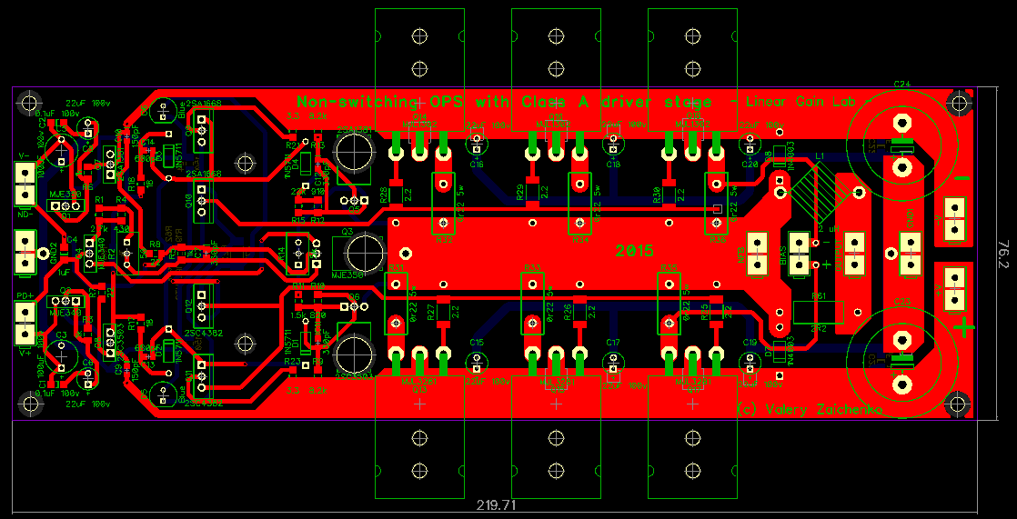

Last week, Marc (idefixes) has slightly re-designed the layout for the output devices NJW3281/1302, it also has 90 degrees drivers orientation, in one line, so that they can share the same aluminium plate - in this case, PCB length is only 220mm. So, for the future builders, this option is also available.
Valery
Here is the NS8ops variant Valery talked....220mm length board for TO264/TO-3P. Following Valery advice there is 6 more holes for more classical emitter resistors than MCP71...I will let chinese new year time going over and send files to board house.
Marc
