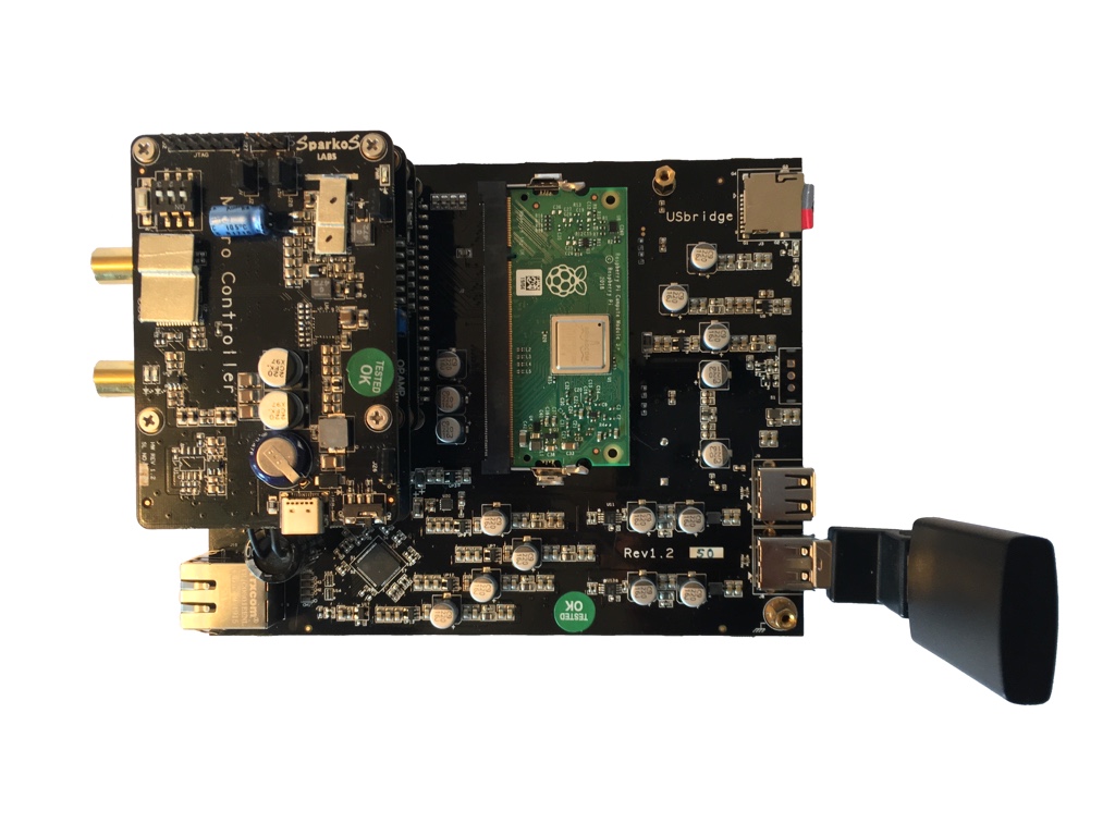

New Revolution PCB was populated today and testing will start on Monday. I should be able to send samples before the end of next week for SQ assessments .
Will your finished DAC have a volume control, maybe a screen?
What type is the usb input? It doesn't look like a type B connector.
USB Type A
Will release more details soon ..
May I ask why Type A?
IMO, Type A tend to be loose fitting.
Why not Type C or B?

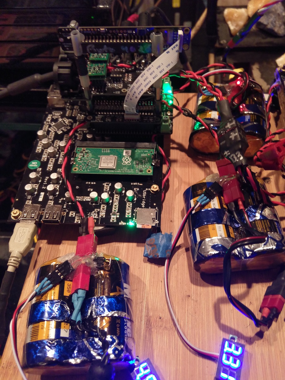

Many thanks to @Paul123 and the PcP team! I've got a USBBridge Signature setup running with their distro/SW combo.
They've added the ASIX Ethernet/USB driver(s) to their latest betas available here:
BETA: piCorePlayer6.0.0 - PI4 support
I'm using an Ian Canada GB FiFoPi / ES9028Q2M / IVStd stack as a test bed (Its a bit simpler setup than a Katana physically and in PcP, trying to limit variables for any troubleshooting needed... but it all worked right away once I used the new beta).
After less than 2 hours run-time, the setup is sounding VERY good with deeply dark and quiet backgrounds and a very dense, artifice-free, and articulate sonic presentation.
My initial impressions are that this setup will beat the same stack on one of my linear-regulated-modified RPi 2Bs using LDOVR.com's Mezzanine board, which themselves are a good step up from a stock RPi.

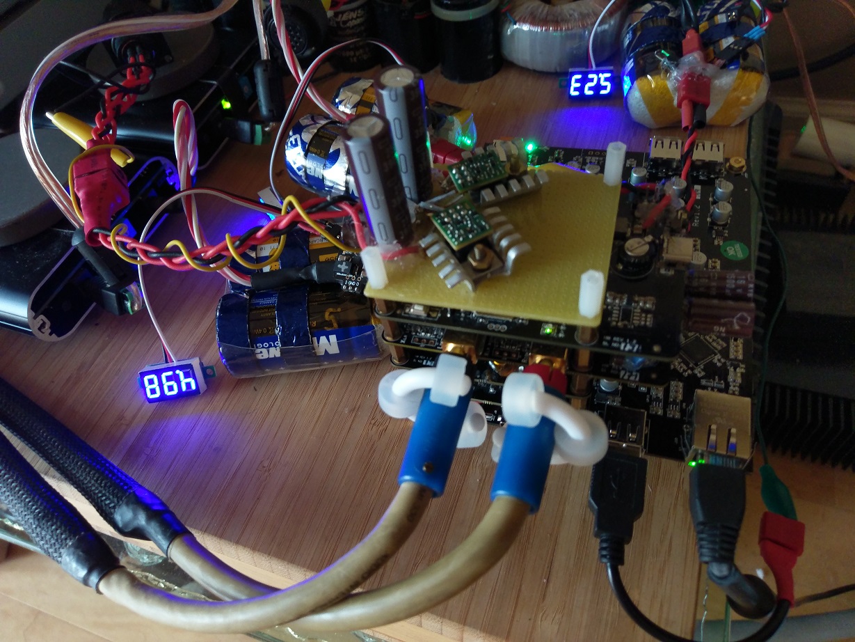

Power is my latest best setups... 2 DIY'd point-to-point Ian UCPi 2x350F Ultracap pair supplies float-charged to 3.3V by an Uptone Audio LPS-1.2 off-the-grid Ultracap supply on each. The USBBridge Signature is powered from another 2x350F Ultracap pair float-charged to 5V by either a Shanti or a modified K&K Audio Low Voltage supply. The output IV stage sports a pair of dual Sparkos discrete opamps and is powered by the +-13.2V outputs of Ian's LiFePO4 supply.
The 350F Ultracap pairs with the same float-charging scheme at 5V are working well on my main Katana setup too. I have yet to try powering the Opamp board with Ian's LiFePO4 supply, I'm expecting good results, perhaps next weekend.
I'm doing some component trials on my main Katana setup, which should be done this weekend. It'll go onto another USBBridge Signature then. I can't wait!
I believe Allo has another winner here! MANY THANKS Ioan and the rest of the Allo team for making one of my dreams come true!
Greg in Mississippi
P.S. Sorry for the busy picture... my power supply configurations are getting more complex with every iteration.
Greg in Mississippi

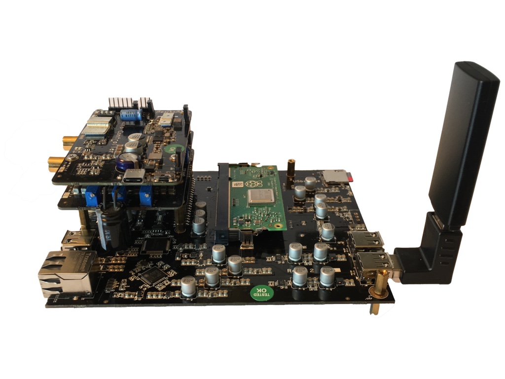

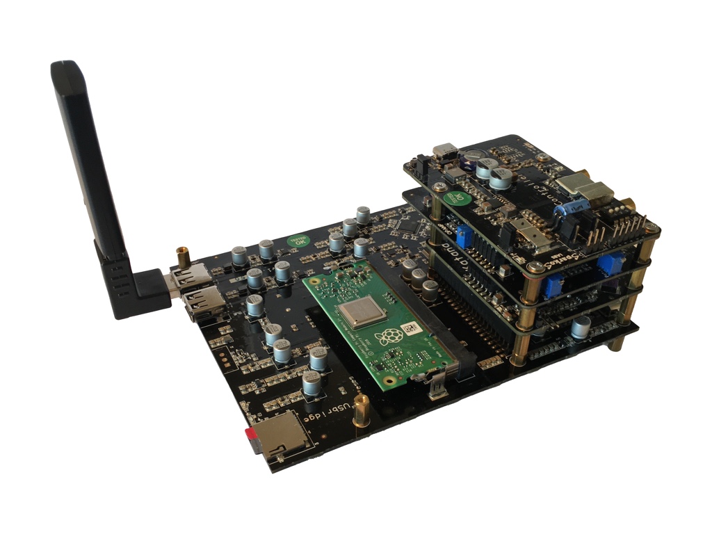

Here's some screen shots of the SIG + Katana + Comfast CF-912AC adapter.
The right angle USB connector is:
https://www.amazon.com/Adapter-Vertical-Coupler-Connector-Oxsubor/dp/B07C1Z552Z
