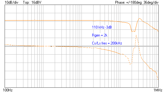

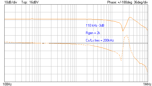

Winding geometry should be indifferent to the core material in the HF region. Sometimes there can be some subtle differences, such as:
Top FR is using a HiB core, Bottom FR using a nanocrystalline core. There is a slight behavior change in the dip resonance located at ~200kHz

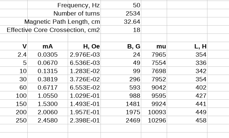

If it had 22H, it would not do 8Hz -3dB unless the measurement is wrong or one is not measuring the transformer alone. In the latter case the amplifier causing that drop for other reasons . I put a range from 2.5 to 5K because it was not specified. That is not going to make a massive difference because it's about equilavent resistance (i.e. plate resistance of the 2A3 in parall to nominal primary load). You can learn that from the Radiotron handbook if not clear.....
There is no 100x difference. Fram 1 mW and 26H, it goes to 35H full power. Effective permeability is 440 at 1 mW and 600 at full power. It is 1.36 factor or 36% increase. I uploaded a picture at post #134. Put an airg-gap, re-draw the magnetization with DC current and then draw the AC loop around the actuall DC magnetization for the small signal and large signal and see what you get. It's an AC loop because hysterisis will never diappear 100% (i.e. core loss willnever be zero).

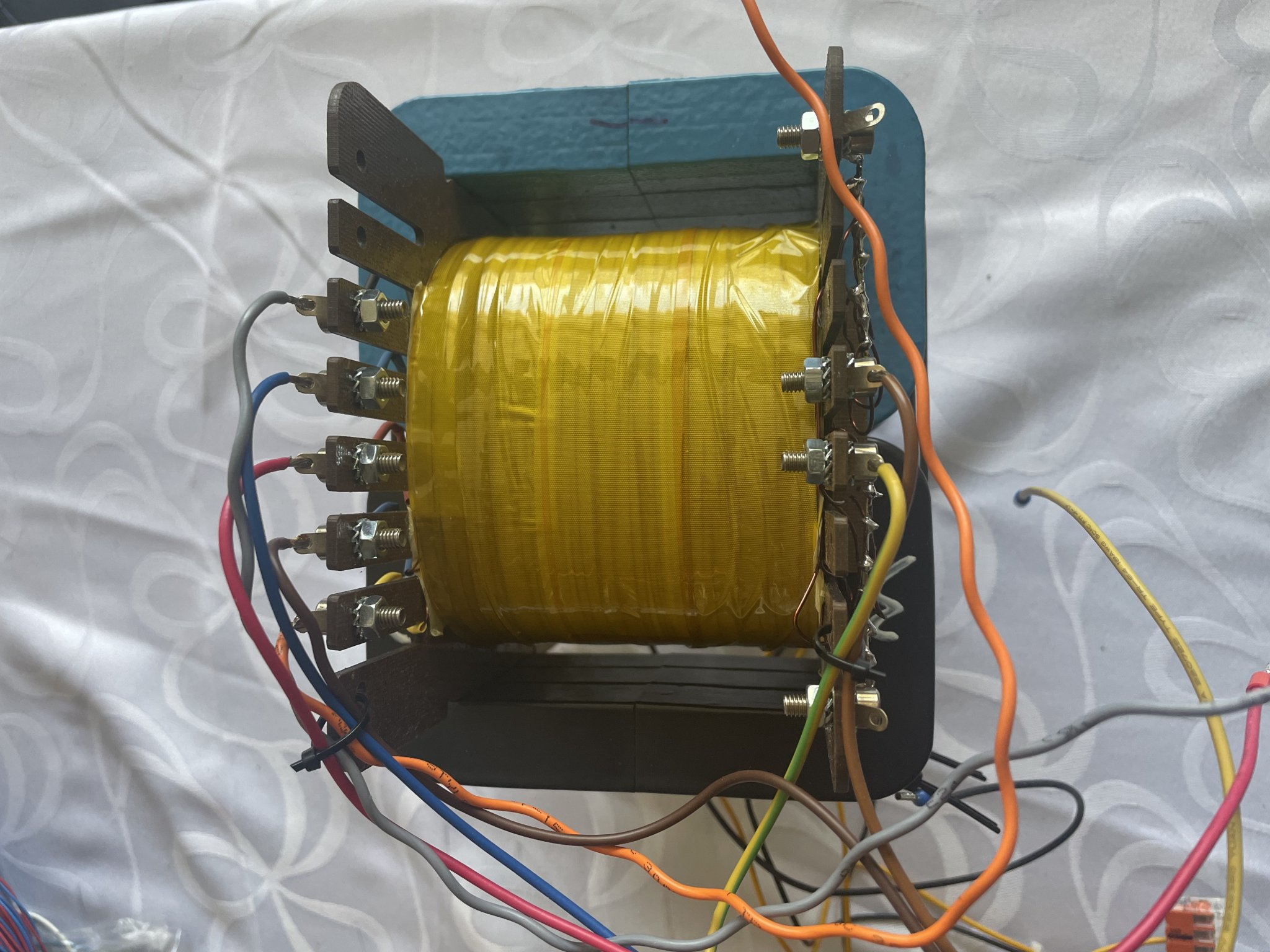

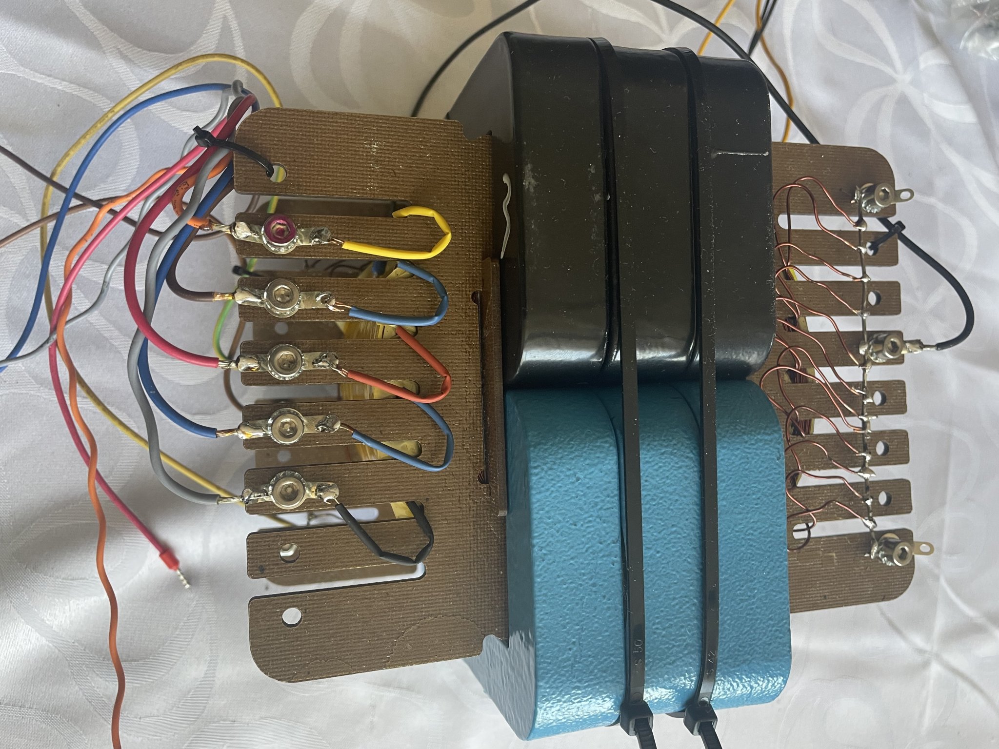

Center area 6x4cm, yet stacking factor for these types of cores is only 0.75. Material of course is the same, just coating color different. Unfortunately, coil design was unsuccessful. Someday I may build it again if I will have a mood to do so. Currently having very good 60W GOSS HiB transformers to proceed with my projects anyway (photo on the first page of this thread).How large is the core, the center area?
Is the core of different material (black and blue)?
