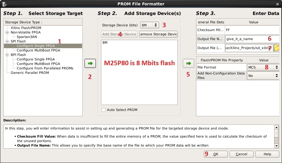

I'm at this point.

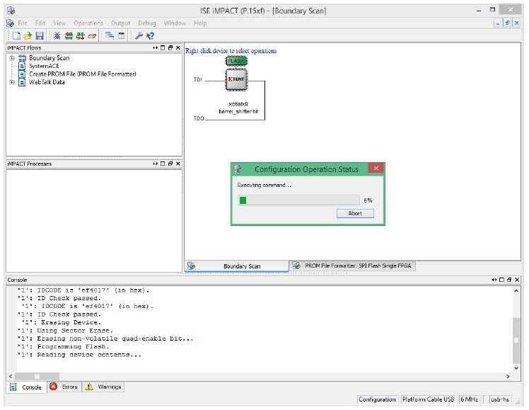

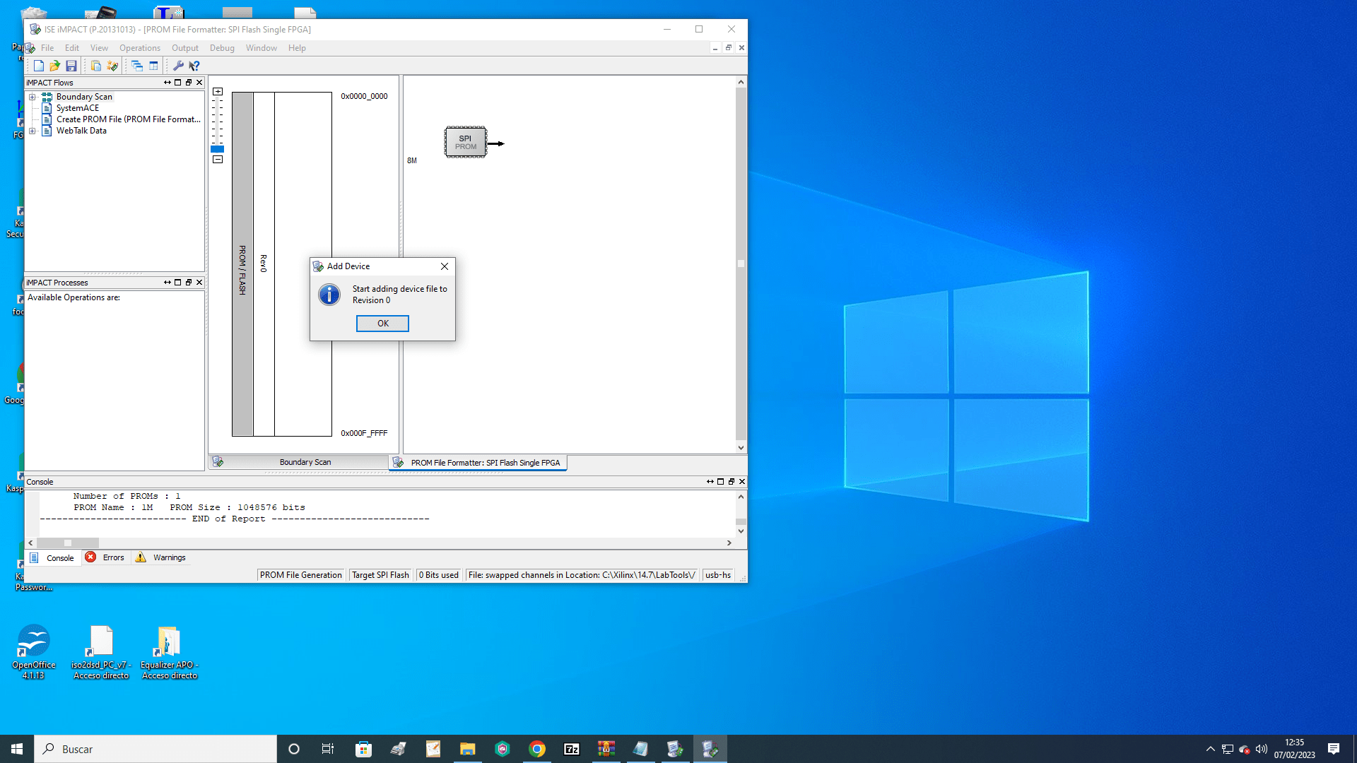

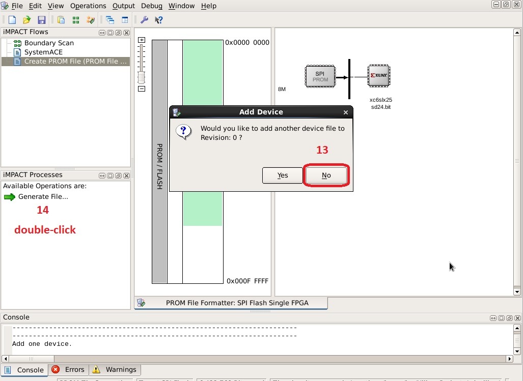

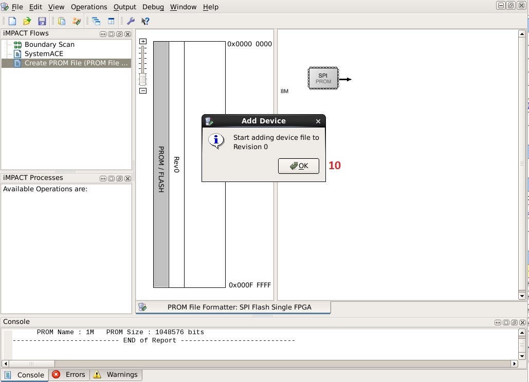

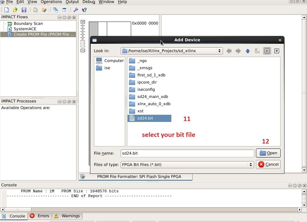

You have to create mcs file from your bit file: double-click "Create PROM File" and follow the steps you can see in the pictures below.
Check your flash memory chip on the modulator PCB, is it M25P80? I assume it is.
When you will have mcs file, right-click on the SPI/BPI square in the "Boundary Scan" tab and attach the SPI file you created (it will ask to choose the right model, so you should pick M25P80 from the drop-down list) and "Program" it - it will take a while.
Check this document from page 6.
Or you can check all steps from this document, starting at page 14.

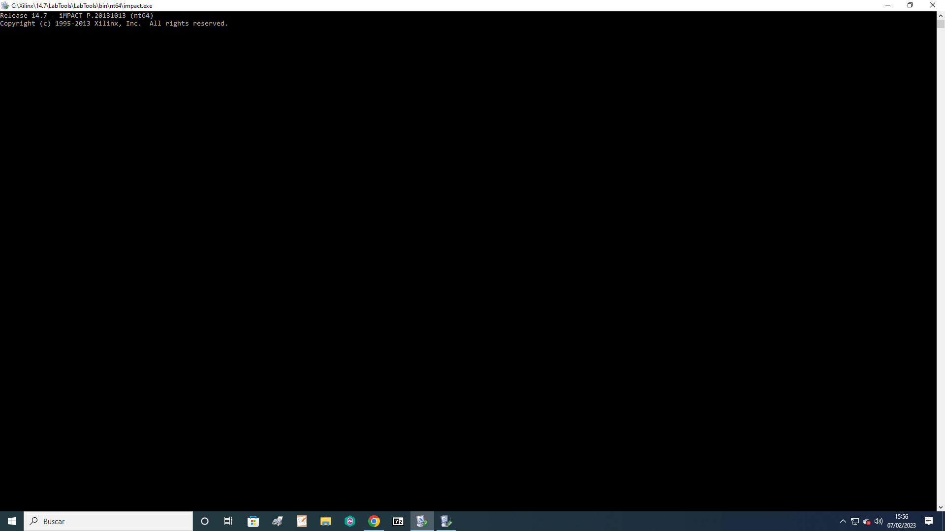

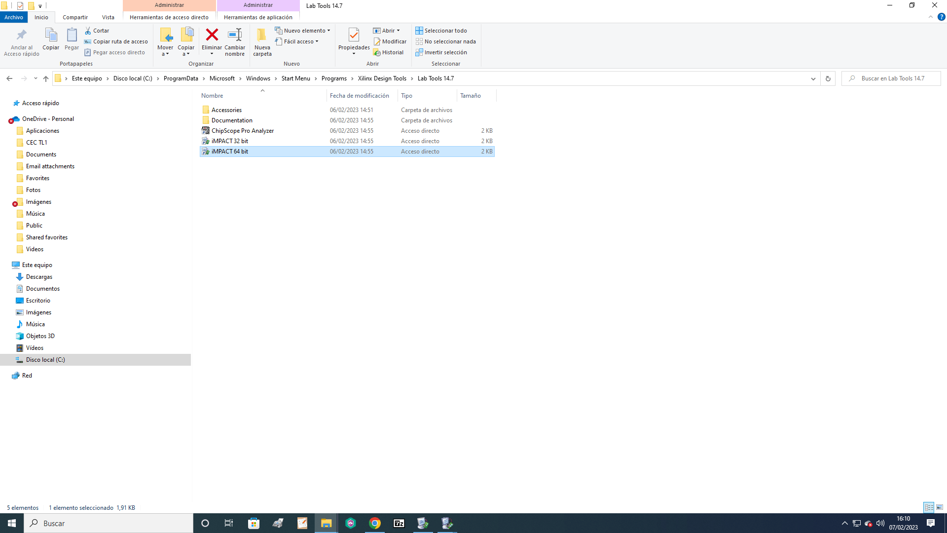

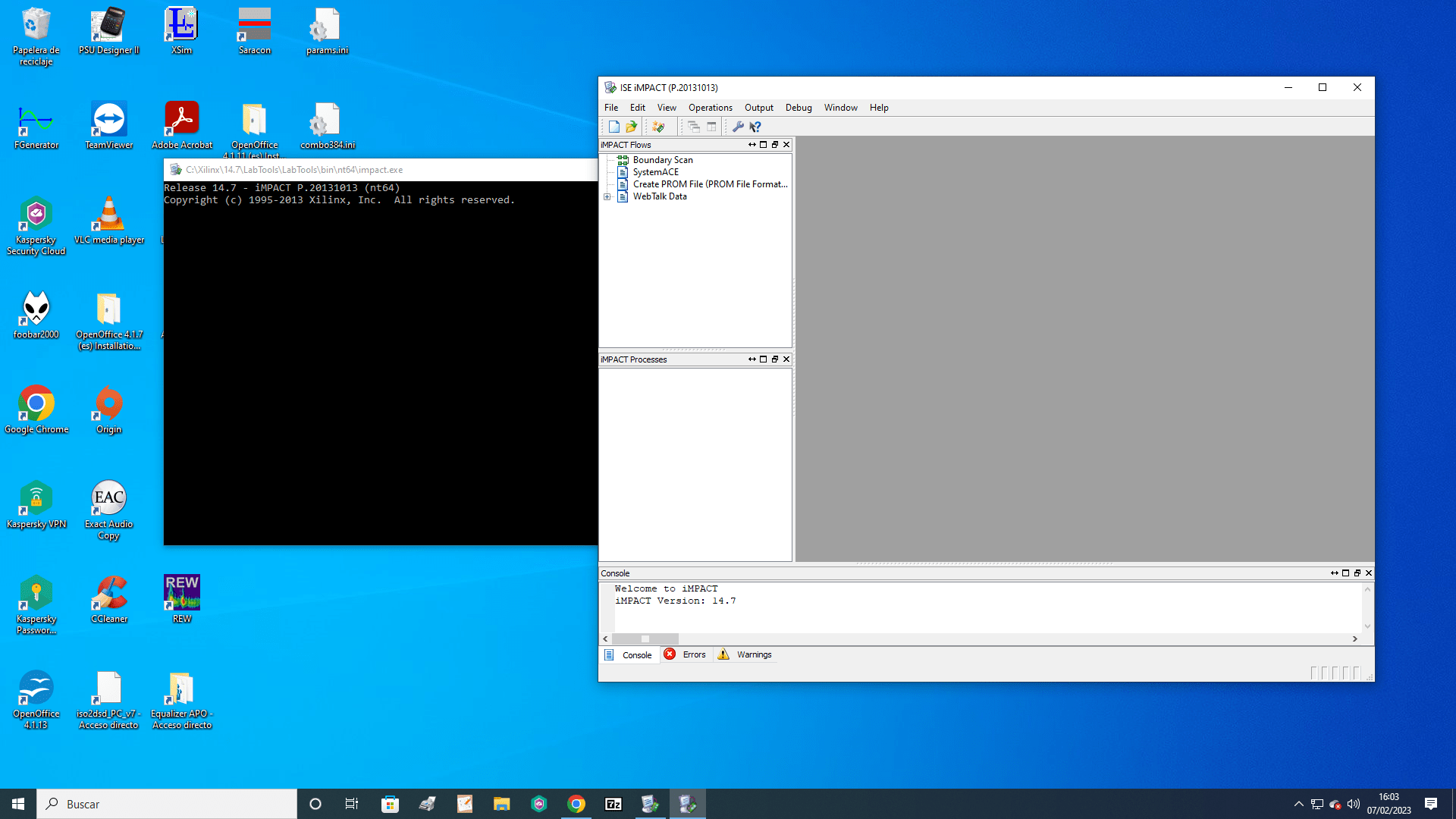

In the upper right hand corner of the Impact window you can collapse the window, or reduce the size of the window, or close the window. Either collapse it or reduce its size. That should expose the Virtual Box linux desktop. There should be a file folder there. You need to look in linux file directories, not in windows directories.
