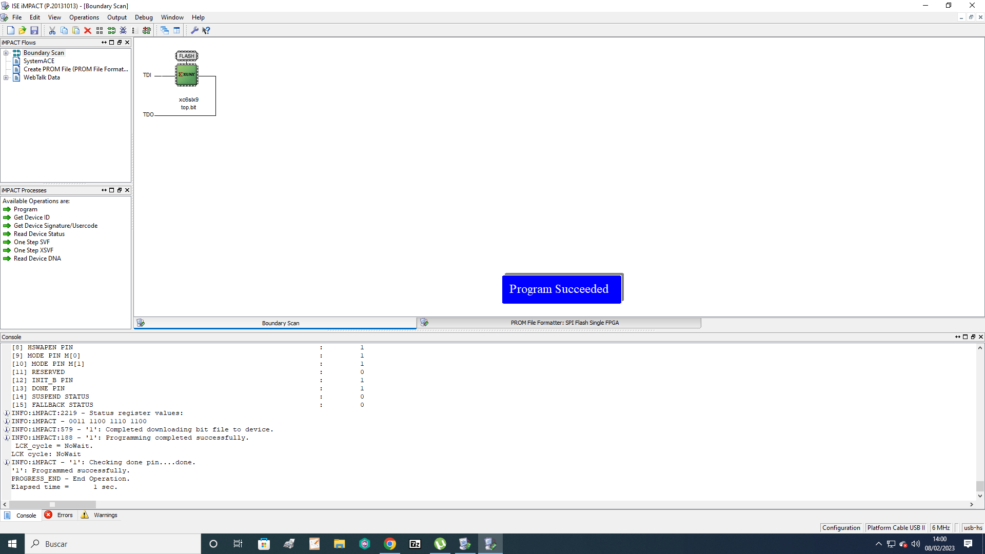

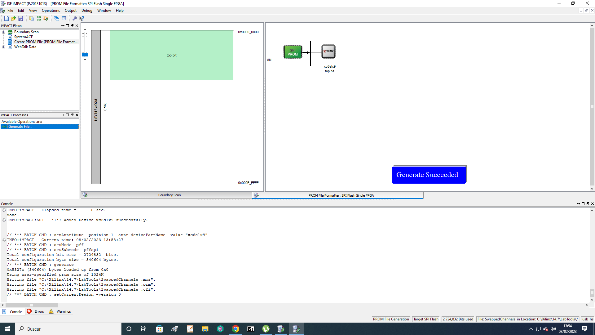

DISCLAIMER: Xilinx does not officially support using Windows 8.1 or Windows 10 with ISE Design Suite -
You can install ISE 14.7 Labtools 64-bit as follows: . . .<-----(click on the link to download it)
After installation completion of iMPACT labtools 14.7 in windows 10 environment follow procedure below:
Or do you want to install the Windows10 Virtual Box version of ISE 14.7?
https://www.xilinx.com/support/down...nloadNav/vivado-design-tools/archive-ise.html
BEST SOLUTION
- Open the following directory: <install_path>\ LabTools\LabTools\lib\nt64
- Find and rename libPortability.dll to libPortability.dll.orig
- Make a copy of libPortabilityNOSH.dll (copy and paste it to the same directory) and rename it libPortability.dll
- Copy libPortabilityNOSH.dll again, but this time navigate to <install_path>\ LabTools\common\lib\nt64 and paste it there
- In <install_path>\ LabTools\common\lib\nt64 Find and rename libPortability.dll to libPortability.dll.orig
- Rename libPortabilityNOSH.dll to libPortability.dll

although it is not really answering your problemI only have problems when the Simple DSD Modulator coverts PCM to DSD swapping channels and when playing native DSD512 files, so for sure the issue is firmware related.
if only DSD is swapped, you can use the maintenance tool to swap the DSD channels only
or are DSD64/128/256 unswapped?
Its the PCM channels from Daphile that need swapping so that the SimpleDSDConverter DSD outputs will be swapped too.
Either that or if its a DSD only dac then the L/R data output channels from the DSD converter can be swapped by swapping the wires. Of course, then Native DSD and DoP would need swapping back in Amanero.
oops, my mistake, but the tool can do both PCM and DSD swapIts the PCM channels from Daphile that need swapping so that the SimpleDSDConverter DSD outputs will be swapped too.
