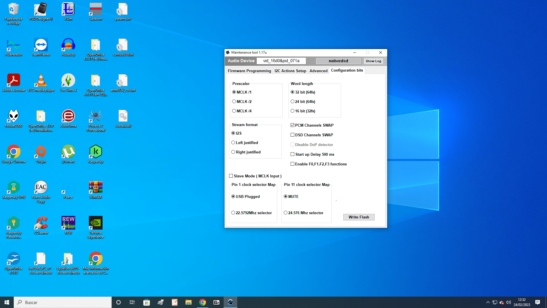

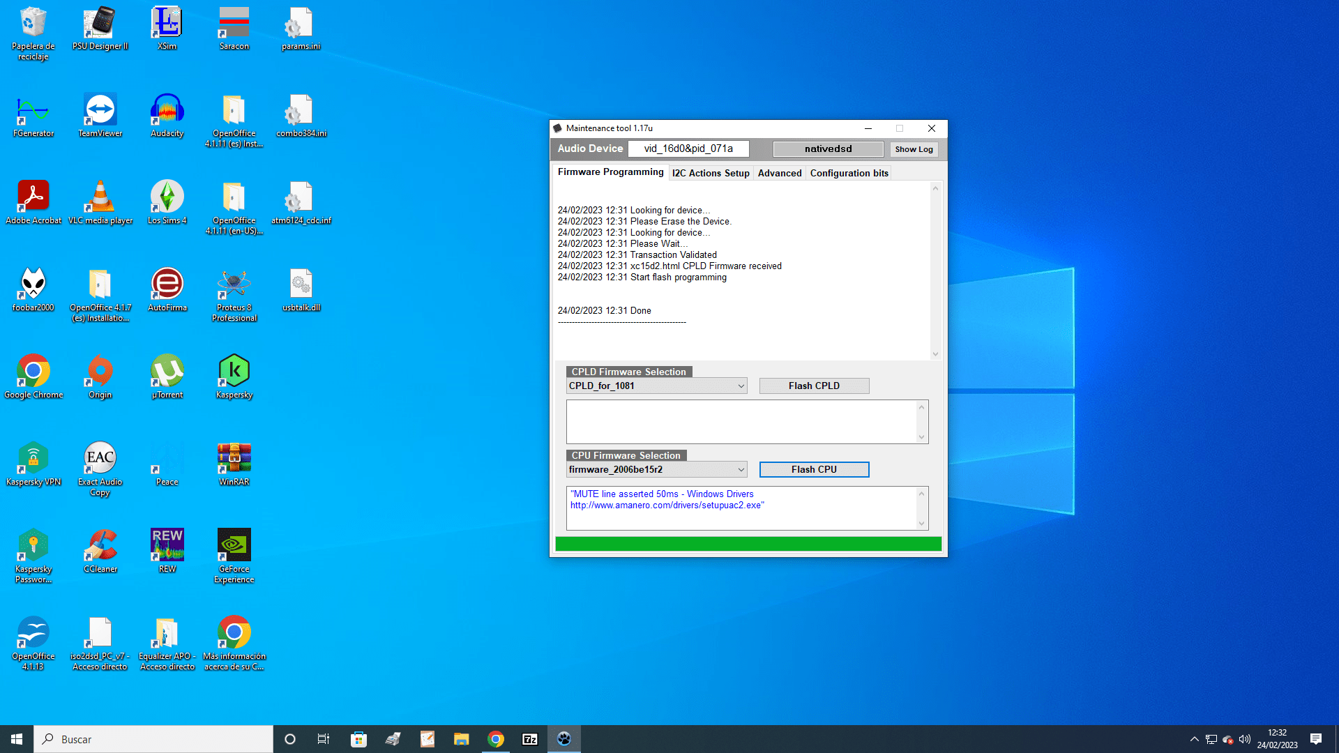

AK4499EX dac and Andrea Mori DSD-only dac. USB board is I2SoverUSB, which as a jumper to swap the Native DSD channels.
So, here's what should work for you: Swap the output wires so that Simple DSD Converter channels are correct. Then set the DSD channel swap option in Amanero so Native DSD channels are correct too.
If I swap the wires the native DSD files swap the channels, tried!
Hey guys tried both top.bit files but still invert channels when converting PCM to DSD files, any way to fix the issue?
You already got the answer link and link2
Version 2 you have may be the version 3 that I have. Don't know. Perhaps PJotr25 would be willing to comment...
Yes exactly, top_ver_2 it is with swapped channels in pass through (in PCM). Official 2 = Mark4 3 🙂
There is nothing else...
Thanks PJotr25, all you said make sense the solution as I said is firmware/software related, I will try swapping the PCM channels at Amanero.
