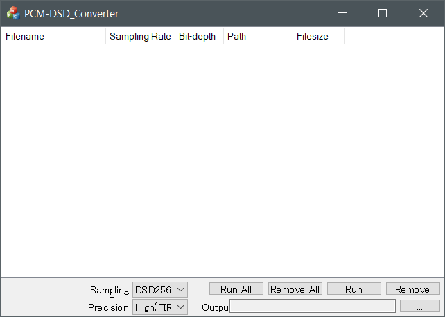

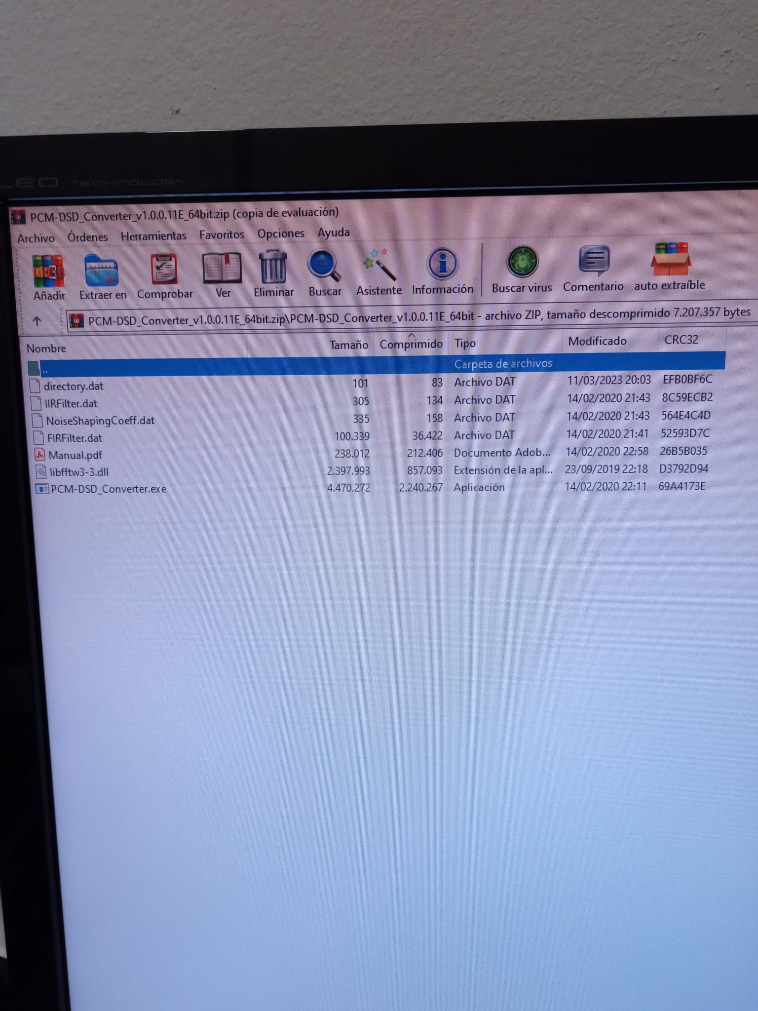

Tried to play the DSD256 file. It plays at the correct sample rate but the audio is null, there is nothing to hear.

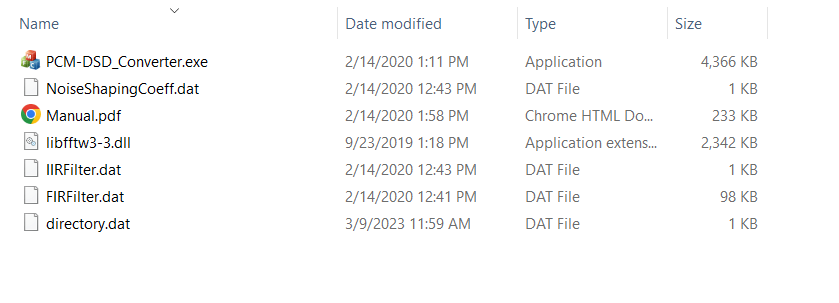

Don't know if you have the app installed correctly. Directory on my PC looks like this:
If any of the .dat files got corrupted or something like that, then you might have a problem.

Just send me a link to wav file you want to convert. If it works here, I will send you a link to the converted file which you can then see if it will play on your system.

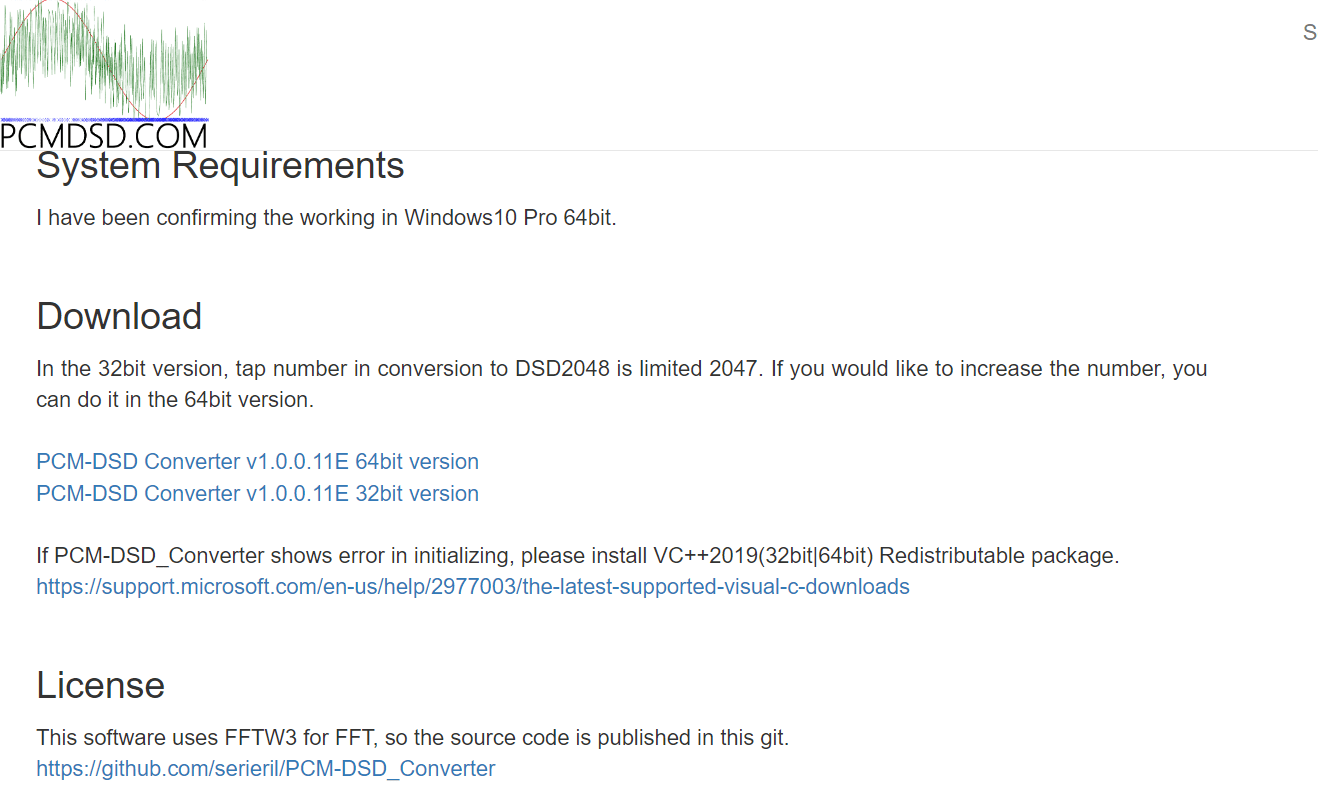

IOW, I am suggesting to verify if it seems to be a conversion problem on your particular computer. If we doublecheck that and it turns out the problem is indeed with conversion on your PC then we can dig deeper in that direction. Also, can you confirm that you have the correct MS Redistributable package?
