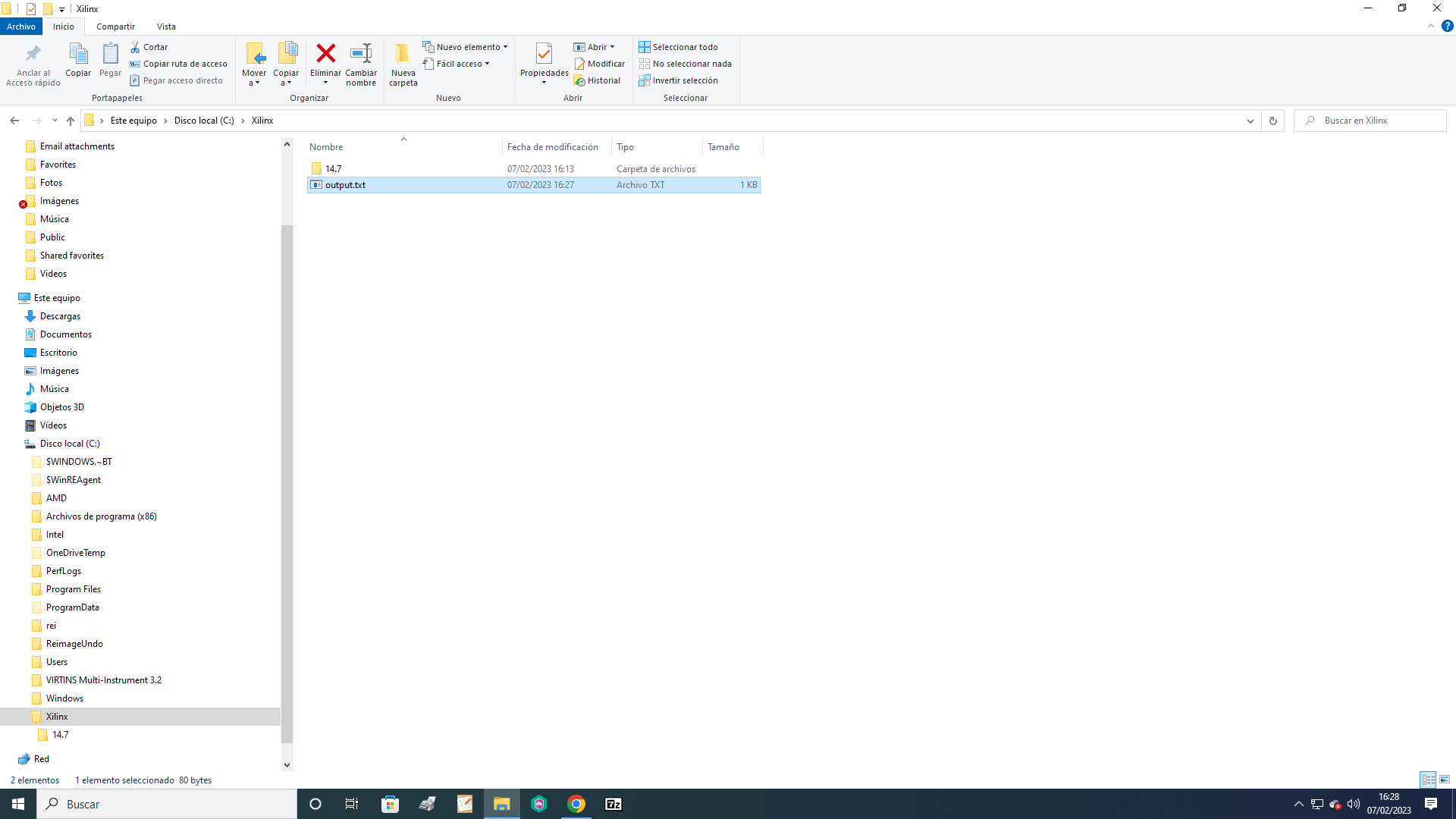

C:\Xilinx\What output directory did you select in step7?
Was it the directory that had the out.txt file?
Yes

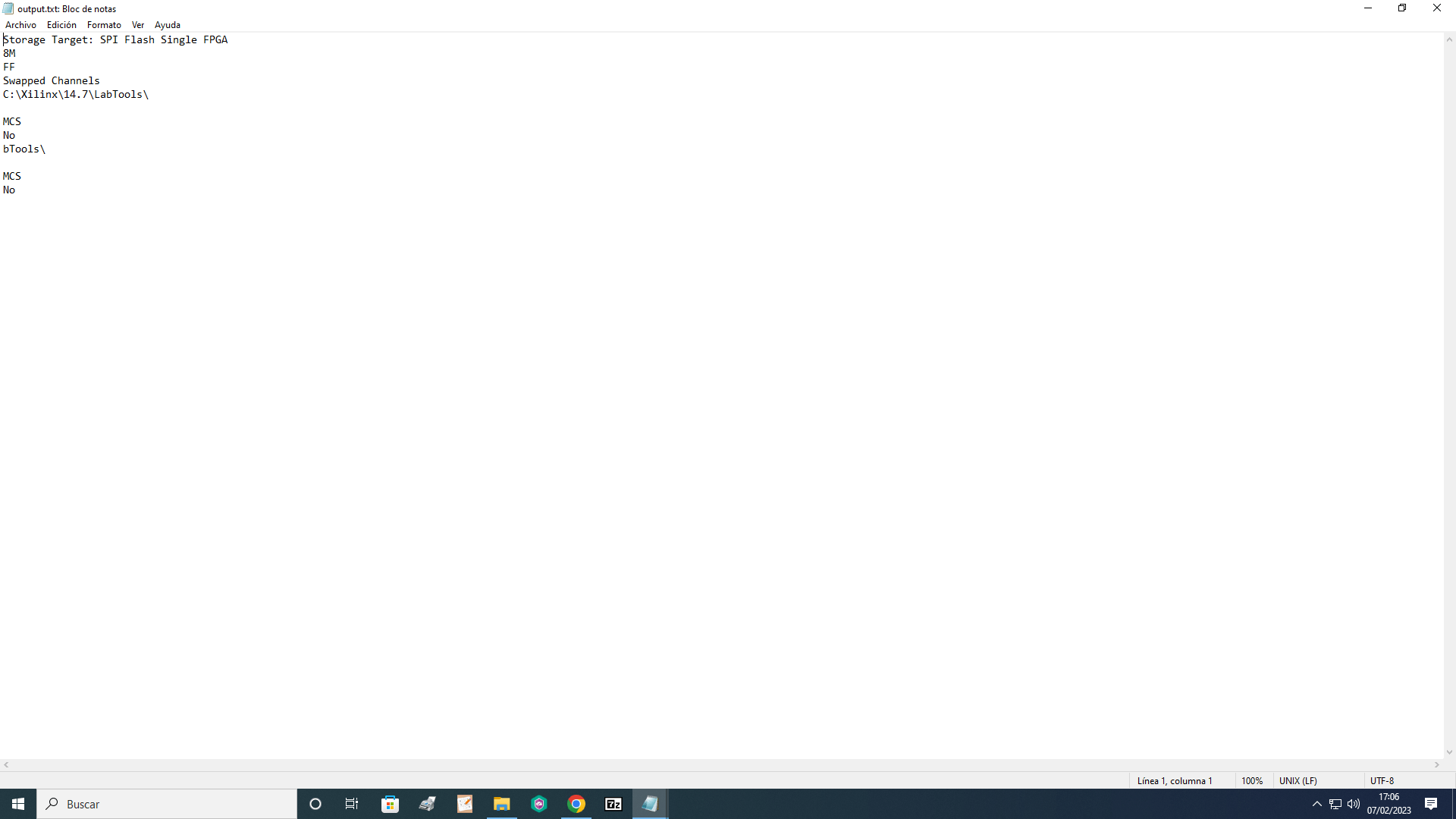

Does output.txt say anything if you open it?

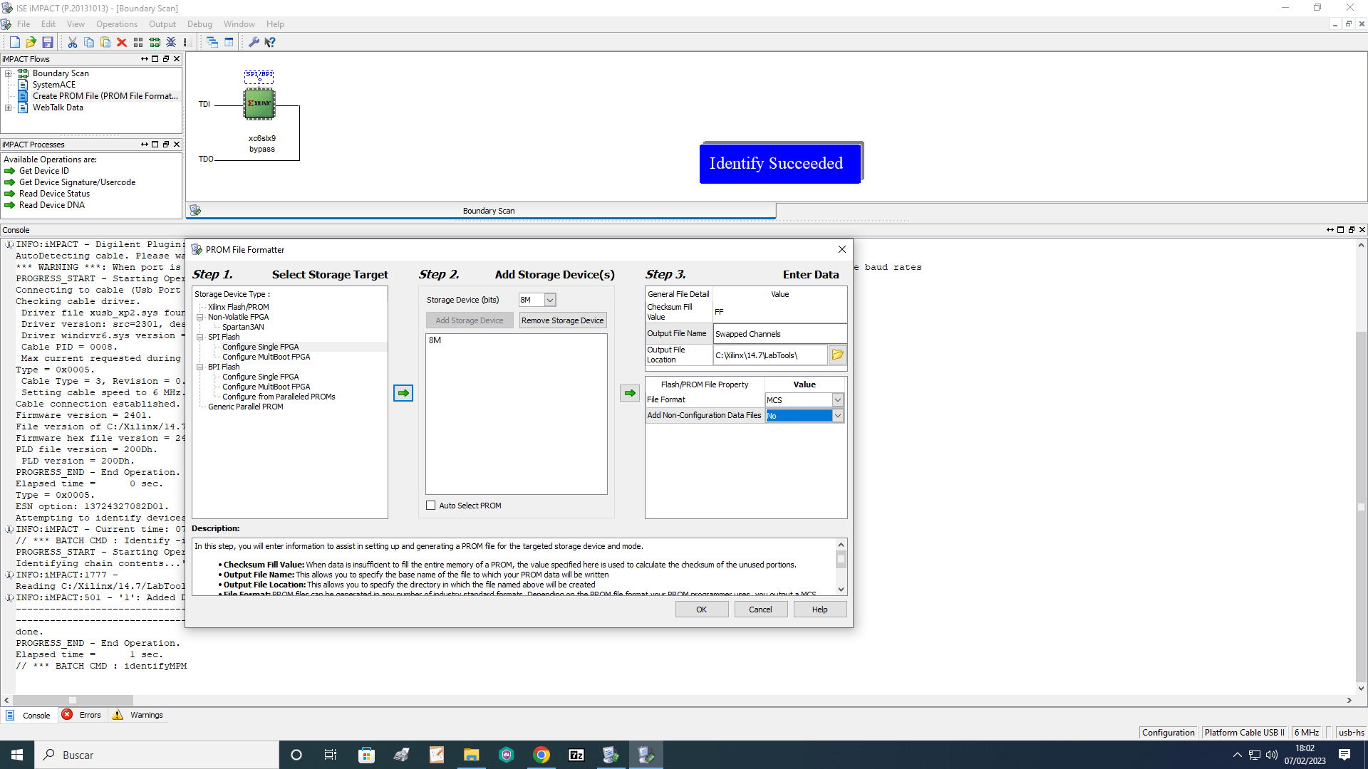

Also, at the bottom of the Impact window is a frame that says 'Console.' You can drag up the frame divider above it make the Console frame easier to read. It should have log of what happens when you try to make an mcs file. You can also check for Errors and Warnings. Have you checked what it says?
What do you mean when you say 'the program goes out?' Do you mean the Impact program closes itself more or less like if you had closed it? Do you mean Impact freezes? Something else?...when I press OK button to add device the programm goes out and stops working
When you say it 'stops working,' do you mean it freezes?
The program self closes both windows.What do you mean when you say 'the program goes out?' Do you mean the Impact program closes itself more or less like if you had closed it? Do you mean Impact freezes? Something else?
