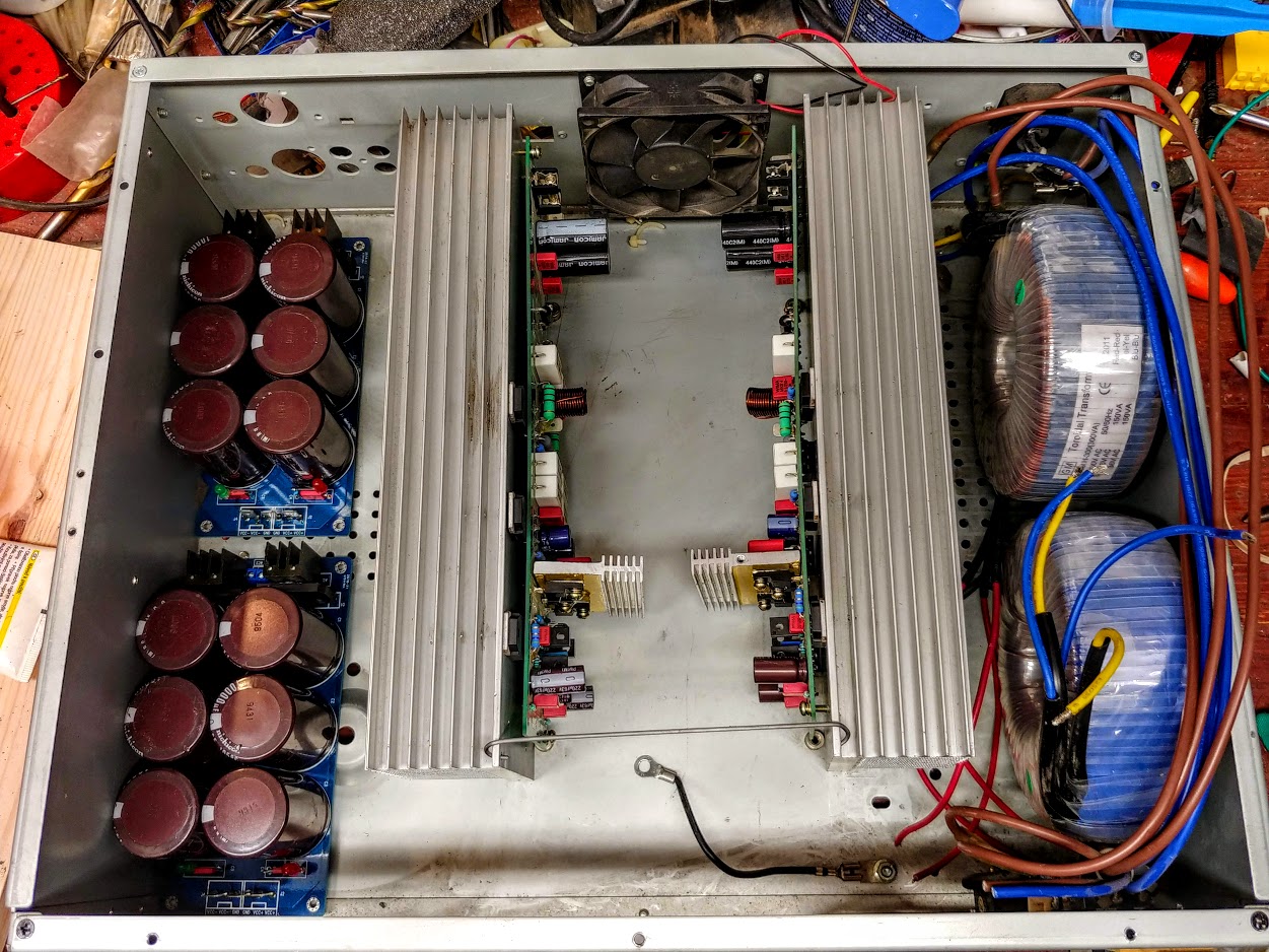

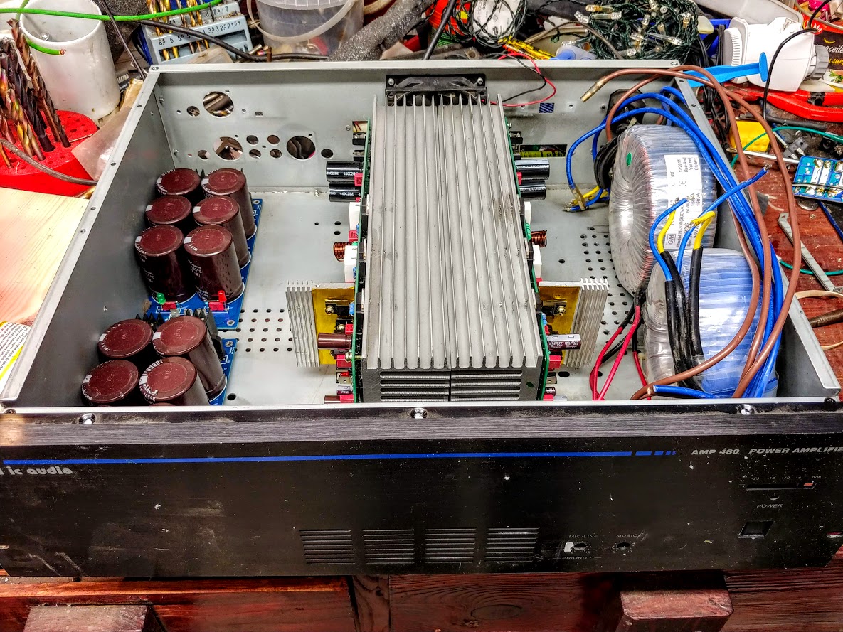

just thinking about layout... this is case from 100V amp...

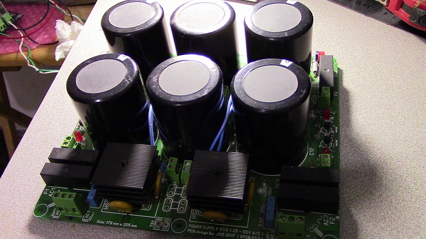

What are you using for AC rectification/filtering? I made up a cheap pcb design for my testing.
The transformers are rated for o/p V at full load and then you add the regulation % factor to figure out no-load V. You have some loss through the rectifiers.
Look at the datasheets for the ones I showed you a link too, they should explain it better for you.
yes I have a power supply that I design with a friend of mine Mr. ST = stuart and this power supply is multipurpose one single bridge can be use or two bridge "by wire can be set up that" all caps are 15,000uF 100V oh I saw the link so 50V? ok I was thinking 45V but if you say 50V I guess I will go for that then thank you for the info

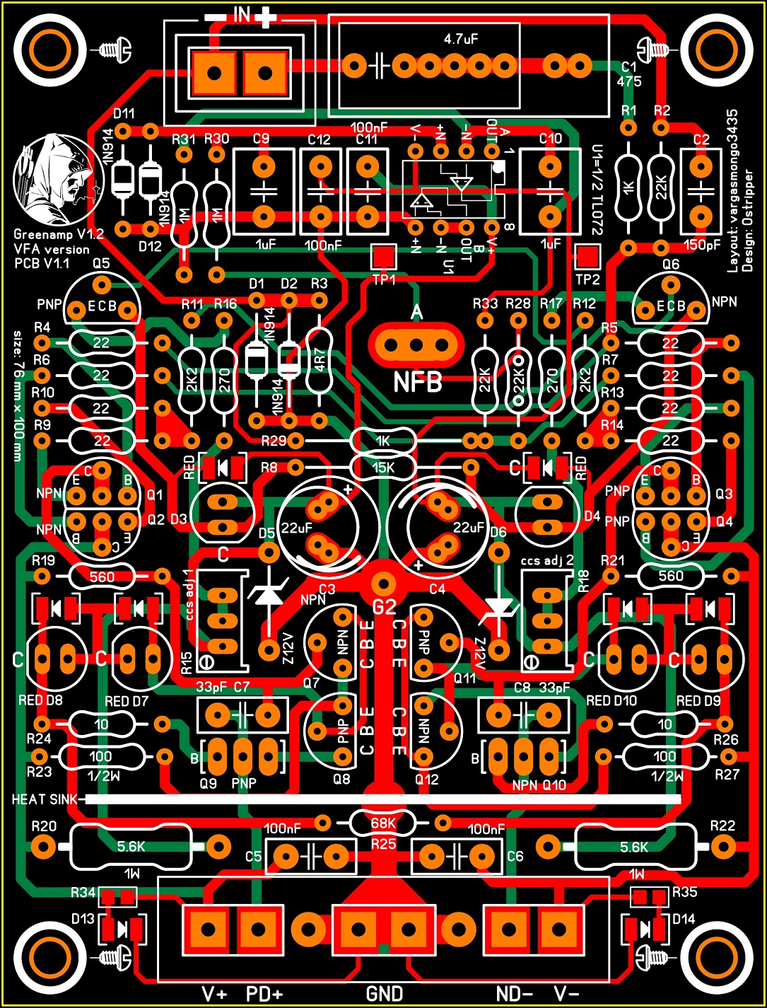

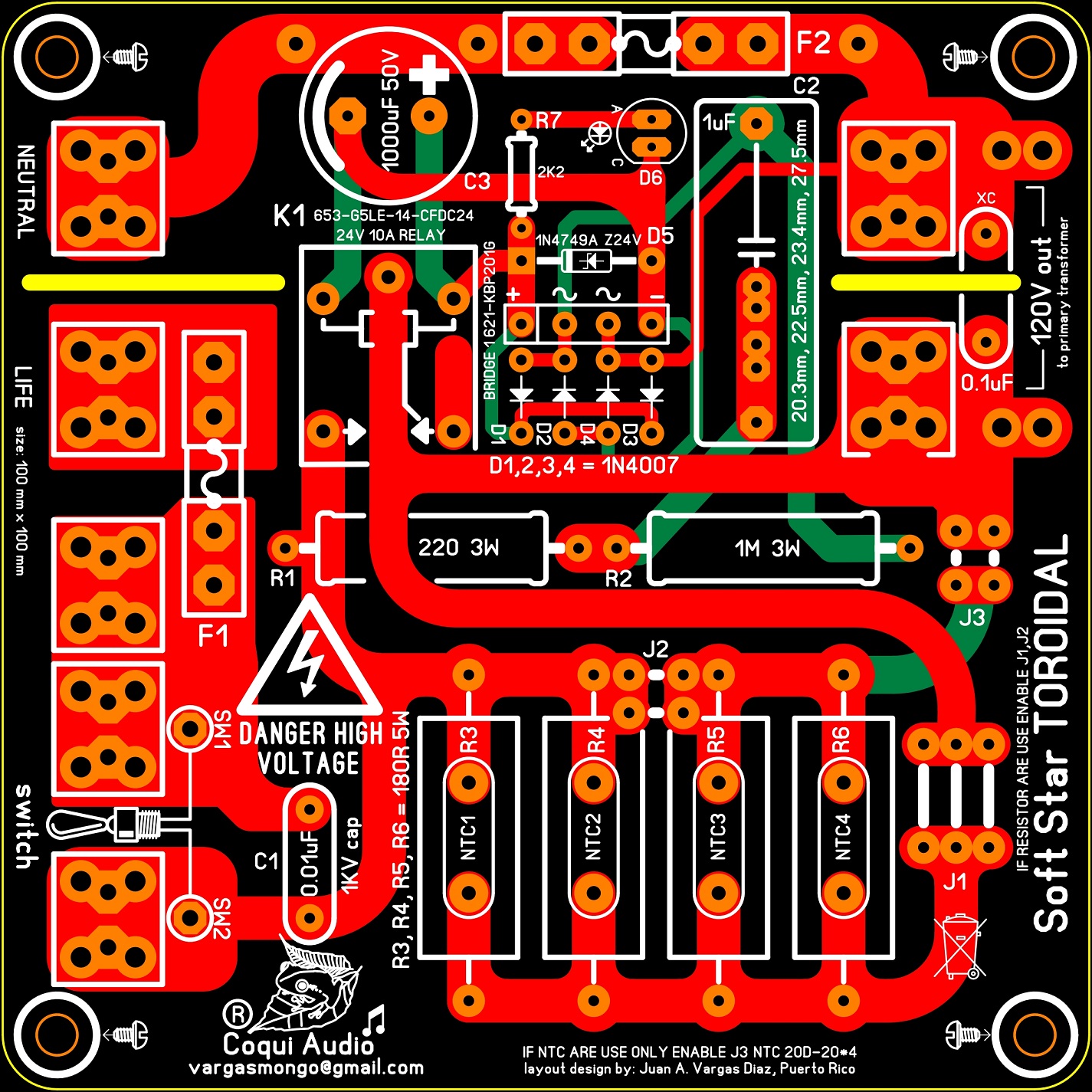

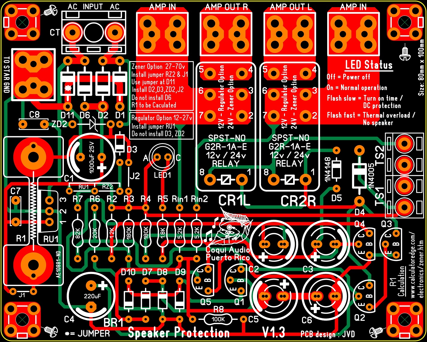

that is awesome man hey I just want it to show you the soft star the circuit is from diyaudio I just re-change the layout for my use also I have the new circuit that Mr. Ostripper design the Greenamp circuit version 1.2 VFA topology I have problems cause the LED that I order were reversed cathode and anode but all is fine I fix the problem and sound really good also I have the speaker protection PCB too oh I'm not by any means an engineer I'm just a fanatic of audio amplifier designs 🙂 I think this year I finally gonna complete a complete audio amplifier
Vargas
