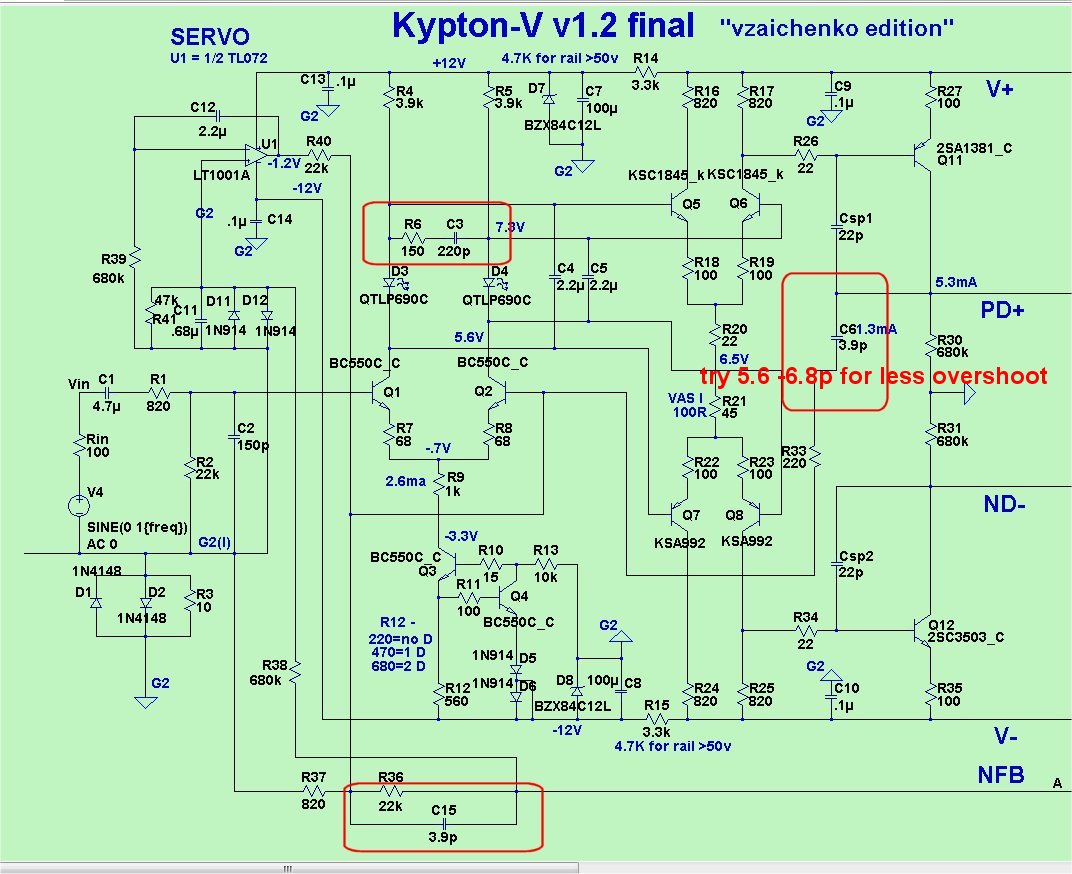

have you seen this inputstage from a well known manufactor?
Look how the VAS stage(Q605 + Q609 positive) is coupled as a "CCS" kind of.
Rather post something like the pm11, the manufacturer has been using this topology for over 7 years and has it well worked out.
Why?![]()
Just thought it could be the area where "mistake" has been made. Removing the CCS may be an option but in such a complex schematic I often prefer a better CCS so... At least I'm not suggesting changing the PCB

What do you think of this input?

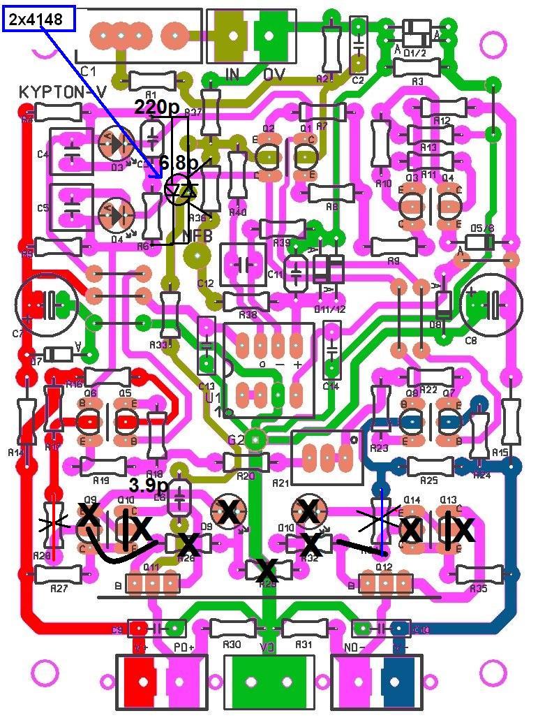

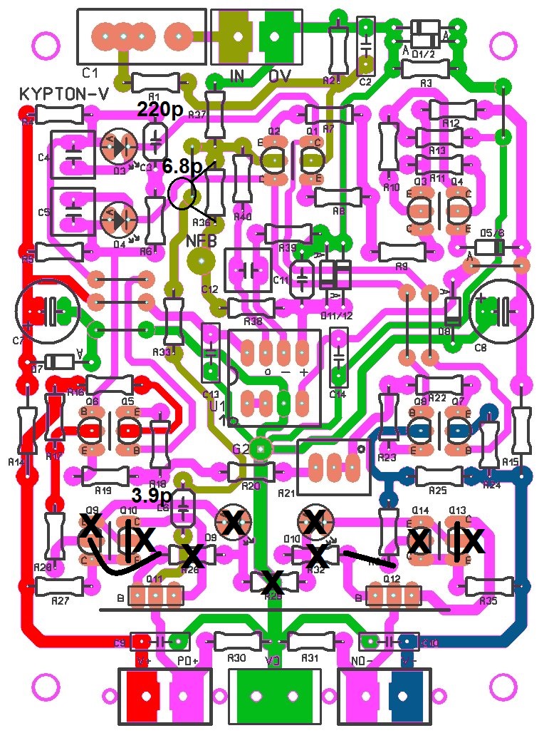

I haven't tested yet. These are the changes I made. Please take a look and see if I missed anything.
Thanks, Terry
look carefully
You're right. I forgot the diode clamp. I don't see Csp1 and Csp2 on your board. I routed things a little differently than you did but I hope, if you look at the way I did it, it will follow the schematic. I'll add the diode clamp tomorrow before I test.
