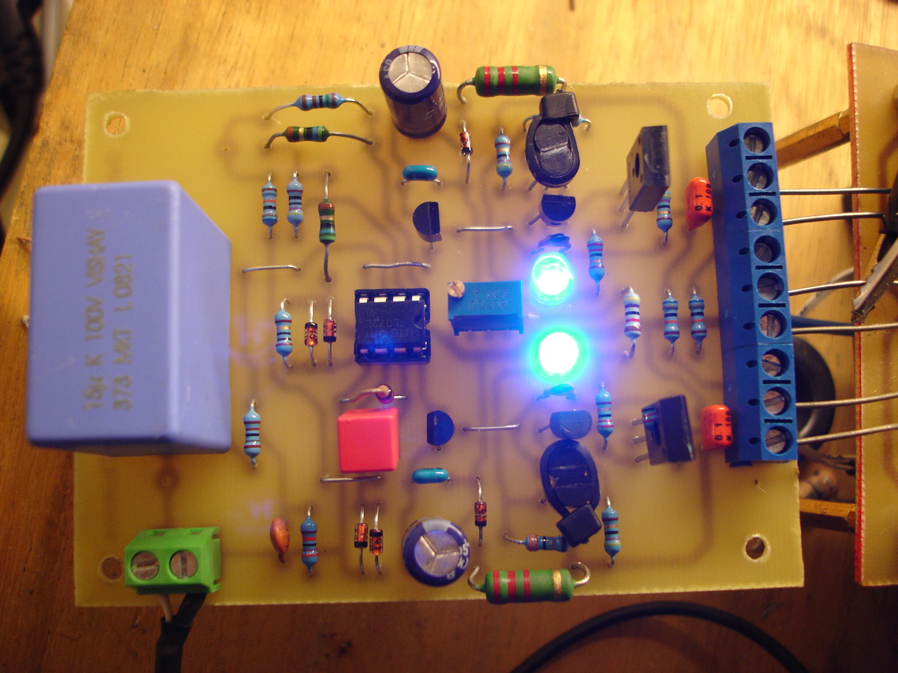

Thimios,

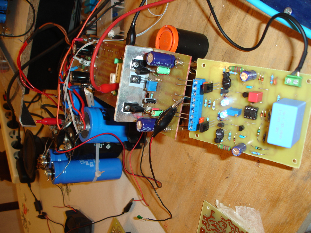

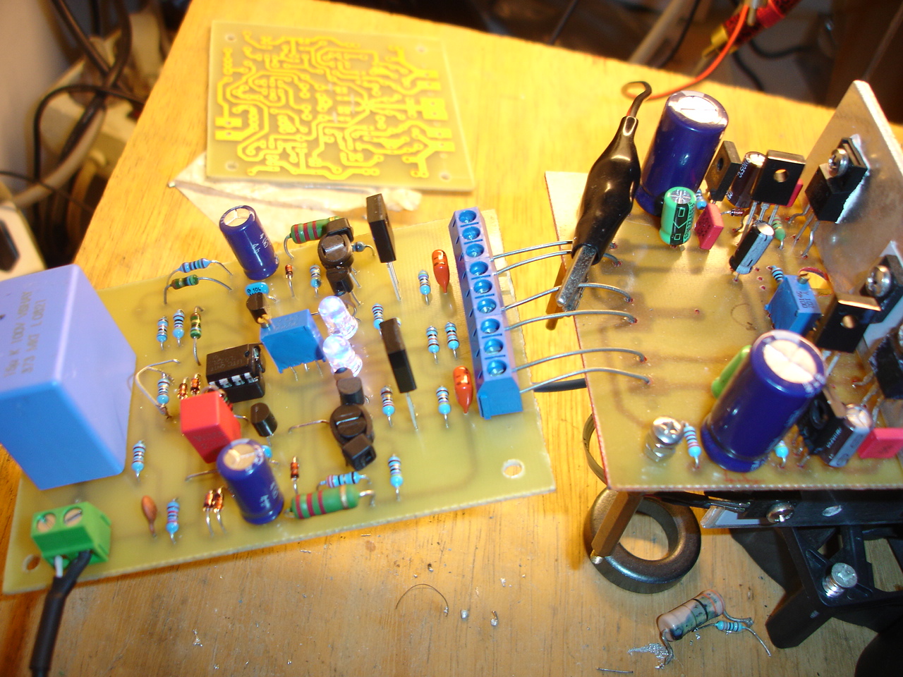

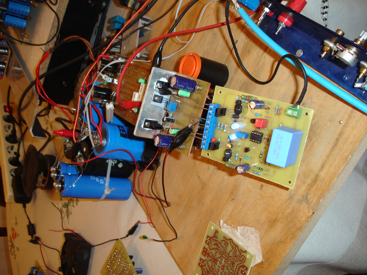

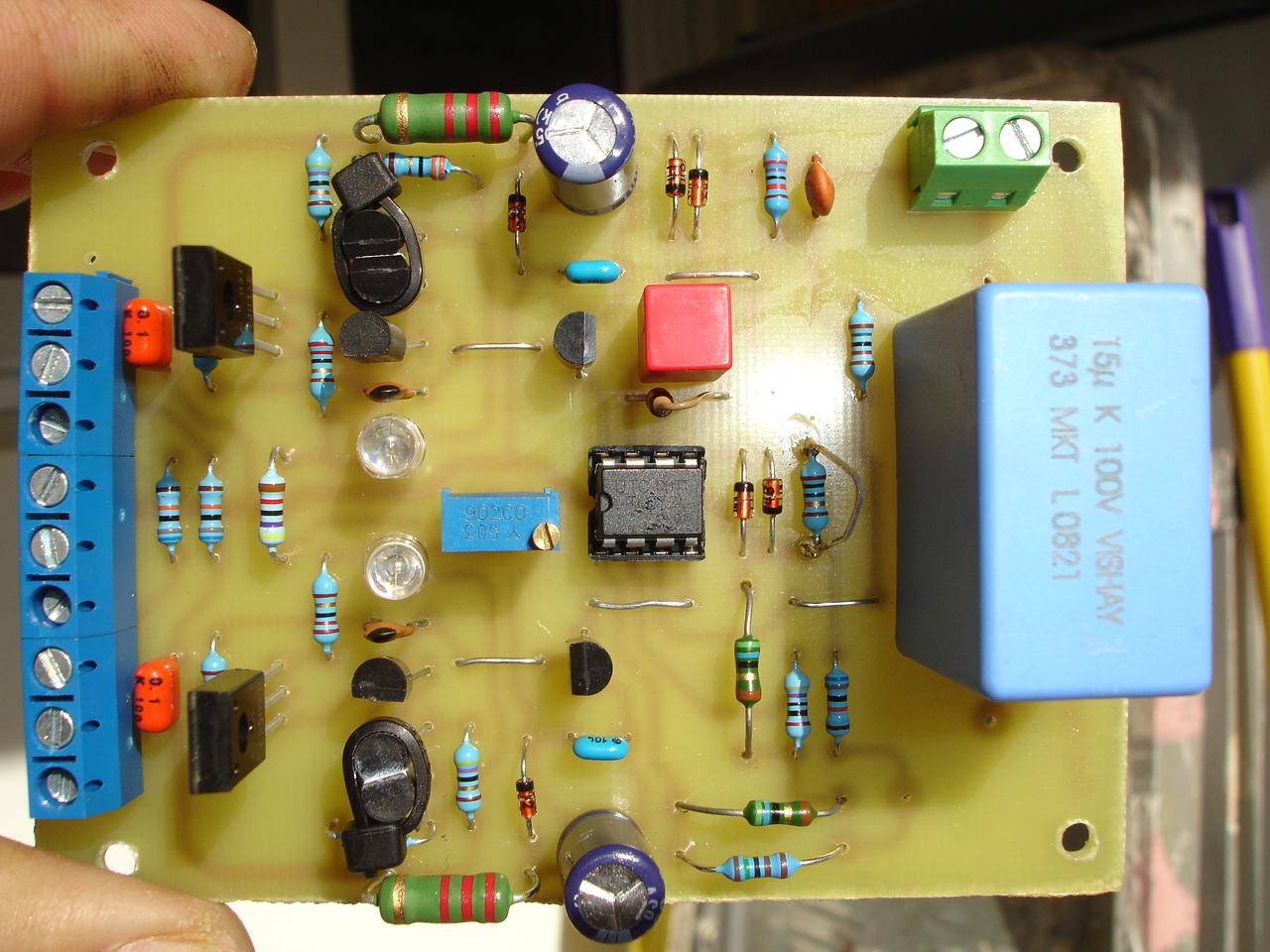

That looks like one of the simplest input sections to stuff and build, is this your favorite input section of all that you have built for sound quality? Thanks for all the hard work, you do make it look so damned easy. Nice work.
This was designed as a "intro" into the slewmaster "world". Maybe some
chip-amp builders would have interest.
OS
is this your favorite input section of all that you have built for sound qualityThimios,
No it isn't ,but isn't bad ,maybe with other i.c singing better .
I have test this for symmetrical clipping ,it is beautiful without sticking and saturation.
BTW which other i.c will work on this?

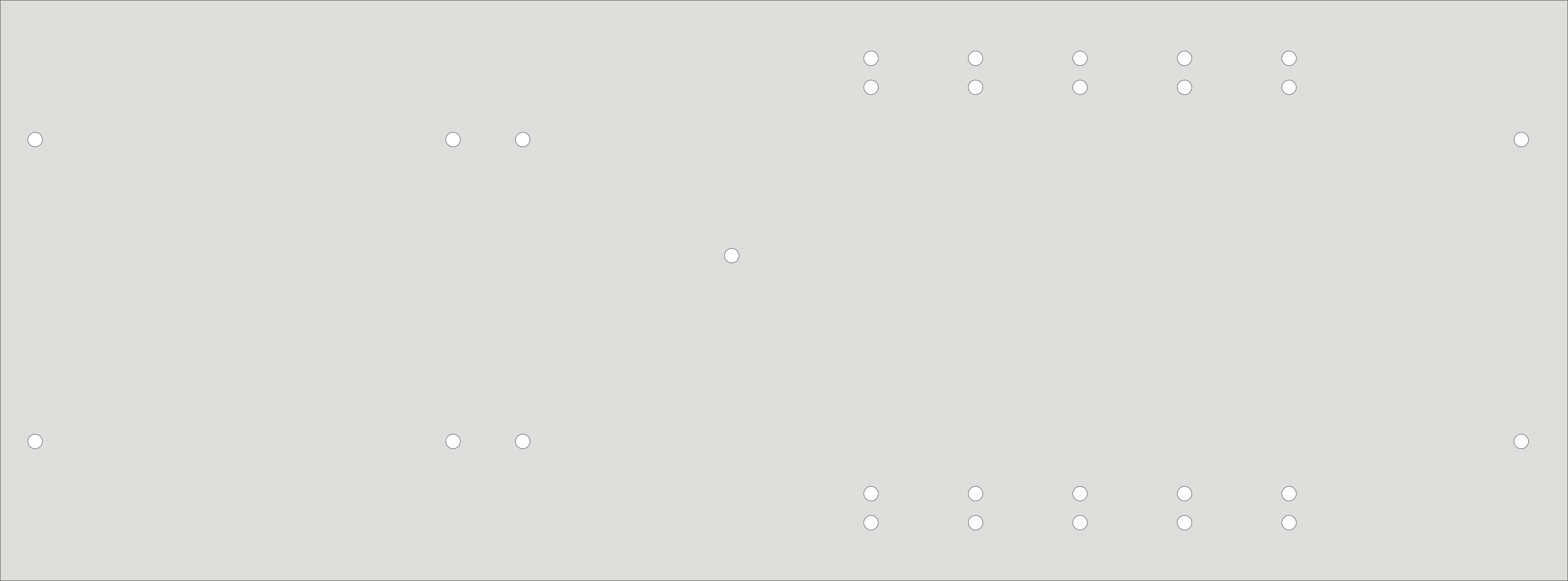

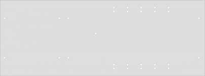

I notice you have slewmaster pilot holes on your "areospace" heatsinks.
Do you have a template for this (pdf/.bmp/.jpg). Would be cool just to
print it out - line it up.
OS
Here's a jpeg but you'll need to tile it or print on 14" legal paper

Any dual 8 pin DIP should work - watch the total current that the IC uses and
read the NOTE on the eyesee schema . ratio might need to be adjusted.

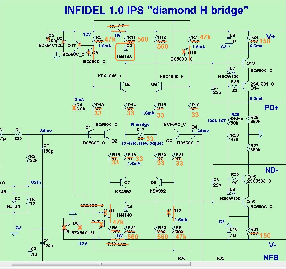

If i correct remember the current measurement for this tl072 is about 3ma.Any dual 8 pin DIP should work - watch the total current that the IC uses and
OS
I created drill templates >HERE<.
Is this ok?
Are all dual 8 pin DIP pin compatible?
2.5ma per individual amp. Which gives 5ma .
R6/12 ratio is 47/33R = 1.42
5ma from the IC gives 7.1ma on the VAS. subtract the 1.xxx ma
of the Hawksford LEDS , and your final 5.xxx ma will be at output.
If you are only getting 3ma total , your R6/12 ratio would have to be
over 2:1 (68/27R).
TI specifies 1.4 ma to 2.5ma(per amp) ... WOW ! You might have to go 68R for R6/8.

Check this schematic for errors. I did this to make it easier to modify the existing layout
Quite concise. But , don't forget to replace all BCxxx with KSA/C (B-C pin swap).
BCxxx can't handle rails .
PS - We'll get these "problem circuits". These... (Kypton V , Eyesee , Infidel) are not common
fare on the forum (NOT "blameless's" ). We will bring these excellent IPS's into the "mainstream".
OS
How about 2N5401/5551? No twisting required.
They should work , But but then the other 4 (Q5-8) would also have to be
the same devices.
That's what keeps the current stable over T - the device Vce/temp.
Bottom line - ALL Q1-8 HAVE to be the same family of (p/n) devices.
