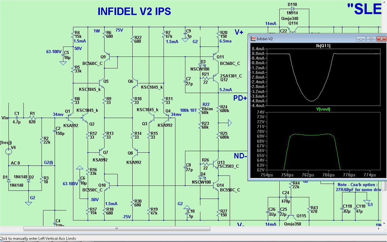

Belaji - look (below).
The "price you pay" for full power 5ppm ! (with the caps).
I knew there was no "free lunch" here.
This amp DID have very nice rounded clip.
OS
Add 470n cap make amp oscillated when clip but without cap, it "sticky".
Correct solution would be using lower VAS Re, since bypass caps do just that, lower Re - higher OLG, lower distortions.
No "sticky" ?? at a slight clip. but at 3V input - yes.
OK , the E staurt. mod did that. Back to the non "folded"
original version (below) .... nice rounded clipping again.
All these mods had a "price" (somewhere ??).
Analog design is all about compromise.

Try this .... with both overload and 4vpp (below).
-original with .22uF Re bypasses.
4ppm thd20 + perfect clip.

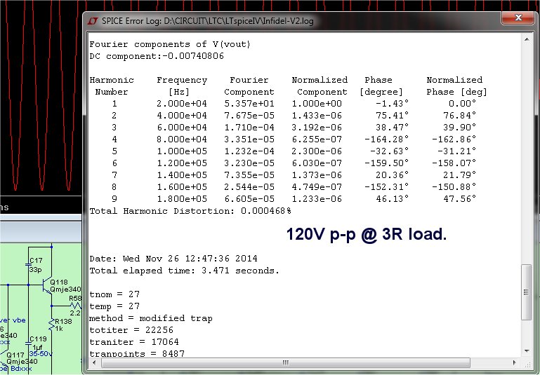

Do you think a super-pair would be worth trying after all the changes to the front end?
Screw the super pair
This "rocks" with 4ppm 120V + perfect clip.
I know it has (did have) perfect clip - Thimios abused the hell out of it.

Hmmm , this amp now REALLY performs (it's "sunk" in now).
Are there 2 feedback paths here now ?? , one to the VAS and one to the
input stage. Setting the bias perfect gives VERY low THD !

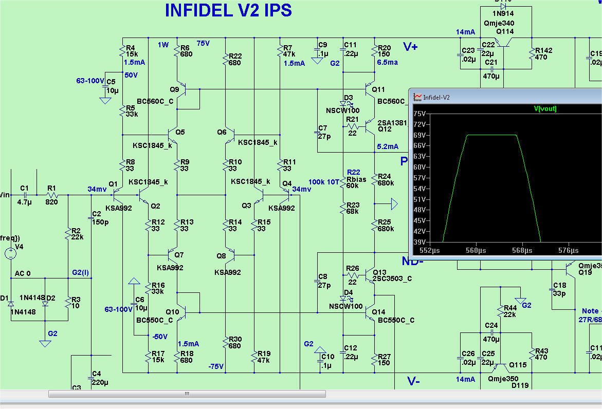

Everything has worked out
(below) is what I plan to prototype (PCB).
-Your contribution is "OPT1". A builder can set a jumper (note on schema) ,
and have that (folded) configuration. PS - 120R (R22/29) for re-establishing that
5.2ma in the "folded option".
-BV's idea is R4/5 - R17/18 - C5/6.
-Belaji's idea is to bypass the main VAS re's. This is "OPT2" , one could
either add them or omit them.
- Even my idea of mirroring the VAS could be jumpered out on the
Q9/10 pads (omit them / B-E jumpers).
The reason for all of this , even as it will not be too difficult to implement ...
is to "cover thy ar$e" and to allow for the event of "simulator divergence" ..
As far as performance - I can't complain about (below 2) @ 3R on the EF3.
Matches my TMC "wolverine" in this metric.

Everything has worked out.
