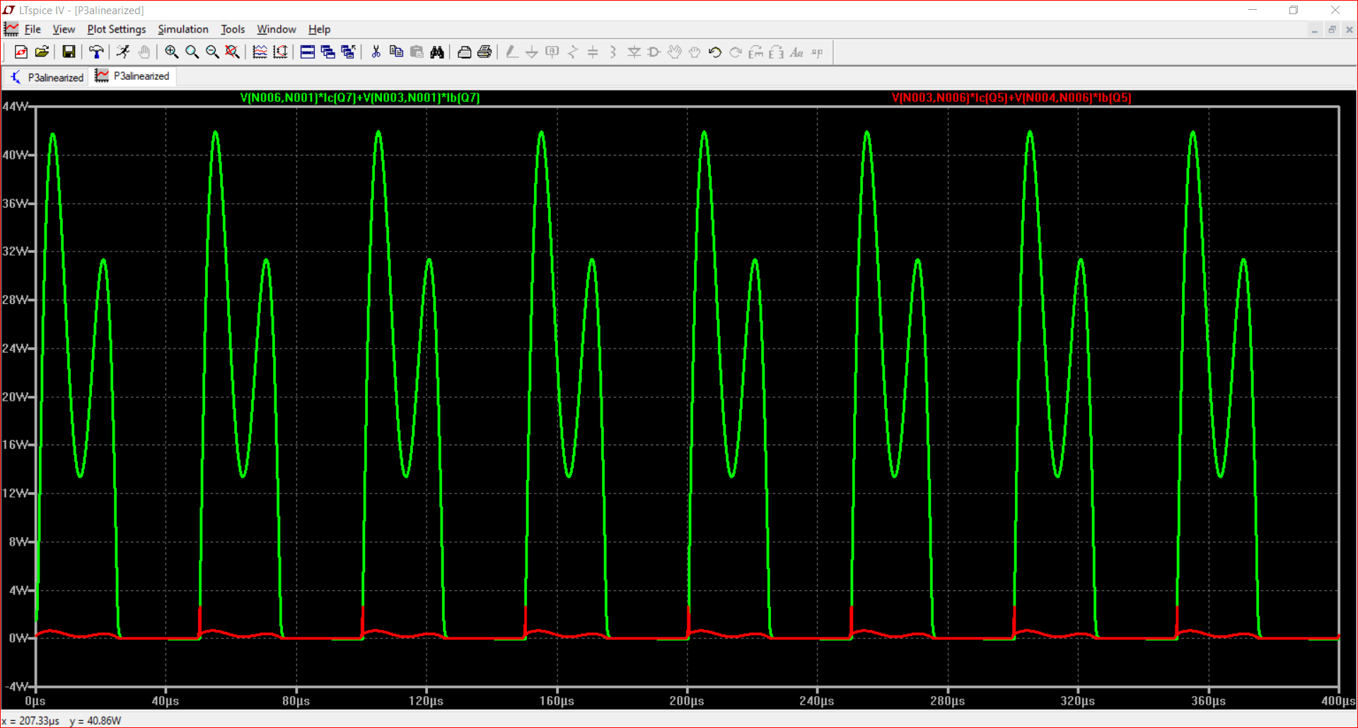

Q9 does not act as a Vbe multiplier in my simulation. The representation is of two series diodes which Rod Elliott tried and dismissed in a previous incarnation of P3A. This is less effective in controlling current than a proper Vbe multiplier.
I had looked at this earlier however that would have entailed reducing the bootstrap resistors in value from 3k3 to 2k2 to allow a Vbe multiplier to fit in without the influence of Q6 and C6 on the positive feedback connection from the bootstrap collector load. This arrangement being a blanket cover for various output transistors. I changed the Vbe transistor to a BD139 so this could sense the heat whether from the driver or the main heat sink. The comment about Vbe's is mentioned in the Silicon Chip article " bias stability in current feedback pairs is quite good even without tight thermal coupling" and "In practice VR1 (trim pot) is adjusted not to produce a particular voltage across the multiplier but to set the quiescent current in the output stage." In this instance the Vbe transistor is a few millimeters away from the main heat sink and not in physical contact.
A revised version with Vbe included is attached. The values in the base emitter connection need to have adjustment range set according to desired Iq.

You can test this in LT Spice. Do a DC sweep with the bias transistor tracking the output device temp. You will see that it overcompensates the bias as temp rises.

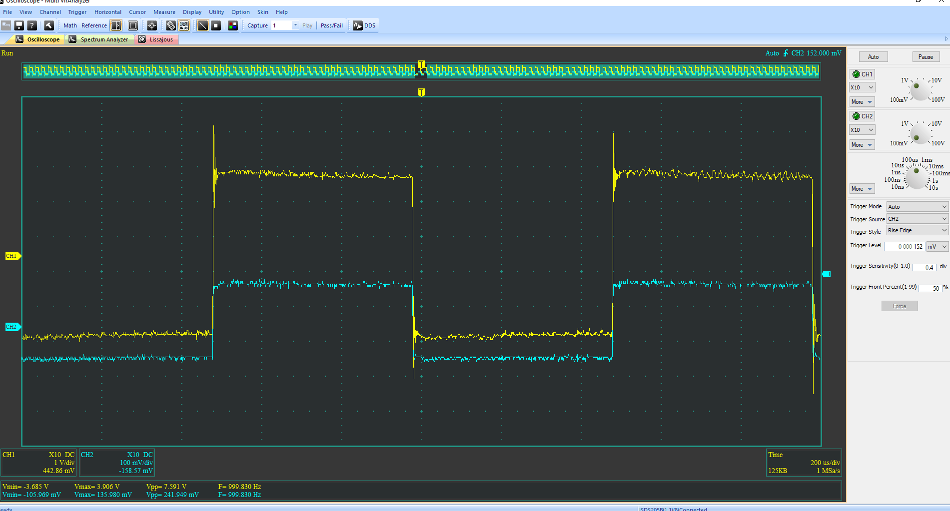

G'day Guys,

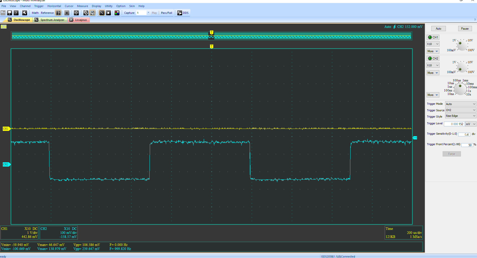

My new sig gen arrived so I fired it up. It does seem a little cleaner on the square wave,
The sine wave is about the same
So here is the output of the amp with the new sig gen.
1kHz square and sine. Things look much the same as before.
So I tried removing the cap across q9:
Not much change, perhaps the square wave is slightly better with the cap across Q9 removed.
Tomorrow night I will increase the size of C2 and see what happens.
![1khz sig gen square.png 1khz sig gen square.png](https://www.diyaudio.com/community/data/attachments/1138/1138717-5895a0739ccb1cd71b6be9d0449a07bc.jpg)
![1khz sine.png 1khz sine.png](https://www.diyaudio.com/community/data/attachments/1138/1138718-cfccf06a9de3e5e076e238c8a1ef7b7b.jpg)
![1khz sine right channel.png 1khz sine right channel.png](https://www.diyaudio.com/community/data/attachments/1138/1138720-17e0f846e326a1cba7b62891a2d679c2.jpg)
![right 1 khz square.png right 1 khz square.png](https://www.diyaudio.com/community/data/attachments/1138/1138721-963ed60b7bf82b74d50cfc2120b772d5.jpg)
![sine 1khz.png sine 1khz.png](https://www.diyaudio.com/community/data/attachments/1138/1138722-8b505390d1401bec2090ea8a9f1b89f8.jpg)
![square 1khz.png square 1khz.png](https://www.diyaudio.com/community/data/attachments/1138/1138723-ddf5c99a9bd8a2e62c63f9f71301caa8.jpg)
How does that stack up against the wave forms of your commercial amplifier.
The overlay of grass on the latest tests is no significant improvement. I have simulated the circuit as per post 1 and others have commented their builds have met with success.
If you have constructed the modules correctly which seems to be the case then there is an issue elsewhere such as the board you designed to house the power supply capacitors, and the general layout. I suspect the latter of the two and raised a couple of points in post 311 - these appear to have not been taken into consideration.

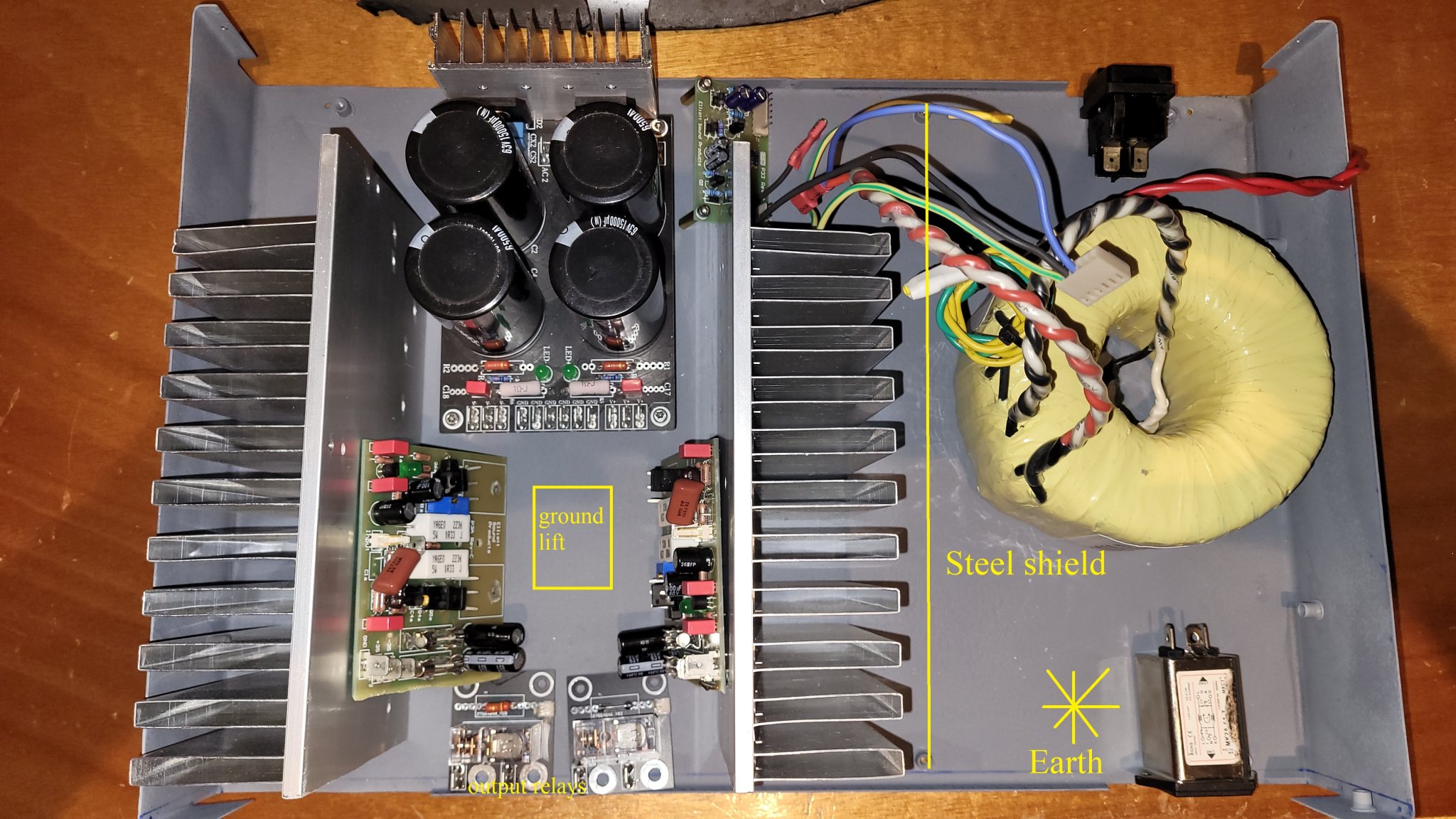

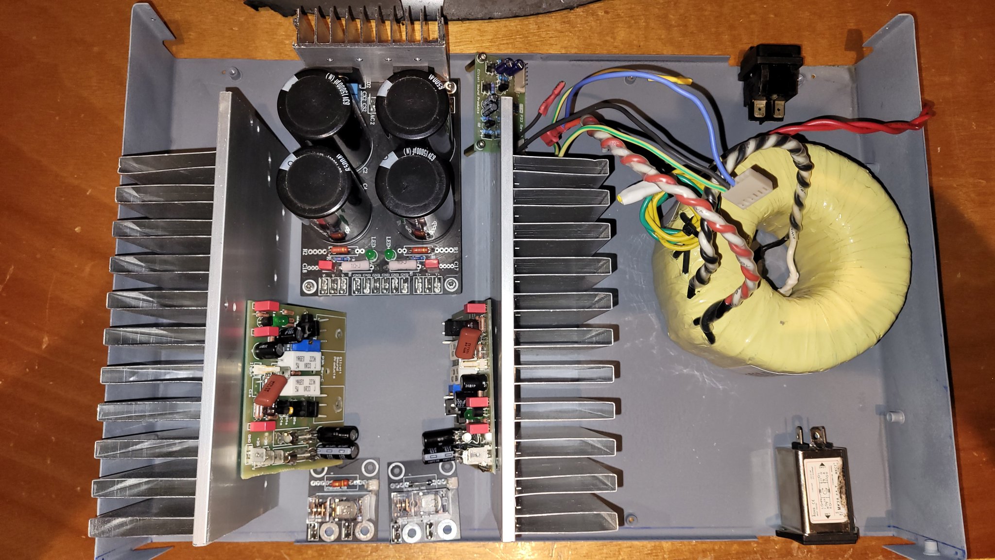

Here's a draft layout.
I think I need to flip the to amp boards around so that the power supply connections are closer to the PSU output. That way the input wiring doesnt have to cross the psu wiring.
I am waiting on a ground lift pcb to arrive. It makes sense to me to place it right beside the PSU output.
As indicated in yellow.
I will fold up a steel shield to go between the mains side and the signal side as indicated in yellow.
![20231109_215826.jpg 20231109_215826.jpg](https://www.diyaudio.com/community/data/attachments/1140/1140601-06dbc5f288e39a5b96e108366bbd440a.jpg)
![p3a layout draft 1.0.jpg p3a layout draft 1.0.jpg](https://www.diyaudio.com/community/data/attachments/1140/1140602-7076ebbd62c67b71ce577a5869039bdc.jpg)
