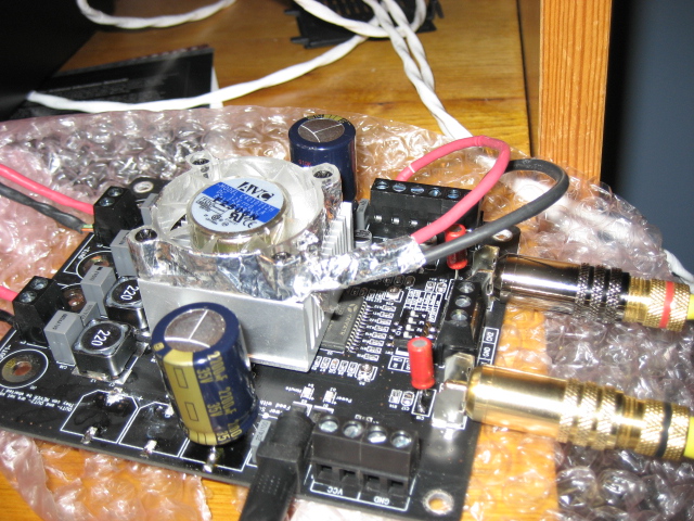

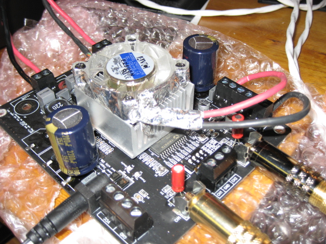

A few days ago I posted that although I had placed the fan on the amps heatsink on a separate battery and regulator I could still hear some residual noise of the fan through the speakers (very low level).
I thought at the time this was caused by electrical issues, maybe the radiation being picked up by some part of the board, so I tried caps across the fan inputs, re-routing the fan supply wires, but it now seems to be not the case.
If one presses the heatsink pushing it harder against the chip, or indeed just holding the heatsink between thumb and forefingers the noise is gone. In other words the noise/vibration of the fan is somehow mechanically picked up by the chip and them amplified.
Further checking shows that If I tap around the board with my finger nail with my ear to the speaker drivers I can in fact hear any noise my finger makes amplified through the drivers. Once again this is at a very low level but it makes one think.
I suspect that as the heatsink is basically spring loaded to the chip the contact is not as good as it could be at the interface, (probably not ideal for heat dissipation purposes either) and this may be the cause of the issues minor though it is.
If somehow these amps are microphonic then at high volume levels or when the amp is placed in a speaker cabinet to drive the speakers direct we may in fact be getting some feedback at certain frequencies colouring the sound which would not be heard at idle or low volumes.
It might also be an issue with large coils as if they are simply flopping in the breeze they will provide a potentially large vibration source.
I will look into ways to de-couple the fan mechanically and perhaps get a better connection of the heatsink and then see what residual vibration effects exist after that.

I can confirm that the heatsink fan is audible through the speakers. When I stop the fan with my finger, the buzzing noise goes away. When I release my finger, the pitch of the buzzing rises as the fan spins back up. So the two are linked.
It isn't a big deal, but it adds to the background noise you hear when the amp isn't receiving a signal. Maybe replacing the fan with a bigger heatsink is the solution?

What's the approximate pitch of this "buzzing noise" you hear? 60/120 Hz? Or higher? I don't hear any such thing and I have 96dB/1W/1m speakers. Do you have the volume cranked up high when you hear the noise?

The volume is turned up to a moderate level on my 90db speakers. The pitch of the noise changes with the speed of the fan. I can hear it even when I disconnect the audio cables. It's not particularly loud, and it might not even be audible on less sensitive speakers, but it's definitely present in the background.
It might not be an issue with all boards. Mine has the grey heatsink with "MSI" on the fan, and I received it just a week ago.

Hi Sendler My fan is the later ones not the blue one, but it is running off a totally separate battery, so PS doesn't some into it. As far as the noise of the fan itself, it is very quiet, what is able to be heard is a sound that is quiet mechanical in nature though the speaker.
I must emphasis this is very very low level stuff, but I am totally anal retentive when is comes to getting the cleanest sound possible, other wise I would never have built a totally off the grid system (including analogue and digital front ends). I know most folk will never hear a lot of this stuff but my philosophy has been totally eliminate all noise and then optimise from that point on.
There is some low level circuit noise and that will certainly be dealt with but the fan noise is a little louder than that but it is quite possible those listening to amps fed via SMPS will not hear it as it would likely be buried beneath the increased noise of the power supply
I feel that the microphonics (if we can call it that) is indeed related to the heat sink, which is spring loaded to the chips, there is in fact very little effort required to wiggle the sink against the springs. I suspect the heat sink chatters against the top of the chip in sympathy with any external vibration and somehow this translates through the system, by means unknown. Pressing down on the heat sink kills the noise totally.
My intended solution is to A) remove the fan from the top of the heat sink and mount remotely above the chip. B) place small slivers of rubber or balsa between select fins of the heat sink and C) lastly find a way of adding extra pressure to the heat sink without causing any problems with board distortion etc. I will also ensure that all connections, coils and caps are very firmly mounted to the board.
Washers - put them on the underside of the board and poke the push-pin through them

For me the MSI fan buzz is there with no source connected and lowest gain, the frequency follows the RPM of the fan and I suspect it to be the same numerical value.

Your passive volume control and internal wiring is picking up the noise. The easiest and cheapest thing for us all to do is change the heatsinks to a slightly larger passive such as the $6 Zalman.
