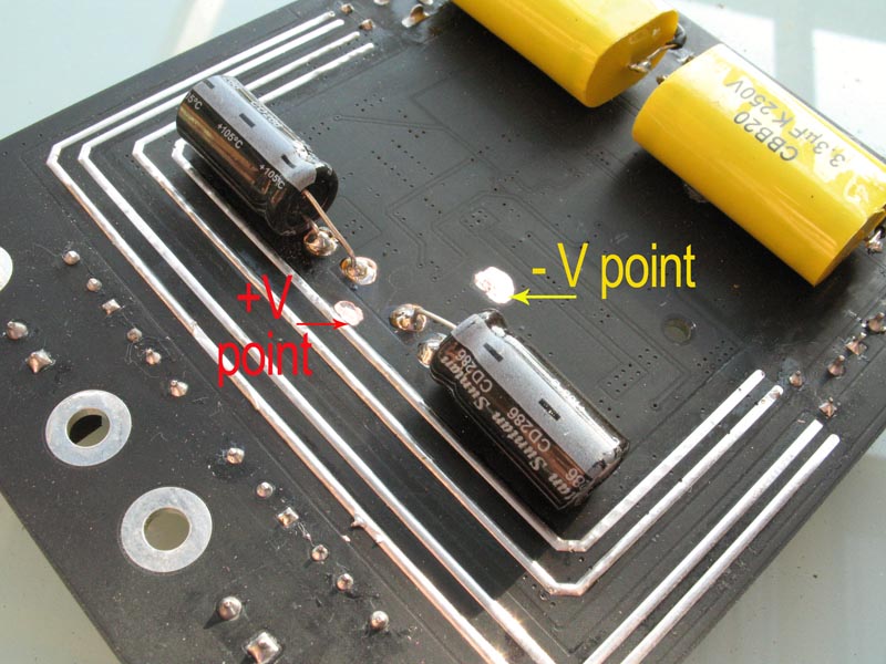

I have now got the 100hrs up on the board so I have taken the opportunity to add some capacitance at the chip, a pair of 470uf/35V ESR caps soldered under the chip, (see pics) and a pair of 1000uf caps in tandem with the std ones on the top of the board. At this point I would say there is some additional tightness to the bass and better attack on notes, not a huge change but worthwhile. Time to let it run for another 15 hrs or so till the coils are added.
I am planning taking power right to the star point between the chips and the earth to the point marked on the pic. I feel the board layout is a bit of a mess and there must be return paths running all over the place in less than ideal arrangements.
I will run a separate power lead to the 5v reg so it is not passing through the board traces, this will come later.
Basically trying one thing at a time to see the results of each step, if any.

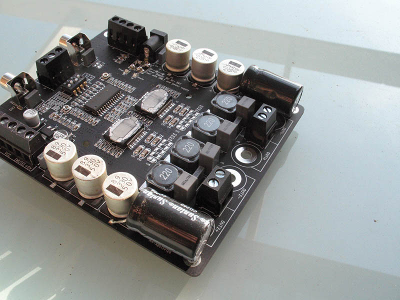

Suntan, interesting brand of capacitor.
It's most probably Chinese and not the common English word.

PSU and input caps...
First I putted 3.2uF Philips MKT caps and 18k resistor. I was not happy with this combination. Yesterday I putted 2.2uF Wima 100v MKS4 caps and 20k resistor. It is much better combination for my system and ears. I am using Monitor Audio RS6i (89db speakers 6Ohm and FE127E diy).
Also simple PSU with two 18000uF caps is better than switching PSU. I am waiting 10uF couls to arive. Then I will continue with mods. Actualy I am very happy with results of just changing input filter.
Great board and sound. I putted in box with volume pot and PSU is in external box. I will probably put biger but passive heatsink. I dont like moving parts in amp :-(
Well said

Hi DV, I took the heatsink off this morning it just clips out, there was paste under the sink, but I added a little more. I tied some copper wire around the nylon clip on the underside of the board and increased the pressure a bit but have not tested it for fan noise/vibration though I have since ran the amp for another 8 hrs. It has 108 hrs on it now.
At this point I would say the amp is very smooth and nicely balanced, there is still some micro grain in the mids which I suspect will disappear once the coils are added. There is certainly no issue with resolution, quite superb in that area.
I have star wired the power supply this evening and will fire it up before I go to bed to check. Currently have one of the Helder 2020 mk 3s burning in, actually it sounded sweet from the first minute!
I won't split off the 5v regulator supply till I have fully tested the current set-up. I expect there may well be some gains to be made there, possibly a pre-regulator down to say 7.5v and remote cap bank could help.

I have now powered the 5V through a separate cable still from the same battery, interestingly it does seem to make a change to the bass, a bit tighter and fuller, I must say though I have no idea why and did not expect it to do this, overall it just seems a little more dynamic.
I feel the amp would probably benefit from a ground plane below the board, this I feel will lower noise. I have a Helder 2020 mounted on a copper ground plane it is utterly dead quite, no hiss or anything else, I know from experience with other amps and dacs that a close coupled ground plane has benefits so that is what I will do next.
Still no coils added, I want to square everything else away first.
