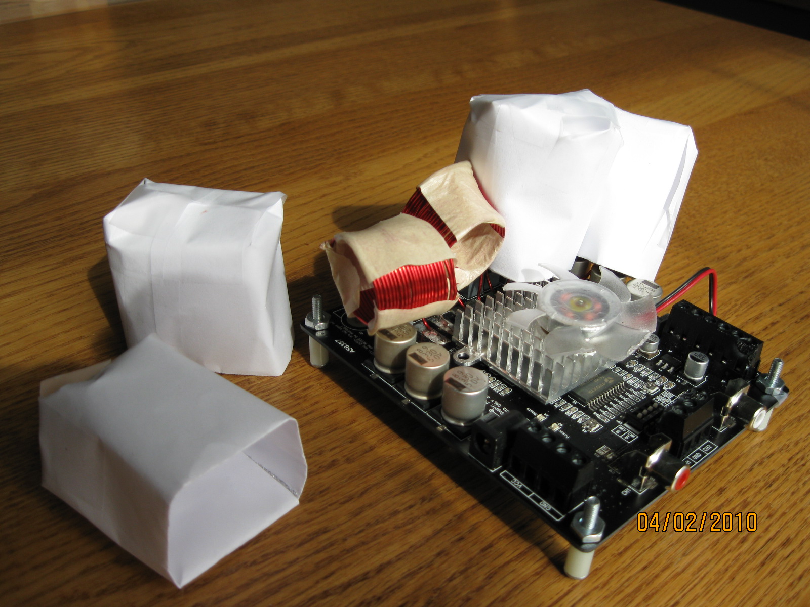

Dr Vega,
Would you mind posting a picture of your air-core inductors with paper and tin foil shields? In fact any pics of your amp would be cool. Also, bypassing the PIOs with the Daytons means you are running them in parallel?

Yes, bypassing caps means running in parallel. I'll try to get some pictures, I tried a while back and couldn't get anything worthwhile, but I have a new camera now.
I've stopped using the tinfoil shields. They smoothed out the sound too much. I don't know why, but they have a significant affect on the sound. I need to try adding a ground wire to them.

Well let's see if this works. This is the first time I've tried to upload pictures. One picture is the front of the board with the air-cores (held together with masking tape) and the tinfoil/paper condoms. There are no input caps installed in that picture. You can also see my cute little frameless fan glued right to the stock heatsink.

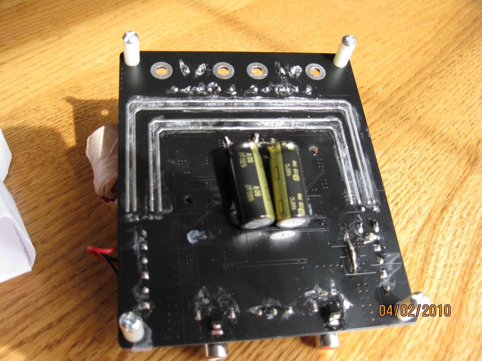

The back of the board shows the Panasonic FM 680uF tank caps and the fattened negative return trace below them to the left.
-dr_vega
That should be "return trace below them to the right."
