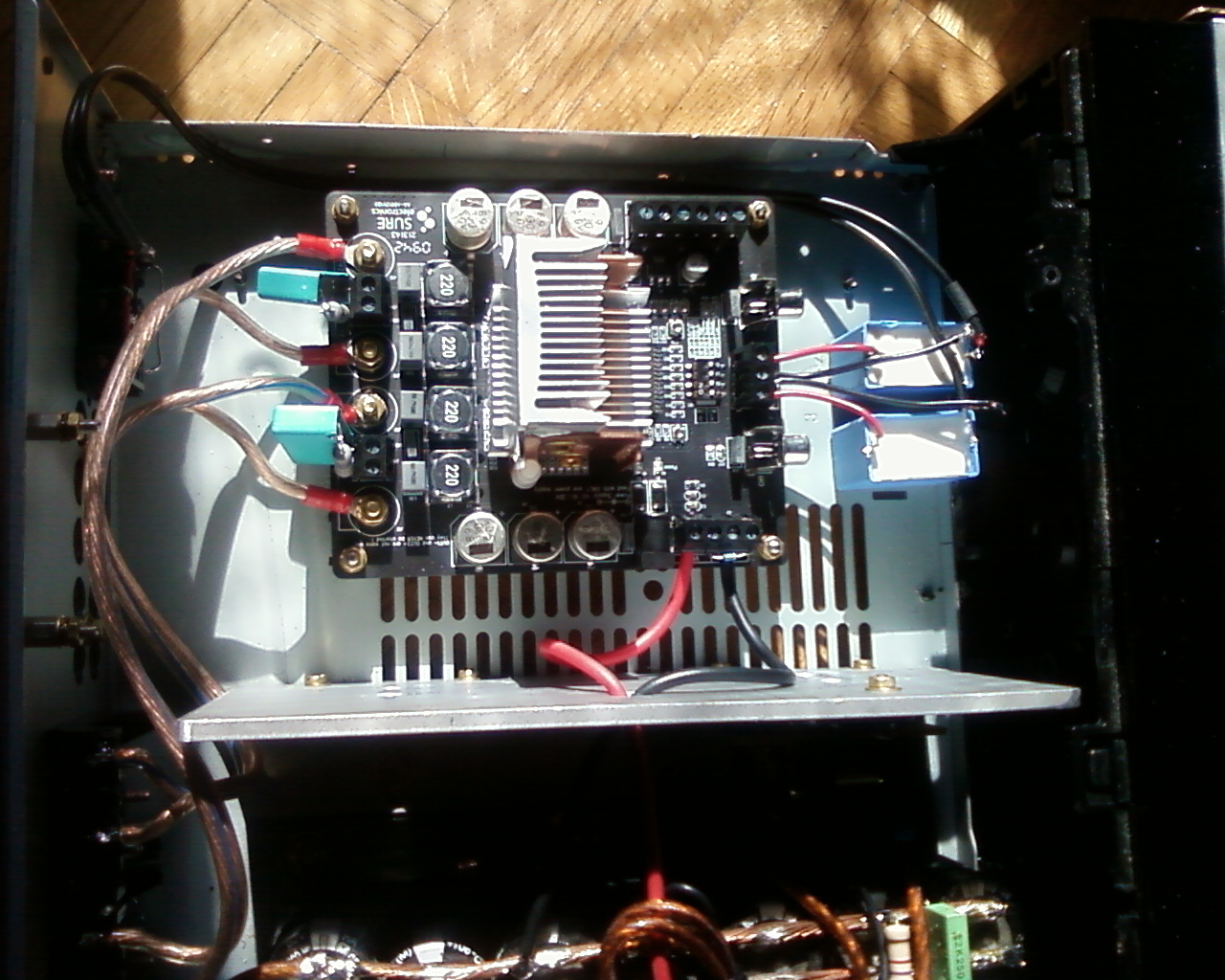

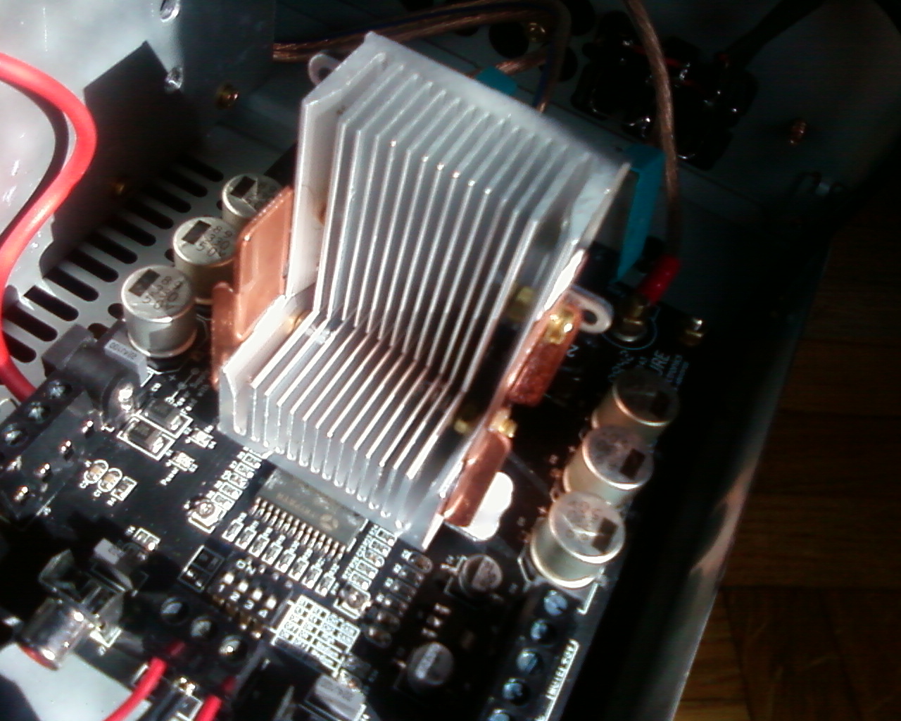

Hello,
i think trying another air toroid is a mistake,the wiring out the board can not provide good results,i've try to build UCD clone,the layout was the basic error.
otherwise:
for the tk2050,
noise is comming from the fan ,it's obvious
the best and easy way is to connect the fan ground dirctely to the 0 V supply.to avoid common impedance.
when the kit comes,we can easily transform the heatsink.
there is another heatsink whith a fan,i've screwed it with the another (without the fans )
i'm still listening whith it,temp is about 45° with 25° ambient temp.
very good amp for the price.
