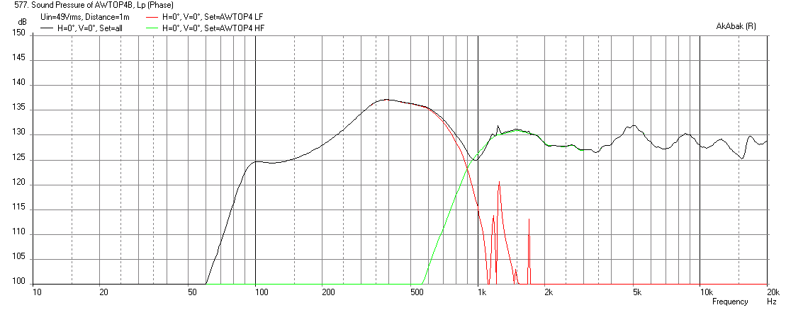

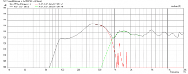

its "Acoustic Power" from HR that matches Akabak acoustic power.
Correct.
Hornresp and AkAbak acoustical pressure responses are different at higher frequencies because different directivity models are used. AkAbak assumes a 'Radiation Cone' whereas Hornresp takes the actual flare profile of the horn into account.

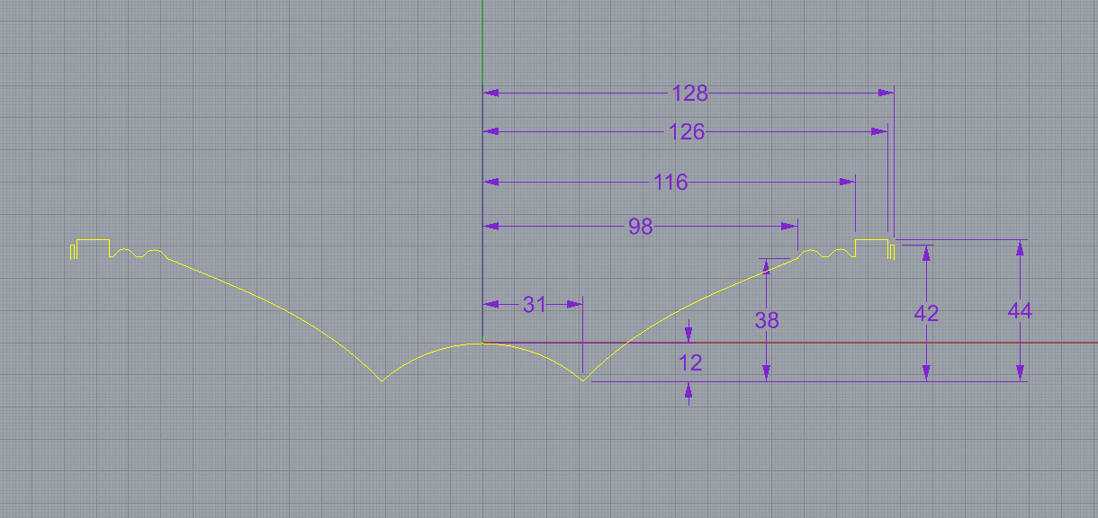

10CL51 profile
Makes me wish I had a 3D scanner, but this way is fun too
xlim on the 10CL51 seems to be 7-8.5mm absolute max.. At that point it felt like it might rip. Good thing this is a dead driver!

Thanks for the profile JG. Pray tell how did this 10CL51 meet its demise?

I knew that would eventually come up, haha. Well actually the driver is not "dead", a friend decided he did not want to care about the speaker area whilst lifting the rig off of a vehicle and crunched the dust cap. This was before I knew much about repairing things myself and I deemed it "dead" when really all I needed to do was lift the dust cap from its crunched state.

Nice work on the profile! From the picture of the cardboard cutout, looks like the gasket extends only a few mm from the double roll.
On the right side of the profile, you show 42mm from the dustcap/cone juncture, could you please also include the gasket and basket rim, and if the gasket is "squishy", by how much when securely fastened?

If the 10CL51 surround were to be straightened out (as in driving to Xlim), it's length would increase to about 22mm, which would appear to allow almost a 20mm distance above the 38mm/98mm intersection point. An 8.5mm Xlim seems very little for a speaker with 6mm Xmax, generally most modern PA woofers are built for Xlim being around double (or more) Xmax.
When you measured 8.5mm forward, did you pull the surround or spider flat?

You caught me just in time! I was about to go to bed. I know you were hoping to get started today though so I went ahead and added the details- hopefully I got 'em all!
As far as xlim, I might be getting 10mm out of it using both hands. The surround does not seem to want to stretch flat, almost like it's got tons of glue that keeps it holding its shape. The surround is like a hardened cloth, not that flexible.
On a scale of 0 soft as heck to 10 hard as a rock I would rate the gasket about a 7 or 8, it really doesn't want to squish much at all- definitely no mushroom action on it. I think the metal casing would bend to heck before that foam came down more than a fraction of a mm.

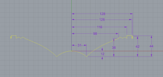

Here are the new measurements. I made some good adjustments to the surround and added the gasket and metal casing. It's another mm more accurate and I triple checked for consistency
I bet that surround works more like a hinge point rather than a linear motion like a half roll rubber surround - which would definitely need more clearance. I am thinking 2 mm of motion at the stiff surround is sufficient to get 12mm motion at dust cap. Easy to check with a straightedge across the top and use hands to push surround and cone forward until cloth surround touches. Probably can't be done very easily by hand as that is a whole lot of magnetic force circa 50 volts plus on a 12 Bl motor. I gotta imagine that he spider and surround are stiffer than heck to withstand that kind of motor force.
To be safe it wouldn't hurt to put a 5mm deep spacer or router a channel into the mounting board for safer clearance.
Thanks for doing this JG. Very accurate results are nice. Why don't manufacturers provide this info on their data sheets?

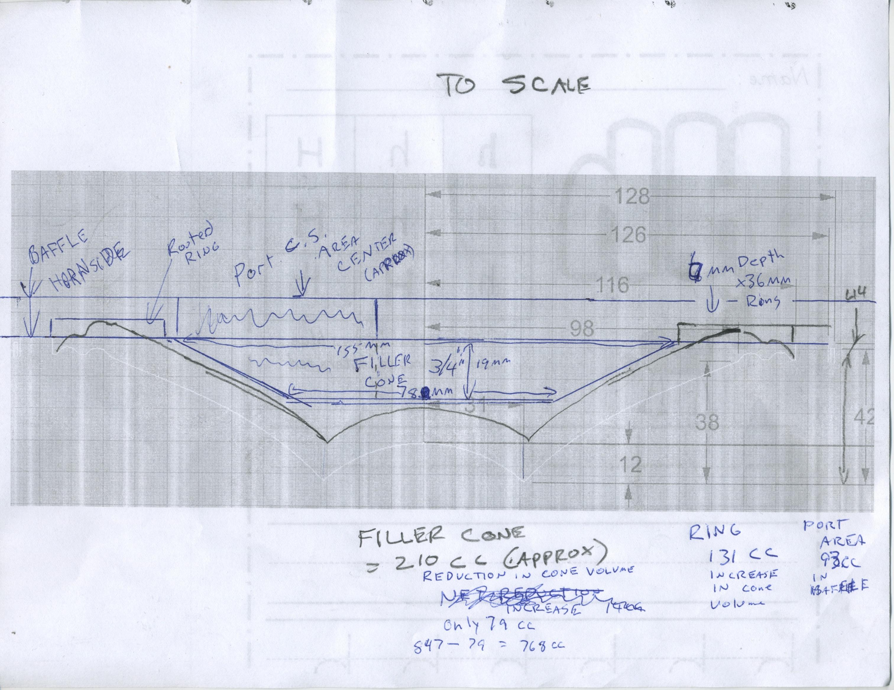

I plan to rout a 6mm x 36mm channel to prevent the cone or surround from hitting the baffle, unfortunately that adds about 131cc to the 847 cc cone volume (thanks again for that info Jenny).
I will mill cone fillers from plywood with the baffle side dimension 155mm, cone side 78mm, 19mm deep, approximately 210cc. So it looks like the VTC (per cone, x2 for Hornresp) will be in the range of 768cc- not good, sports fans .
Conforming to the dust cap contours exactly would make little difference in the volume reduction.
The relief channel has to be routed before the horn is assembled, and I will be testing the HF horn before the 10" BP ports are cut, so position and size of the port holes influence on frequency and polar response can be tested. Fortunately, the cone filler will allow multiple shapes and sizes to be tested without having to junk the horn.

Considering the bass reflex two-way SyntripP will have roughly 1536 cc ATC (between the two 768cc BC H10CL drivers using a cone area filler), what ATC (and length) would you choose?

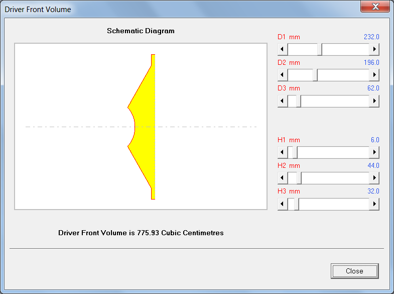

Hi Art,
Based on the dimensions given in Attachment 1, Hornresp calculates the cone volume to be 776 cc. Because the surface of the cone is curved, the true volume will be slightly less. The actual volume is therefore somewhat smaller than the 847 cc figure you are assuming.
Kind regards,
David
Hard to find in the HR docs, though.
Search for references to Ap1 using the File > Find tool in the Hornresp Help file.
Except that Jennygirl measured the volume with water - maybe that includes height of foam gasket?
In any event, I think that the tool in HR can be used to design a conformal plug with say 10mm of clearance to estimate the volume reduction ( sans flow duct cutout). I think 450ml net volume should be doable as 510cm2 x 1cm=510cm3. 850-510=340cm3. That leaves 110cm3 for the duct cutout. I think Weltersys' generous cutout donut to allow surround clearance is too generous - make it a shallow 5mm deep and only wide enough where the max extent of the cloth accordion would actually touch in max excursion.
