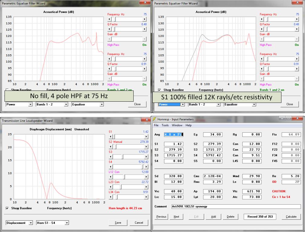

Also just discovered ability to model filling horn with absorption. I played with that and it cleans up the response even more, as you can see on the attachment. I have no idea why the SPL in my sim is so much lower than in XRK's (?)
I wish I could move as fast as you are going but I don't have the experience to know where reality will be better than predicted by HR and its lots easier for me to find time in front of the computer than out in the garage sawing wood.
These posts of mine are just part of my learning process. I'm seeking confirmation/explanation of the apparent discrepancy or problem that I see. I'm certainly not trying to teach anyone other than myself. thanks for your response
I have never worked with Akabak, so don't know why xrk97's sims look so different from the Hornresp sims, though he is using smaller offset ports, which increase upper response.
Filling S1 with absorption would kill the HF response of the HF driver which shares the horn, so forget about that feature when modeling a Synergy 😉.

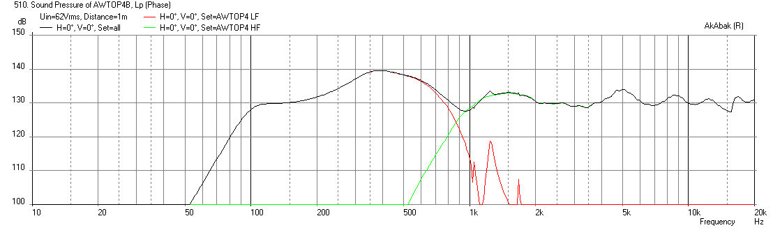

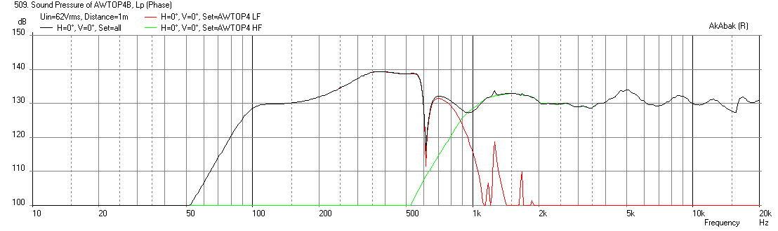

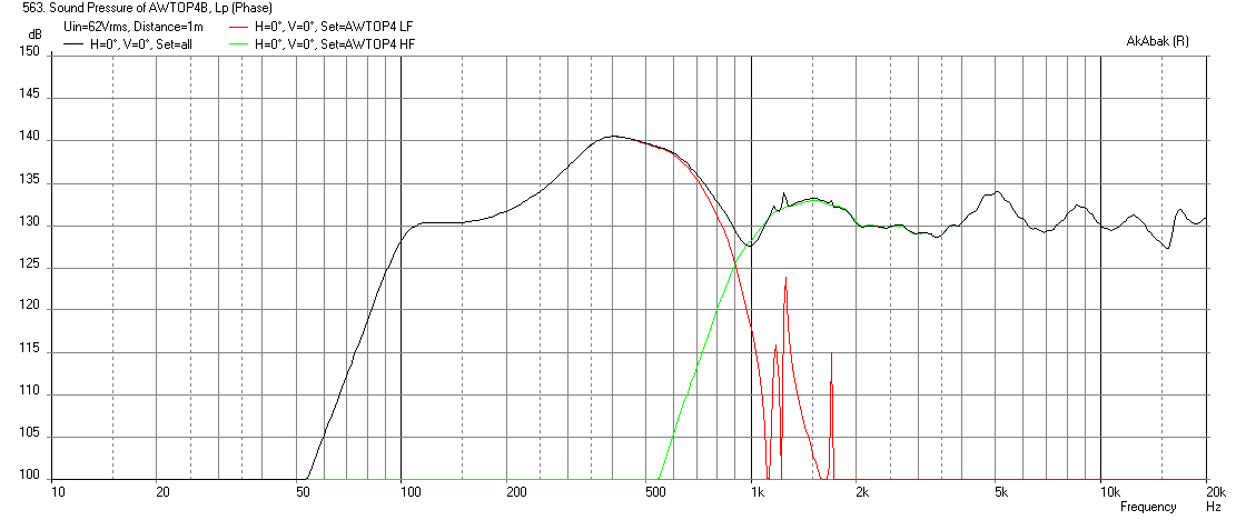

Please show me which plot and what freq region you are talking about for the discrepancy. Are you modeling 2, 3, or 4 drivers? How do you have them connected? 2 and 3 drivers are all in parallel so sensitivity at same 2.83v will be higher as impedance drops with more drivers. I calculate max SPL by setting drive voltage to hit xmax of 6.5mm.

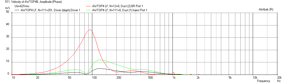

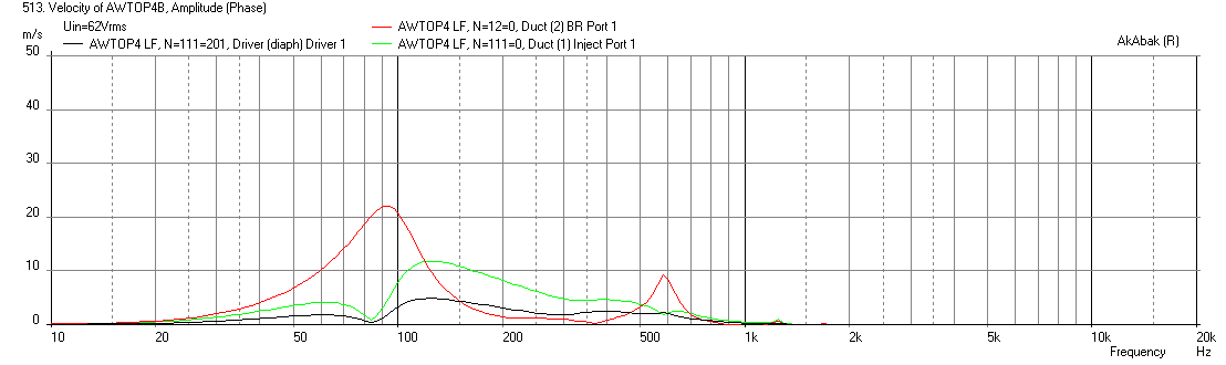

So I want to use smaller ports also. How would I choose port size? Apply a maximum port particle velocity limit at reduced velocities due to crossover HPF? What limit would you suggest?
Look at overall response shape and adjust port size to get as smooth as possible, check velocity at ports to make sure less than say 20m/s to prevent chuffing and port compression. I think some people may even say 30m/s sec is OK. In looking at this more carefully, I see that Weltersys' use of 5.25in dia ports gives a max velocity of 12m/s at xmax for 3 drivers while a 3in dia port gives unacceptable 35m/s velocity. The BR ports at 3in will also have high velocities so it may make sense to to with longer 4in dia equiv CSA but longer ports.
Edit - checking effect of BR port dia on velocity and freq response.
Nothing is simple... Here is the freq response and port velocities for 5.25in dia offset ports with 3in dia BR ports - BR port velocity is very high at xmax but response is smooth:
Here is freq response and port velocities for 5.25in dia offset ports with 4in dia BR ports - now velocities look reasonable but the freq response has a big sharp dip - not very good and really messes with the XO point. I am not sure what is causing this, but it may be additional out-of-phase resonances from BR port interfering with main output causing cancellation dip? I would take chuffing at xmax (peak excursions) over a nasty dip like this:
I've posted the HR input parameters as well as SPL for my sim back just 3 or 4 posts. 2 drivers in parallel. the SPL plots are with max excursion of 6 mm.
I would ask the same questions of you. In fact I'd love to see your script as I'm sure I could learn a lot from it.
I'm getting only 115 db at 150 hz in 4 pi space while I think the last sim you posted was >125 db
I am not a HR expert, but I recall sometimes there is a discrepency in SPL and it has to do with whether you are looking at power or pressure. Tb46 can probably answer this. I know that Akabak's calcs of SPL (pressure and freq location) for the main bass "knee" region is very accurate as I have seen in measurements of speakers I have designed.
For 2 drivers in parallel, I get 125dB at 150Hz for 6mm displacement with 54.5 volts.

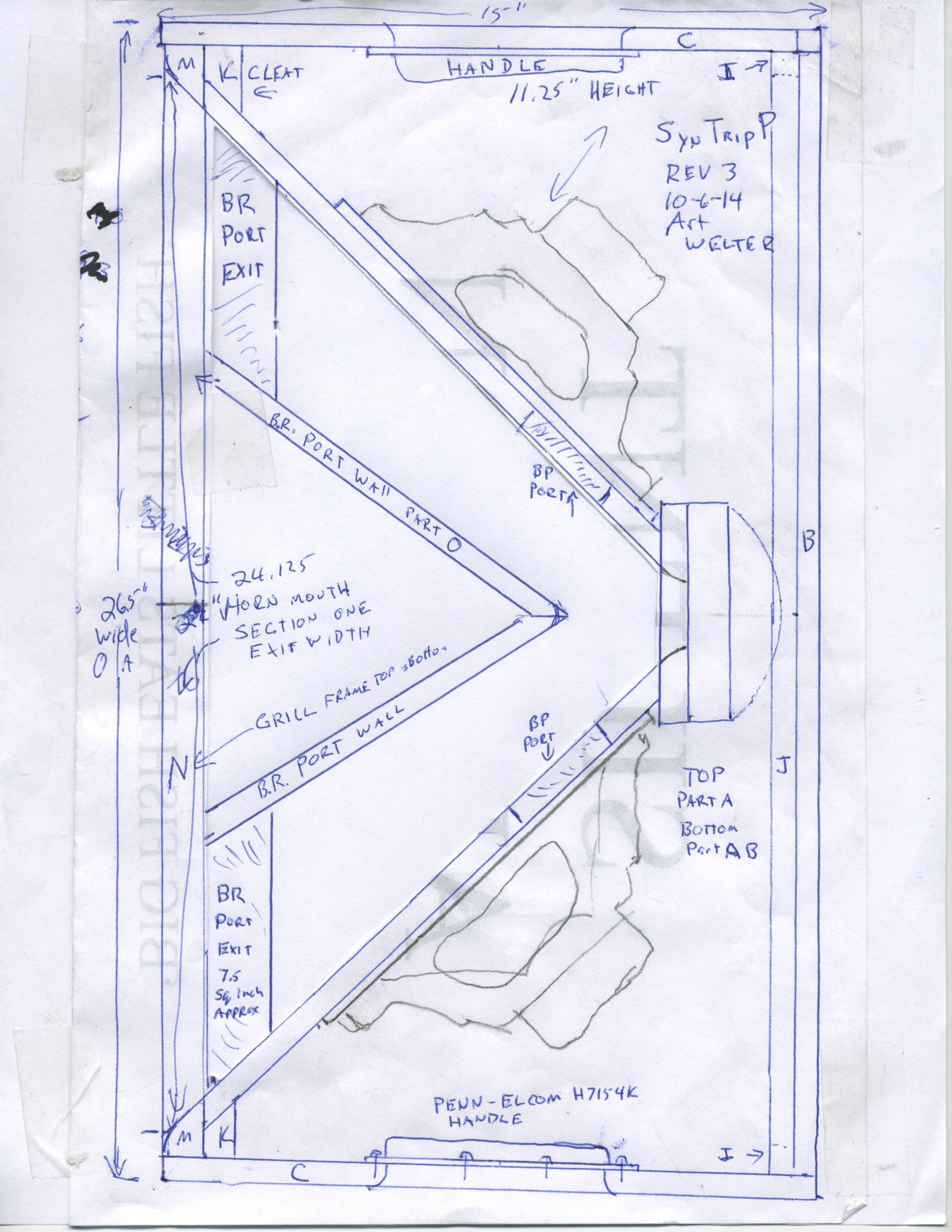

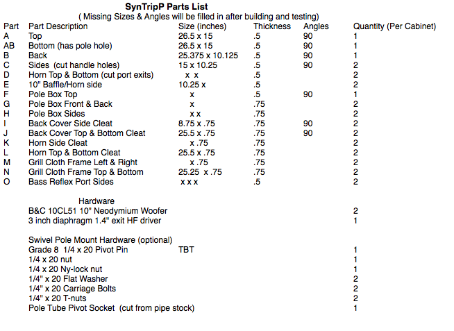

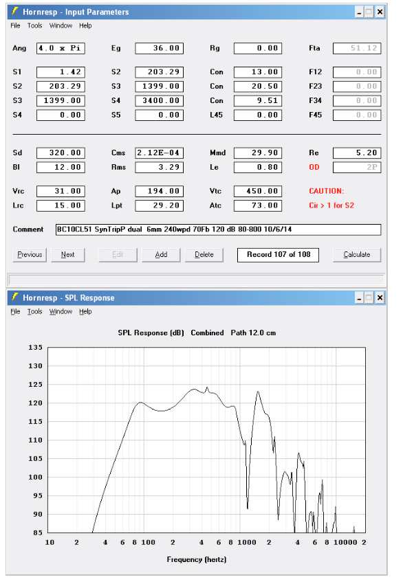

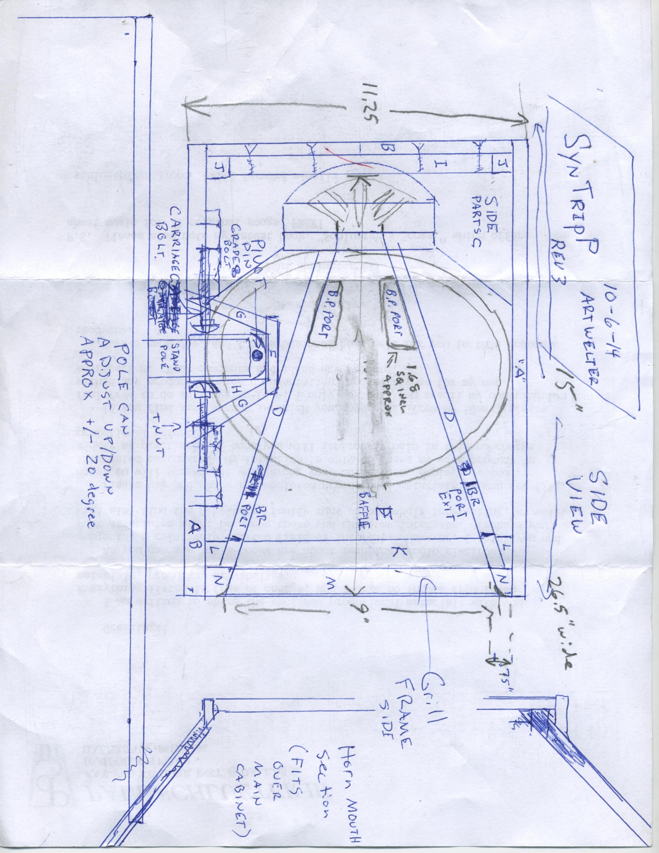

Revision 3: A smaller cabinet
Revision 3:
A smaller cabinet, with no loss in output, but some loss in horizontal pattern control, about 284 Hz compared to the previous version at 226 Hz. Having fourteen cabinets of this size presently, decided the larger cabinet just didn't fit well with my needs.
The main cabinet is 26.5" x 15" deep by 11.25" tall, which results in approximately 31 liter net volume after subtracting horn, drivers, tilt stand, and port volume. The cabinet uses four bass reflex ports, each approximately 11.5" (29.2cm) long with approximately 7.5 square inch (48cm2) exit, using the 10" driver baffle board as one vertical side.
The secondary portion of the horn (still under consideration) will be approximately 34" wide x 15.5" tall x 2" deep, and will use turnbuckles to attach to the handles of the main cabinet.
Art

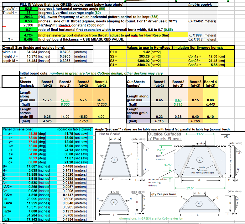

Can you show the Bwaslo spreadsheet inputs again for this design if it has changed? With a narrow aspect ratio box are you worried about pattern flip?
Pattern flip is unavoidable without a vertical dimension equal to the horizontal, so I don't worry too much considering I won't lug around a 5 foot (or whatever depth a 36 degree vertical Synergy horn with control to 284 Hz would require) deep horn.
IIRC, this horn has control good to around 1400 Hz vertical, enough to keep from tearing off the heads of people close if adequately elevated.
Bwaslow spreadsheet:
