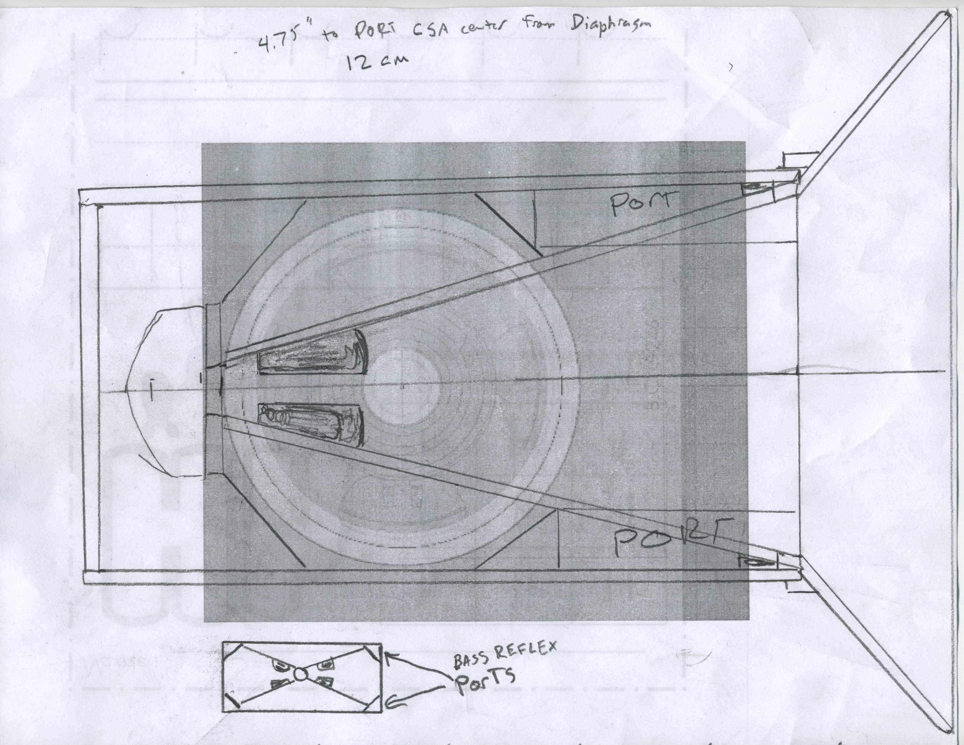

Here is the rough plan based on Weltersys data from above post.
Typo in drawing - actually 80 x 40 deg.

JG has the cone volume for the 10CL51 @ ~850cc, in Hornresp that needs to be doubled for two speakers plus the volume of any volume added for a spacer ring plus the volume for cutting the frustums on the front ports, or you need to install some kind of displacement reducing cone.
In Hornresp L12 should be the distance from the CD cone to the 10" injection ports. As the portion of L12 from the throat inside the CD to the CD exit is @ a different taper than from the CD throat exit to the 10" injection ports, maybe L12 should be exponential instead of conical. That may affect the high frequency corner. And the area of the throat chamber (10") has to be multiplied by 2 to reflect 2 drivers.

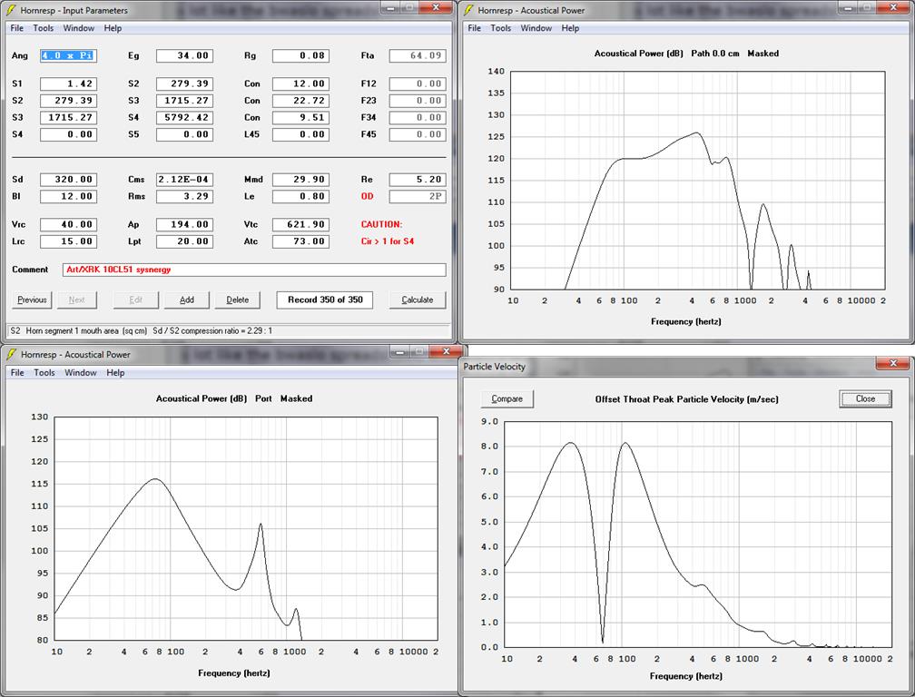

1) My port sizes were way off (I can't think in metric for beans), revisions below. I don't have a lot of confidence in the simulation (for instance the BR port combined output makes one of the upper sharp peaks, and that will be eliminated by placement and fill material) and the actual shape and volume reducers will result in unpredicted differences, I'll be experimenting with the actual transducers and horn to find the best combination.1)I am trying to work through your settings here. Is it correct that you are using the equivalent of a 5.7in dia injection port (per driver) at 5.25in from the throat?
2) I think you need a shallower Horiz dispersion angle and a longer horn to get a longer path for the bass injection ports to move that up.
3)So my question is this: is it so bad to have a 35 deg vertical dispersion angle as designed previously and already drawn up by JG? I am not sure there is much benefit to going from 35 deg to 40 deg vertical unless you plan to fly this high up and aim down.
2) The 85x40 pattern is as narrow dispersion in either direction for my needs, more narrow horizontal would require two cabinets per side, more narrow vertical would result in too high a frequency loss of pattern control. The horn length is fixed by the width, 26.5 external is as large as my trailer will allow with the rest of the equipment.
Jenny's application is quite different than mine, so my design may not fit either her aesthetic or other requirements.
The rough draft below used the full side panel length so I could more accurately figure the port location, so makes the vertical angle look more narrow than it is. If you look at the screen from 42.5 degrees off axis to the right, it looks correct

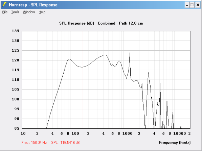

Pipe resonance problem?
Hi Art:
Are you using an old version of HR? Sometime in the last few months, the SPL graph labels were changed to "Acoustic Power". There are several new features I'm sure you'll like - an equalizer in the filter wizard and ability to look at particle velocity in offset horn throat.
Running your simulation model from a couple posts back in the latest HR, I get a prettier picture but the port output screen shows the pipe resonance in the middle of the passband is only down 10 db.

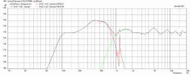

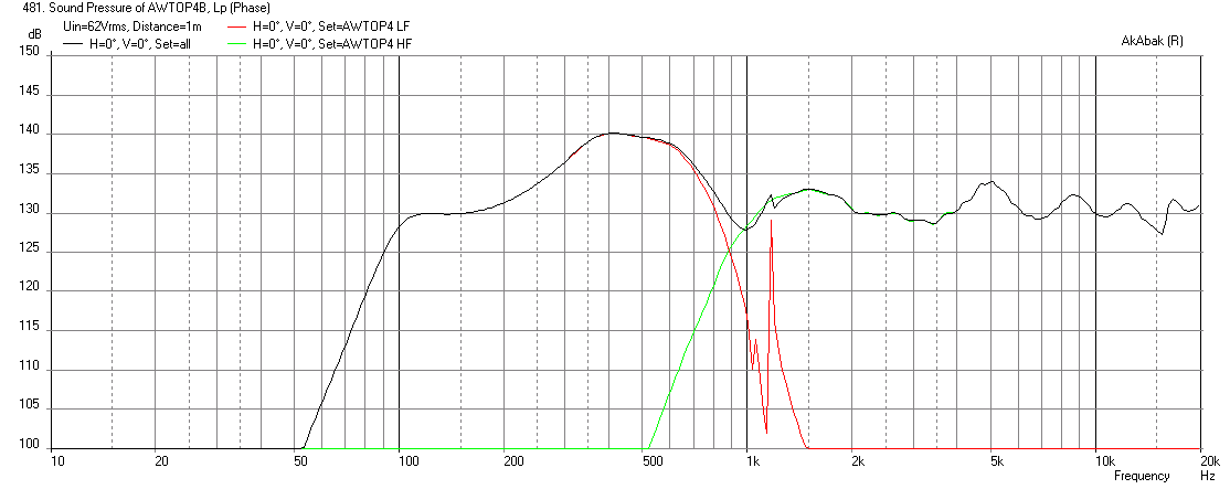

Here is the response without any filters:
Here is the response with 75Hz HPF (-12dB/oct) and 600Hz LPF (-24dB/oct):

The bump as you noticed is rather high and will require about 15dB cut to level out with the bass from the ports. It is not really because of the compression ratio - I played with it to make it even bigger than physically possible at the location on the horn wall. What you see there is the horn gain for the appropriate bandwidth. Note that this is a very short horn with a main conical expansion of 13in so that main gain is up past 500Hz or so. It is not from a compression peak in a bandpass port. A lot of level cut has to be applied to the CD as well to get it lower to match the bass. If this were run all out the system is capable of 140dB as a 2-way from 500Hz up. If we threw maybe four really big 15in 100dB woofers at it for a 3-way that may help to even things out but still not horn loading really with such a short length. With your 1m long (39in) horn with 11cm ports and dual 15in drivers you were able to get a pretty flat response to below 100Hz. I am seeing in the sims that you can probably get your top end higher with a volume plug inside the cone. You have a CD that can reach 500Hz but sometimes getting the electrical XO point higher may have some benefits to keep it out of the phase changing acoustical XO region. Although in your case I think you run it full range with exception of high pass filter?

Jack,Hi Art:
Jack
Yes, I don't have the current version of Hornresp, but it can look at particle velocity in the offset horn throat. Your sim looks more encouraging than mine, and I will be experimenting with smaller offset entrance ports and various "phase plugs".
My experience is the sharp pipe resonances Hornresp predicts end up being half the level or so, and four triangle ports may be less "pipey" than the single round one Hornresp uses. We'll soon see, ordering drivers this morning, probably will have the cabinets built and HF driver tests done by the time the 10" arrive.

Legis,1)Simulated response could be made more straight before the acoutical cut off?
2)What is the compression ratio of injection ports for the mids?
3)Perhaps bigger ports would make the response flatter?
4) As a side trail, I have not been able to measure lower total acoustical pressure at the edges of quadrilateral conical horn. If there is no difference in pressure at the edges, does it make a difference to place the injection ports to the edges?
5)In space constrained projects, maybe bigger benefit would be gained by making the ports larger by utilizing also the area at the center of the side besides the edges. Trade minor (or none) HF response degradation to better/flatter MF response?
6)If there should be a difference in acoutical pressure at the edges with flat wave front (like all comp drivers output because of the phasing plug), how big the difference should be in theory, anybody have a clue?
1) Hornresp appears to predict a much flatter response than Akabak, but even if the response falls between the two, the reduction of midrange is no problem with DSP, the reduction will flatten phase too.
