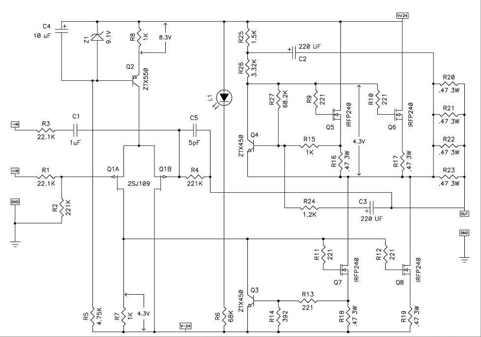

Dynamic output feedback
I'm a new DIYer and would like to discuss a little about the operation of Aleph J.
Referring to the attached Aleph J (AJ) schematic, I can see that the obvious modification of AJ compared to Aleph 3 (A3) falls at the negative feedback (NFB) portion. Unlike A3, where a constant 0.1 (1k/10k=0.1) gain of output is feedbacked, AJ have a dynamic feedback, and the feedback varies from 0.091 to 0.092, between 20Hz to 20kHz. The following are my questions:
1.) I don't understand why the increase of negative feedback at high frequency can be useful in music reproduction.
2.) Referring to the schematic again, I don quite understand the use of Q3, which functions as if a constant current source.
P.S: I would like to have a more understanding on how Aleph 3 work. Could you please direct links that explain A3 in detail?
Thanks in advance.
Thanks in advance.
