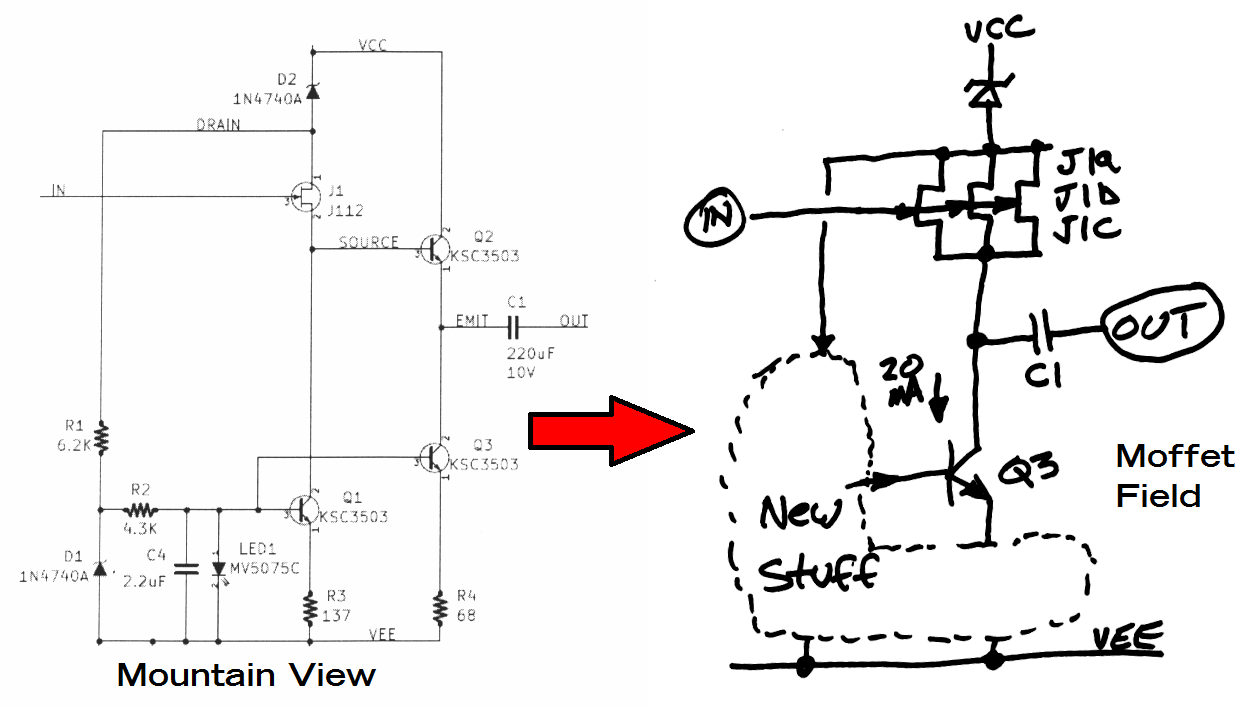

For those who wish to experiment with gold plating the Mountain View input stage, let me gently suggest "Moffett Field" (an airport inside the Mountain View city limits, where Sergey Brin of Google keeps his personal Boeing 767 airplane).

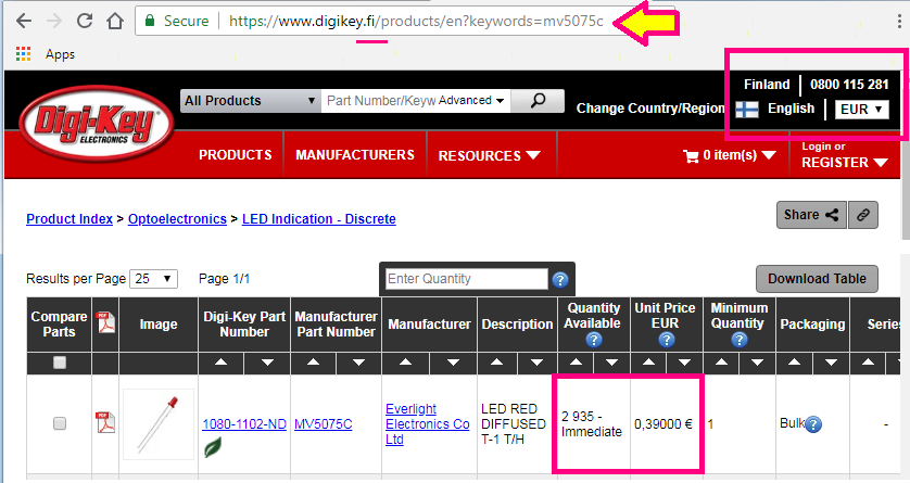

Interested builders can fill in the details as they see fit. This may be an opportunity to get rid of the much-maligned MV5075C LED and its horrible "do not substitute" requirement in the BOM.
- Start with the Mountain View schematic.
- Discard Q2 and Q3 and R4 (node "EMIT" disappears)
- Connect C1 to node "SOURCE" instead
- Replace J1 with three Fairchild J113 (not J112) JFET devices, connected in parallel. Call them "J1a, J1b, J1c".
- Hand test and match J1a, J1b, J1c so their IDSS values are within 10%. Any IDSS greater than 7mA will be fine, but make sure all three JFETs have the same IDSS.
- Modify the bias network (Q1 + R3 + crud on the left) of constant current source Q3. Change it in such a way that the current in Q3 is a constant 20 milliamps, pulled from the parallel connection of J1a-J1c. I.e. each of the three parallel JFETs carries 6.67mA of bias current. Make this 20mA independent of temperature and independent of supply voltage, to the extent possible.

I would like to, but shipping is 18€ since I don't have anything else to order there
If you would like to re-engineer the Mountain View input stage daughter card, and provide technical support both now and in the years to come, please go right ahead. I suggest you pay careful attention to its performance (i) versus ambient temperature; and (ii) versus total supply voltage (|VCC| + |VEE|), since those are likely to vary from owner to owner. Not everybody uses the AnTek transformer, not everybody has AC mains within tolerance, and not everybody has air conditioning in their listening room.
Start by measuring a V.1 original board; there are some things you just can't get from informed guessing, or from vendor-supplied (crappy) simulation models.

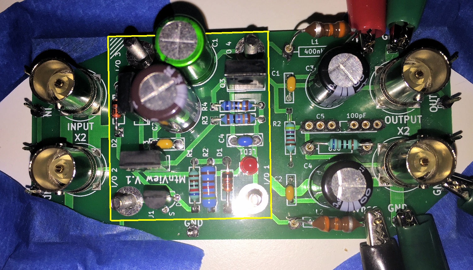

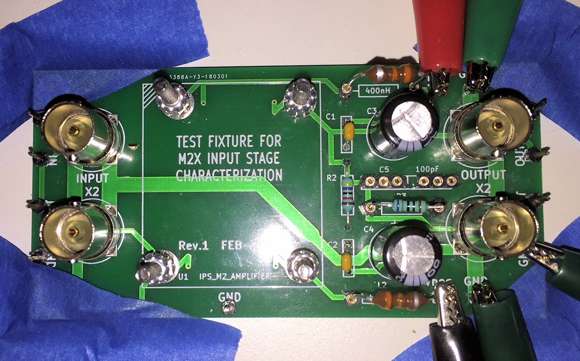

If you're going to engineer an input stage daughter card, you'll need a test fixture. One of the ones I used is shown below. It includes BNC connectors for extremely low inductance ground connections, much lower than a scope probe's ground wire + crocodile clip. This is needed when doing 2 nanosecond risetime square wave testing; any parasitic inductance in the ground leads will ruin the waveshape very quickly! Of course SMB or SMA connectors would have been even better but I didn't feel like spending that kind of money.
I included (socketed) inductors in series with the power supplies, to assess the input stage's propensity to oscillate if the power supply PCB traces (on the M2X mother board) are very long. I also included (socketed) load resistors to see whether the input stage's performance degraded whe driving the ~600 ohm input impedance of the Edcor transformer + output stage components. And I included (socketed) load capacitance too, to find out whether the input stage becomes unstable when driving a capacitive load.
Sockets let you quickly change a component value, or remove it entirely, or replace it by a short circuit. As you begin testing your input stage board(s) I think you'll quickly learn which of the socketed parts has the greatest effect, and which are essentially dont-cares.
