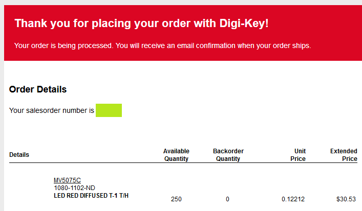

I just ordered qty=250 pieces of the MV5075C LED from an authorized distributor (DigiKey) and I'm confident these are not counterfeit. I paid USD 0.122 per piece, which is almost exactly 8 LEDs per USDollar.
These are used in the "Mountain View" input stage daughter card of the M2X amplifier.
I'd be glad to let other hobbyists have some of these at my cost, including my cost of postage and mailer envelope. If anyone wants to be a local re-distributor in parts of the world where Mouser doesn't sell the MV5075C (so far we know that Portugal and Finland are on this list), that would be a wonderful thing. Otherwise, small quantities only please. PM me with your needs and to get my PayPal info.
I estimate that shipping within the USA costs $4.50 and shipping outside the USA costs $14.50. Throw in the envelope and its 5 & 15.
