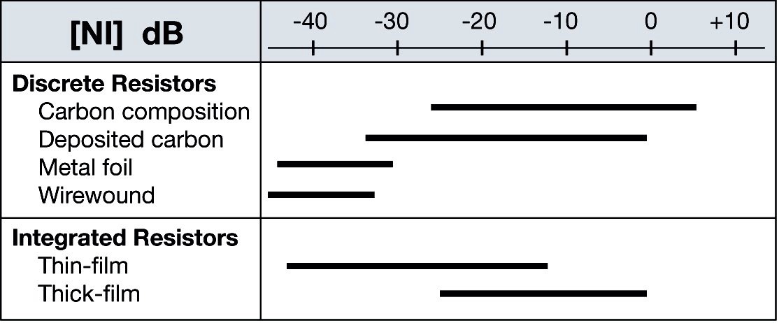

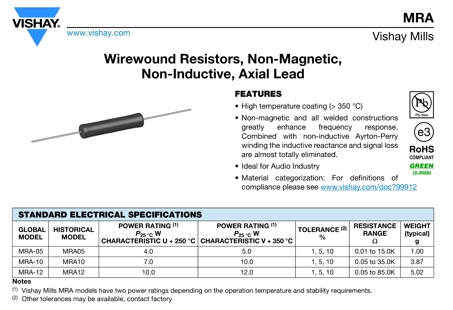

It is interesting to note that the 3W resistor proposed in the BOM, while of higher tolerance (5%) has a flat derating curve up to 70ºC (which is the temperature mine are working at in the ACA amp).Vishay | Mills source resistors is new product in stock at Mouser.
Not very cheap 4 pcs.= 10$
MRA-05R4700FE12 Vishay / Mills | Mouser Europe...
The ones by Vishay, while narrower tolerance (1%), start loosing power at 25ºC, and by 75ºC have around 80% of the rated power. Would that affect some characteristics of the amp?

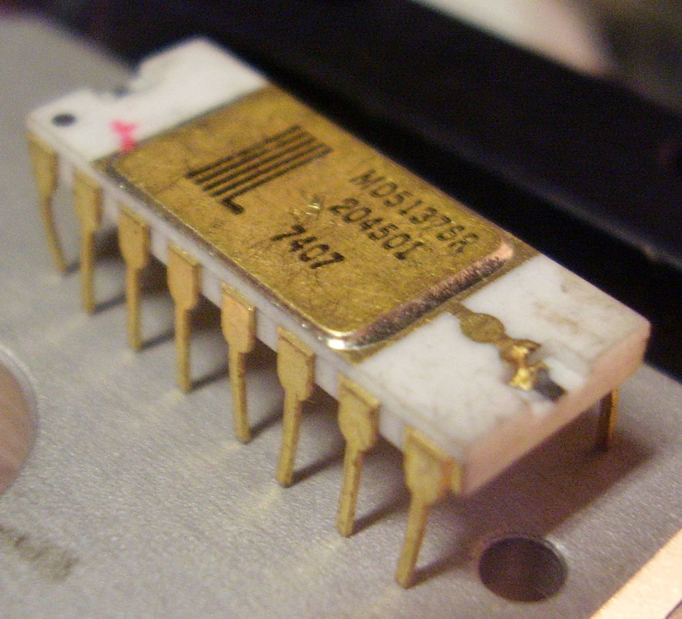

I'd love a quad of 797s in thru hole, white ceramic + gold lid even better. For that neener neener unobtainium cred on the DIY gear display tables at Burning Amp in 2019.
Say no more, we never put 797's in the white ceramic (those packages were very gold intensive) but I can find a few other candidates. I think I have some cerdip 797's though.

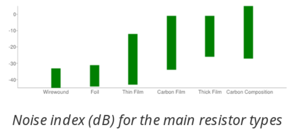

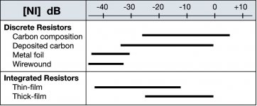

Low temperature coefficient ppm is always better , all resistors types are different :
materials, mechanical construction for example metal film compare to metalband etc.
0R47 Panasonic 3watt's are very good too but for make low resistances values = less 1 Ohm match ,
we need multimeter with 4 wires Kelvin mesurements option.
Yes resistors affect little charecteristics of the amp ( let's try build one M2 with carbon composite haha ) , capacitors much more and input transformer and transistors influence ( sweet spot ) to the final sound are huge

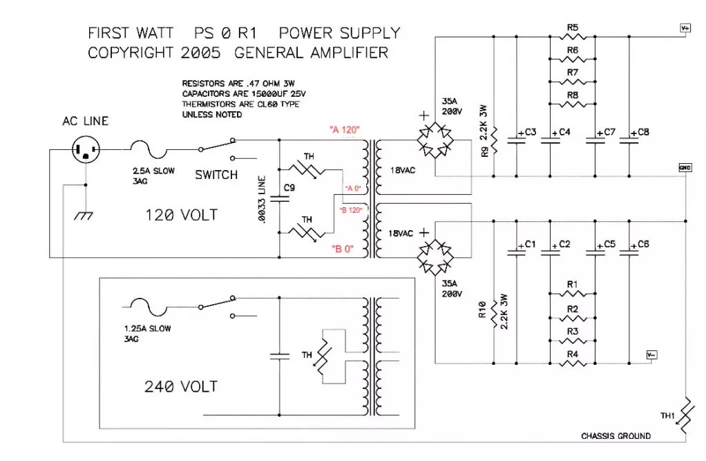

Sorry if I'm just obtuse, but I can't find info on the voltages required from the PSU. What specs are required?
Thanks,
Rafa.

Thanks for the answers!! So, if I were to plan in advance to buy parts to build an M2x when the PCBs are available and have the case also compatible with, say, a future F6... is there any chance to make the PSU more or less 'universal'? One requires +-25V while the other is listed for +-23V ... (although the schematic for the F6 PSU is identical to the one posted by Soundhappy, so not sure what makes those +-2V difference?).
Maybe I'm just over complicating things and there is no need for both and their similarities would make building both a bit redundant... I just wanted to know if there is a way to make it a truly 'universal' PSU for the different FirstWatt amps or if there are enough differences that require each to have a different PSU.
Thanks.
Rafa.
ps. Perhaps this was better asked in the PSU thread? Still, since the M2x is the on I will most likely build first, I jumped here first.

From 6L6's F6 build guide:
Go for it and have some fun!
diyAudio Mosfet F6
Power Supply
The F6 uses the same type of PSU as found in essentially all the other Firstwatt amplifiers (F5, F4, Aleph J, etc…) - +/-25Vdc rails, approx. 60,000uF filtering per rail. The diyAudio universal PSU board will work well for this.
Transformer 300-400VA 18+18Vac secondaries, shielded if available. Antek AS-3218 or equivalent (Bigger is useable if you have it, but 300-400VA is about perfect.)
Filter resistors (8) 0.47ohm 3W
Filter Capacitors (8) 15,000uF 25V minimum 10mm Snap-In 35mm max diameter (Bigger caps don’t hurt, but watch your inrush, you may need a bigger fuse.)
Rafa- Yes, a PSU for the M2x could also power an Aleph J. (hint hint hint) All you would have to do is change the amplifier boards.
And F4, F5, F6....but A-J would be a pretty good place to start.
