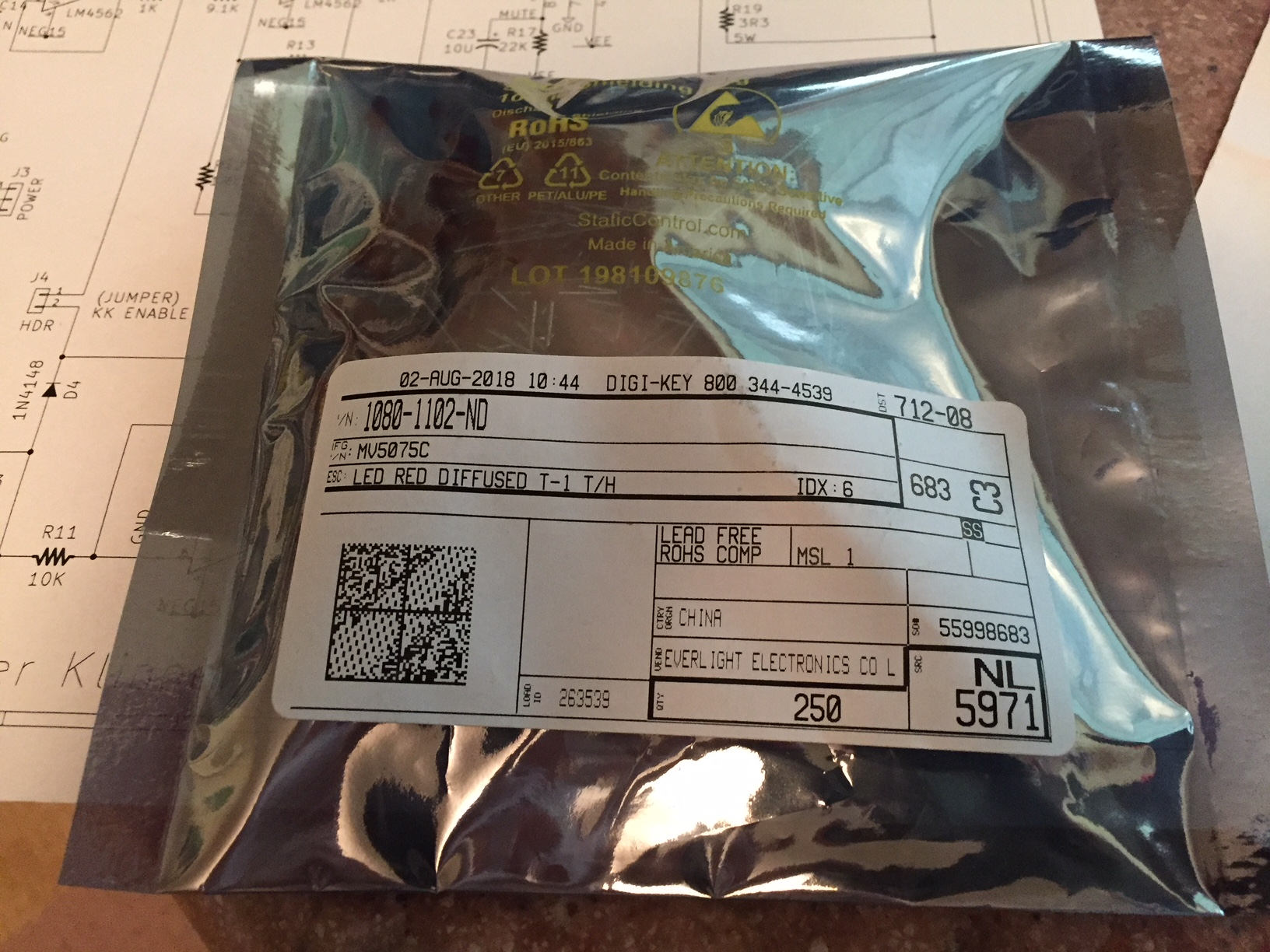

250 pieces MV5075C LEDs have arrived; selling at cost
Arrived today; photo below. Some M2X builders have already ordered and paid.
I just ordered qty=250 pieces of the MV5075C LED from an authorized distributor and I'm confident these are not counterfeit. I paid USD 0.122 per piece, which is almost exactly 8 LEDs per USDollar.
These are used in the "Mountain View" input stage daughter card of the M2X amplifier.
I'd be glad to let other hobbyists have some of these at my cost, including my cost of postage and mailer envelope. If anyone wants to be a local re-distributor in parts of the world where Mouser doesn't sell the MV5075C (so far we know that Portugal and Finland are on this list), that would be a wonderful thing. Otherwise, small quantities only please. PM me with your needs and to get my PayPal info.
I estimate that shipping within the USA costs $4.50 and shipping outside the USA costs $14.50. Throw in the envelope and its 5 & 15.

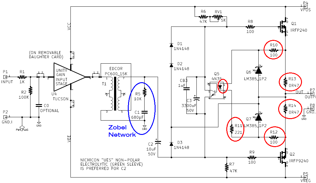

Thank you ZM! R13 and R14 must be gate resistors.
Made a mistake here by just assuming. R8 and R9 are gate resistors.

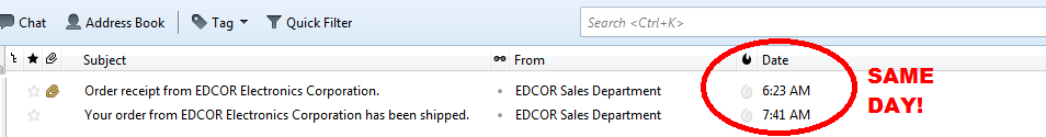

Edcor transformers for M2x: my order was shipped IMMEDIATELY
This morning I ordered eight of the Edcor PC600-15K transformers, for use in M2x amplifiers. To my surprise and delight, they emailed me back 90 minutes later (the same day! today!), to let me know that my order has been filled and shipped. Wow.

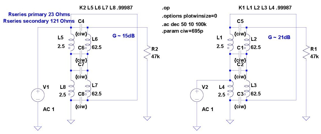

First of all thanks to Mark for the transformer samples.
My attempts to measure model parameters have met with difficulty due to the large variation of primary inductance with signal level. I am using our Digilent Analog Discovery USB module in network analyzer mode and even down to 10mV the numbers change. I ended up using a rule of thumb (600 Ohm and -3dB point) to get close and then measured series resistance and inter-winding capacitance with a Beckman handheld impedance meter.
Surprisingly both 15dB and 21dB auto-transformer modes match sim vs measurement fairly well, with the biggest difference being less peaking at 20kHz or so. An appropriate R/C damping network could probably make both very flat at the top end.
The 21dB connection comes with a 4x increase in drive requirement but I also wanted to try something that came closer to a normal PA gain structure. The gain variation with level is mostly below 20Hz (this would obviously come with an increase in distortion vs level) and probably is borderline on audibility. I must say I have listened to and measured an inductor based equalizer where this behavior extends well into the audible frequency region and it is clearly a serious coloration (that some may like).
EDIT - For those that have not done this before the coupling factor K was empirical. The sensitivity to it is surprising at first, 1 is ideal but seemingly tiny deviations below this make big differences.

Start with R13-R14. They are 0R47 3W 5% metal oxide resistors and a specific part number is given in the BOM. You need four pieces of this resistor to build a stereo pair of M2(x) amplifier boards. However, what I actually do is purchase ten pieces of this resistor, and then use my DVM to find the four resistors that are closest to 0.470 ohms. The cost is modest: $2.10 for ten resistors.
The remaining resistors can be 250 mW (or higher), 5% tolerance (or better). I myself always buy 1% metal film resistors and if possible, 600 mW. About half of the resistor values I want, are available at Mouser in 600 mW metal film. Here is one example: Mouser Link: 603-MF0207FTE52-221R . When 1% at 600 mW is not available for a certain resistor value, I buy 1% at 250 mW metal film. Why do I use 600 mW resistors when 250 mW is adequate? It's extra margin of safety and the additional cost is low.
For those who might wish to boast that their M2 amplifier, lovingly hand-built in their own home workshop, is so much better than a standard M2, I offer the schematic below. Please observe that the negative feedback loop which sets Class A bias current, contains resistors R10-R14 and the LED side of Q5, marked in red. Why not use super tight tolerance components for those five resistors?? R13 and R14 must be hand selected: Mouser doesn't sell 3W 0R47 metal foil resistors at better than 5% tolerance. To get tight tolerance for R10-R12 you could buy 0.1% resistors from Mouser ($1.58 for the 0.1% 221R, $0.60 for the 0.1% 100R), or you could hand select parts on your recently calibrated, 4.5 digit DVM. Once you've got super tight tolerance components for R10-R15, you know with certainty that the Class A bias current in your personal, hand built M2, is extremely tightly controlled**. Woo Hoo!
Naturally you could do the same thing upon the Zobel Network which terminates the Edcor transformer secondary. Read the application notes on Edcor's website and on the Jensen Transformers website; the Zobel Network subtly tailors the transformer's frequency response, to give exactly the sound and tone that Nelson Pass intentionally chose when he sized R5 and C1 originally. That's what you want, exactly, is it not so?
