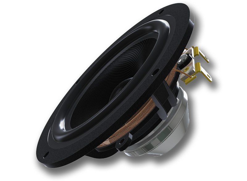

So in this case we have a frame, a pole plate and than the magnet.
Even without any extra measures, I doubt that you will get the magnet up to 100 °C.
But I also understand you like to be precious about your new little babies.
So if anything, I would fit them in an aluminum (or steel) jig to suck up the heat even more and use a fan or so to force some airflow.
glue?
If I understand the 10f motor structure, the ring magnet is glued between the pole pieces, one of which is then mechanically fixed to the basket. The pole pieces are unstable - the gap tries to close - probably easily disturbed if the glue softens too much.
I wouldn't expect trouble with normal epoxies below 80 to 100C, but transverse forces on the magnet/pole pieces should be avoided when hot.
Even "N" grade Neo magnets can run at over 65C for years.
What about the surround - it's adjacent to the source of heat? Butyl rubber is OK to ~120C, so if it's that it's probably also fine. Even if long as nothing that could deform the surround is touching it, all should be well.

About the concerns of the driver frame cuts...
I have found a few people that have hacked up a driver frame, mostly in the Car audio forums. Using everything from Dremel grindstones or carbide cutting wheels and also a router with a template. I guess all of those generate quite a bit of heat.
I intend to cut the first with hand tools, just to get a feel for it. Before I use anything motorized. First step is building a jig.

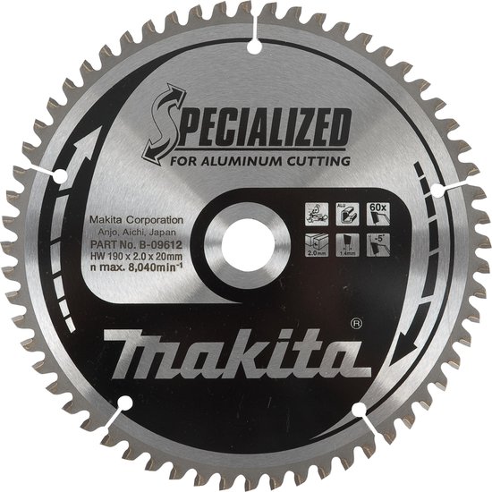

Having cut a lot of aluminium recently I can strongly recommend a mitre saw / drop saw with a non ferrous blade. With the right jig it would give a great finish and be pretty easy. Relatively little swarf. Even with a single through cut the heat should not be a real issue.
Thank you Zia, for confirming I'm crazy.
"But were never gonna survive unless, we get a little crazy" - Seal
Stay crazy and healthy my friend!
Interesting, something like this?
That's them, listed as aluminium or non ferrous bladesInteresting, something like this?
