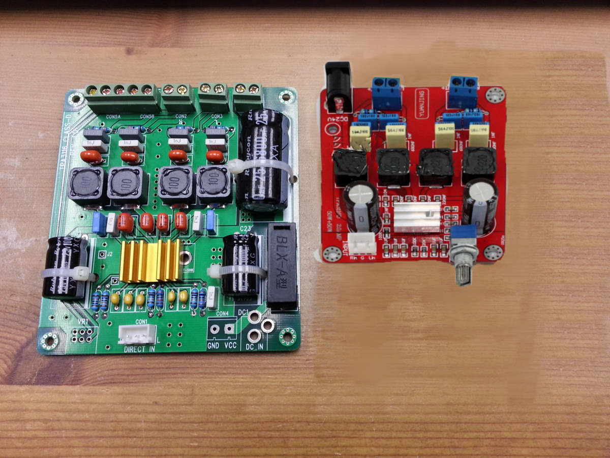

Well, size wise, how does this one compare to the YJ? In my system, I could not hear any hiss or excess noise using the red YJ board (2.0), which admittedly has a lot of space on the PCB. Granted my speaker is only 87dB sensitive, not a 100 dB horn. Most people on this thread are using the YJ board, any comments on hisses and noise?
Something close to what you can see by the picture.
With the yj boards I still have hiss even with 87dB speakers.
[]'s

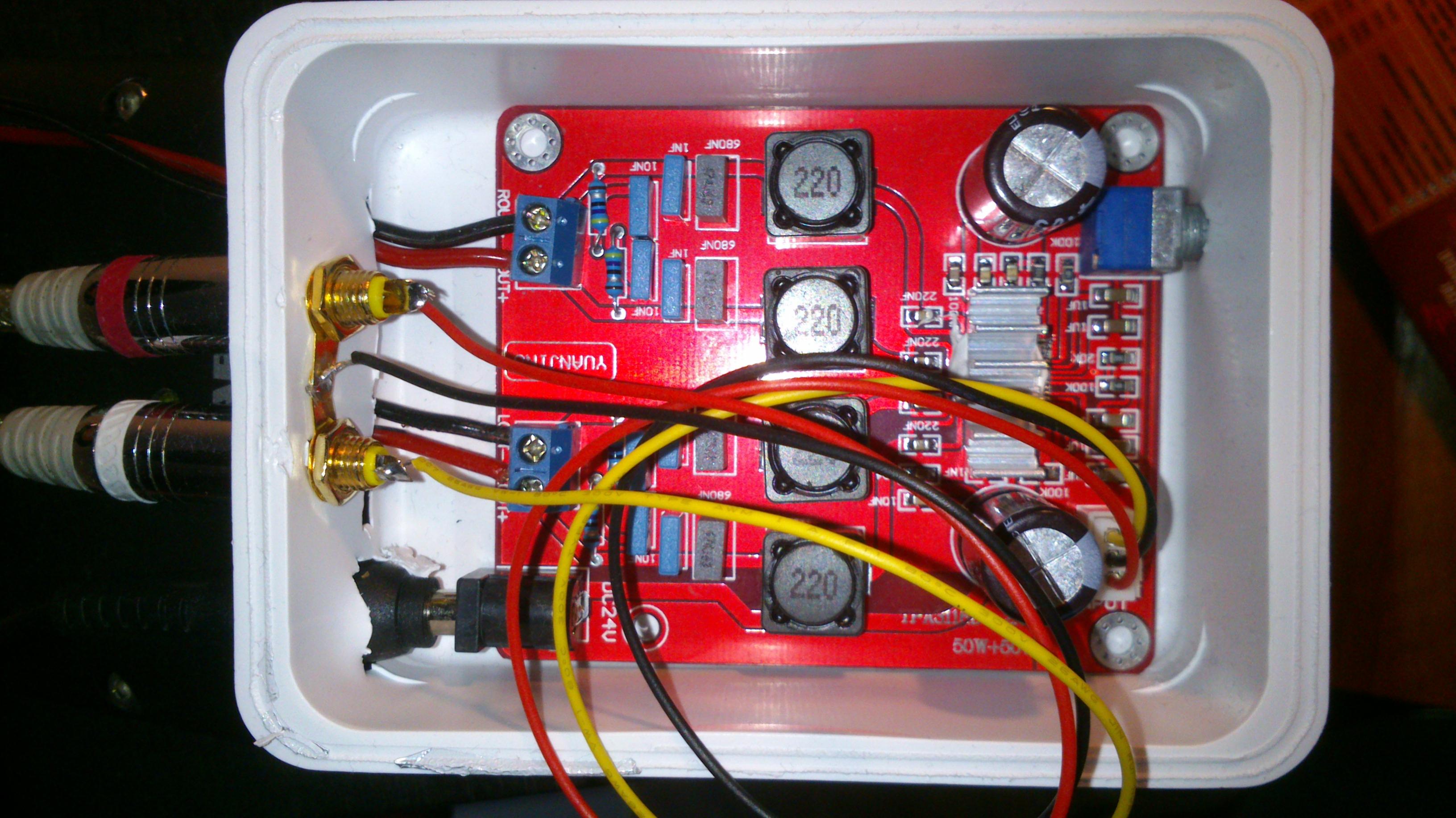

Strangely, I don't think this is the case on my board ... ? Of course, I can be wrong, but I checked everything and it seems that left speaker is connected to left output and left soundcard output is connected to the left input of the board.
My balance fader still works as it should. The only thing I can think of is that the balance of my soundcard is somehow reversed, but that would be strange.
My board is about one month old. It has the new style heatsink.
I thin the confusion on the YJ board is that they are logically changed. The side that has the right input has the left output and the side that has the left input has the right output. Doesn't necessarily mean they are changed around though.
If you put the card with inputs on top it reads:
L - 0 - R, for the inputs and
R- - R+ - L- - L+, for the outputs.
