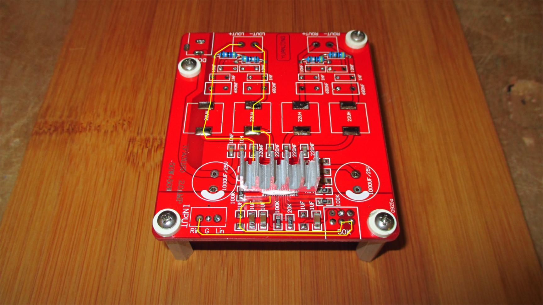

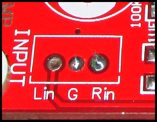

I thin the confusion on the YJ board is that they are logically changed. The side that has the right input has the left output and the side that has the left input has the right output. Doesn't necessarily mean they are changed around though.
If you put the card with inputs on top it reads:
L - 0 - R, for the inputs and
R- - R+ - L- - L+, for the outputs.
Well the bottom line is that the audio signal fed into the "Right" Channel input pin on the little white input header is output from the Left Channel output terminals and the audio signal fed into the "Left" Channel input pin on the little white input header is output from the "Right" Channel output terminals.
.....so if you follow the input and output markings that are on the board... The left and right channels are swapped. You can use a test disc with a channel assignment track to confirm.
I've done some extra tests and you are right, I was wrong.
Right input goes to left output. Left input goes to right output.
I didn't have any problems because my soundcard is inverting the balance :s. So it got inverted twice, that means it went back to normal 😉

I mean, look at the size of this board :spin:
This amplifier has enough of hiss with smt components on a tiny PCB.
This big board with lots of trough hole components and the extra, unused pcb space is only going to provide you with much more parasitic inductance, hiss and crap...
This board is exactly what we should avoid .
Thank you, I thought I was talking into a vacuum! :headbash:

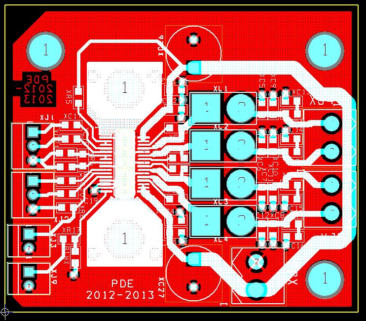

High frequency, power-supply bypass capacitors should be small size, SMD and as close to the chip as possible.
Long trace, long lead and self-inductance of the cap will create too much inductance and swamp any very-high frequency bypassing of the cap.
Remember, this is a digital chip working at very high frequencies, it needs digital power-supply bypassing.
Through hole for gain and other user selectable parameters is fine, nay great for DIY but NOT power-supply!
Those OrangeDrop looking caps are pretty but they physically and electrically CANNOT address digital high frequencies.
And see how the main PS caps are sideways! The long leads to the ground plane would swamp any low-ESR caps you're using?!?! This designer is trying to seduce the DIYer with audiophoolery, NOT follow proper digital design procedures.
How much worse could they really be for $8.00-$14.00! 🙂 I mean, really. What do we expect the performance of these little boards to be!? Most of us probably add more noise just by the way we hook it up and the routing of cables. 😉
I expect to have the best value for the money.
Obviously it is a good playground for those who have no smt soldering experience but want to experiment on changing components and modding the board to the ultimate, ending with crap sound. In the end it will sound worse, no matter how much you mod it, this board is made for a slow circuit that will work like an antenna grabbing junk and for $8.00 $ 14.00 I would sure take the YuanJing.
You are free to take your chances but people should be aware that this board is a bad design and one of the worse competitors if not the worse, sound quality wise.

This image shows the signal path clearly. If the screenprinting at the input were changed to this second photo, all would be correct since the Left and Right designations within the chip are arbitrary.

Hey Virpz, what other components are high-freq critical? Output filter?
I like through hole for the output filters if you can keep legs short on a good designed pcb, then it may be a good compromise.
With this board there are way too many problems summing up
+ Freaking long tracks
+ Electrolytic caps put on vertical with ridiculous long legs
+ Filling empty space with copper is not always a good idea.
+ Distance between critical components is much bigger than the recommended by TI.
+ Through hole components on a poor designed PCB.
Some one with the right skills can design a TPA3116 based amp with through hole components while avoiding most of the problems. This is definitely not the case with this board.
