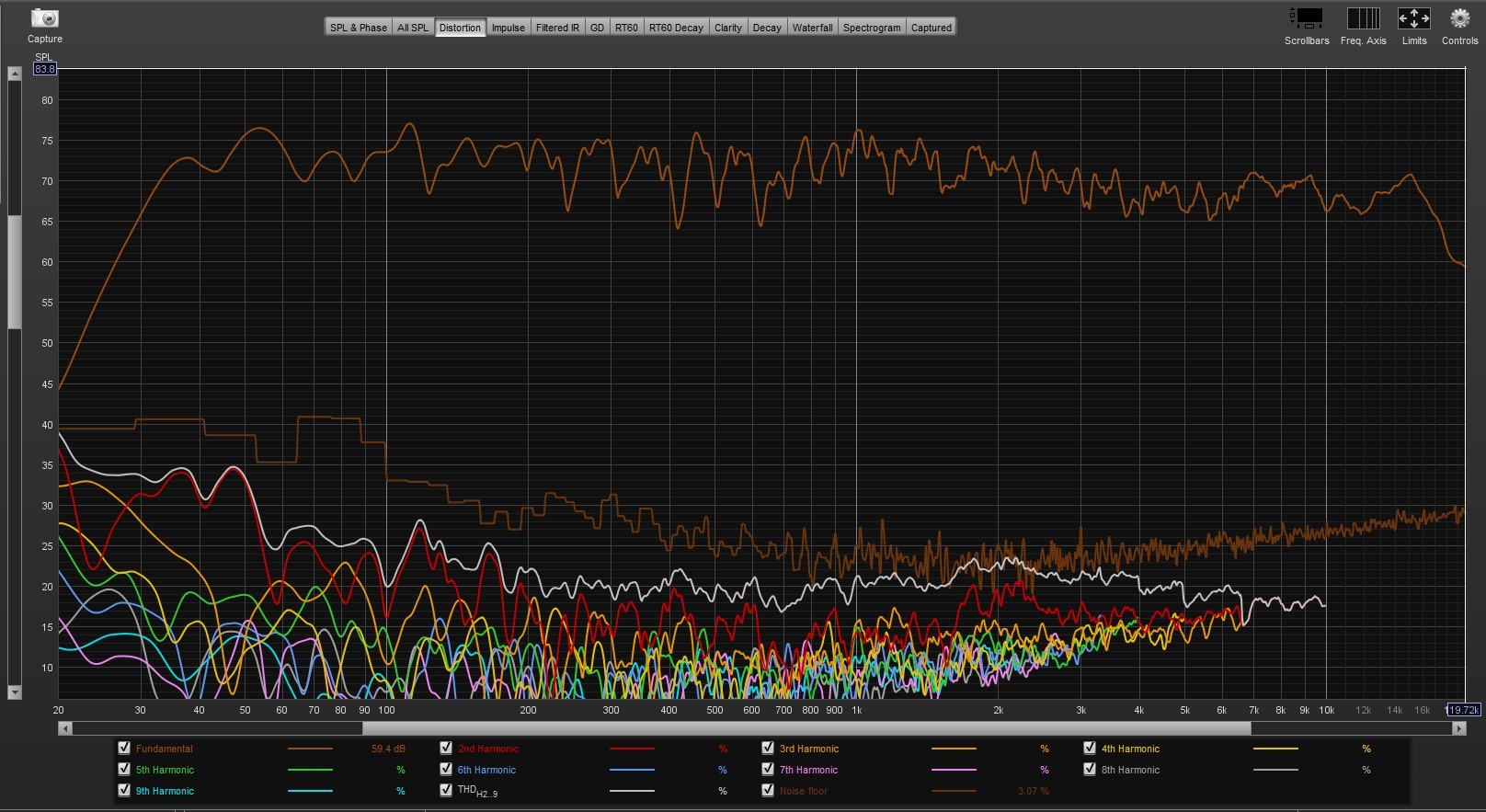

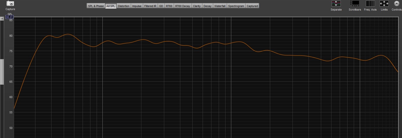

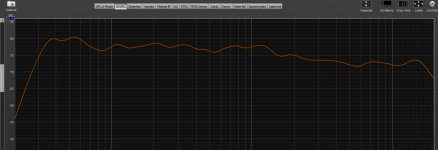

von Ah's measurements spl is around 75dB. All distortion lines go below noise floor and are thus irrelevant nonsense. 90-95dB will do.
But spl of the pure signal looks very good! I would attenuate everything above 200Hz about 5dB and low treble 1.5-4dB too. Using 1/2 oct smoothing helps to evaluate tonality.

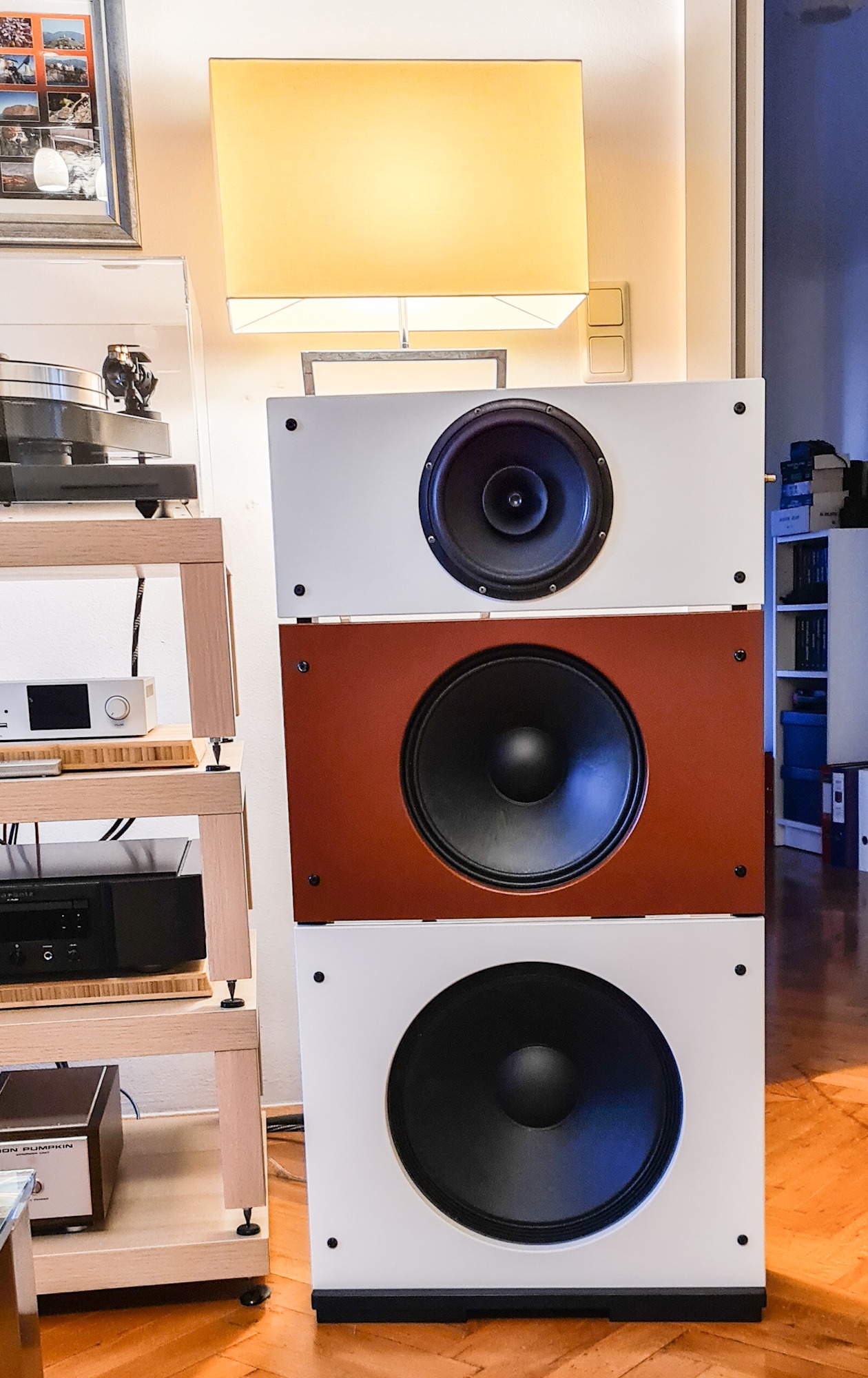

Hi Jeremy
Active with DCX2496 ( modded) and Raspberry PI3 with Hifiberry Digi + pro as musicsource with Flac files. 6 cannels controled by Yamaha RX-V 3800 in multichannel mode and extra a modded Kenwood Basic M2 for the bass units.
I have build 2 disub subwoofers, cut off at 120 hz, each one of them with 2 peerless 12 inch woofers, more or less copied from W type linkwitz woofercabinets, made the baffles of plain multiplex boards wit Hivi Research 5 inch midwoofers,cut off at 2800 hz , 2 each and Neo 8S as high units, so open at the back, with DCX2496 reasonable flat till 12000 hz, above that I do not hear anything, so no need to extend the flat line...too old..lol.

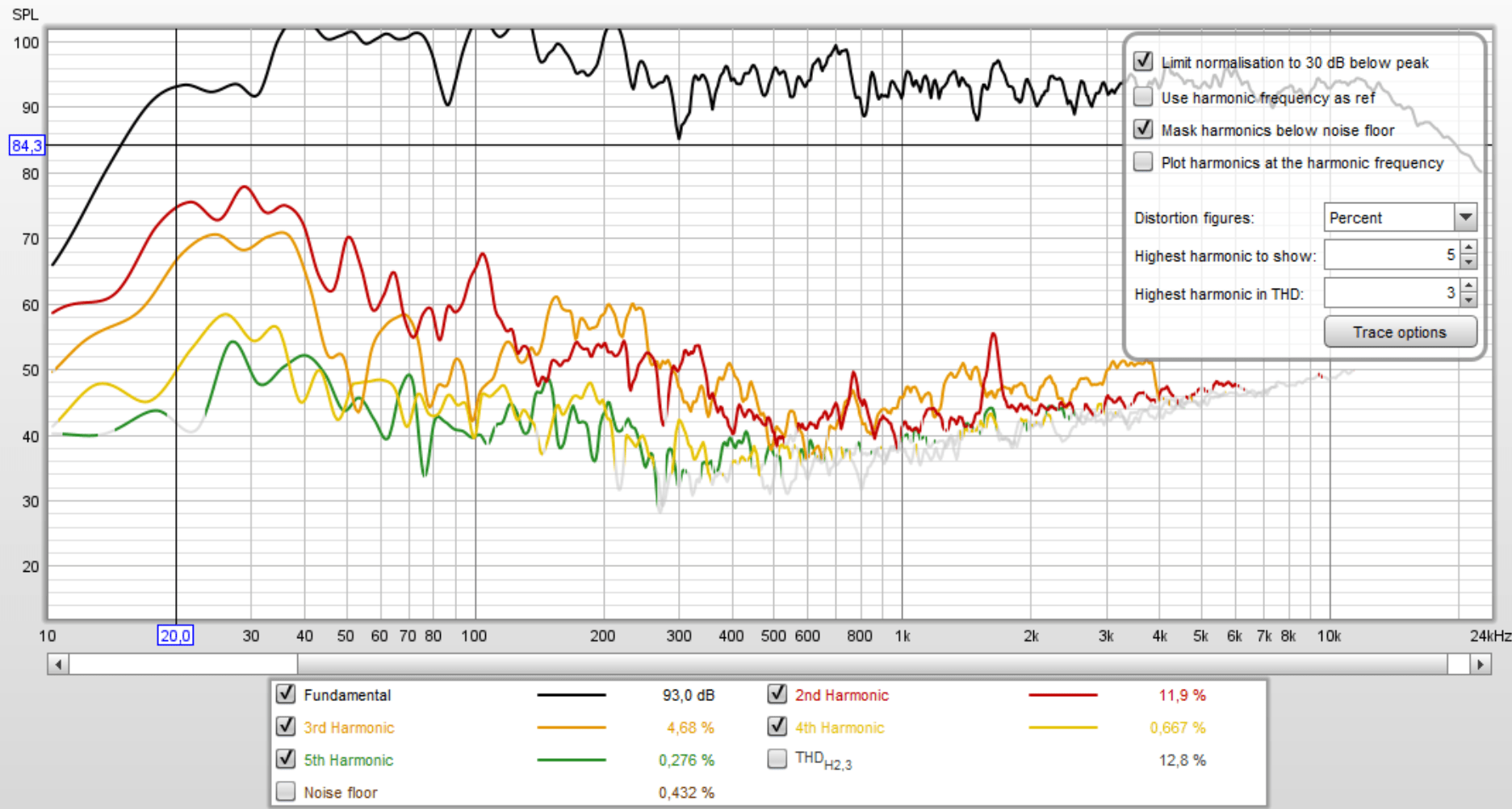

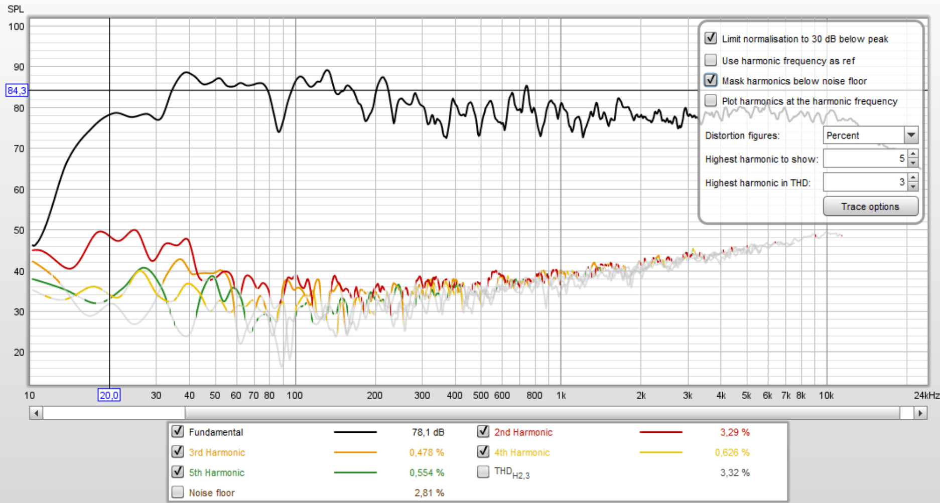

REW can measure THD below noise floor, it is relevant. Probably SPL level is not calibrated and can actually be some other number.von Ah's measurements spl is around 75dB. All distortion lines go below noise floor and are thus irrelevant nonsense. 90-95dB will do.
kaamelis, do you really see anything relevant in mentioned distortion measurement? Please don't encourage people to use poor methods!
A loudspeaker's distortion typically has high numbers below 100Hz and some peaks above it. Room noise is typically also high below 100Hz and then rather smooth around 40dB but has also some peaks from eg. fridge, air conditioning etc.
REW masks distortion (makes lines grey) below noise floor by defaut settings, because of these problems. (Earlier versions didn't have this masking feature. Noise floor wasn't defined either some years ago)
Here same speaker measured with low and high spl. Indoor distortion measurement of a loudspeaker is always unreliable! With high spl room and furniture makes resonances too.
![ainog 2x4 disto 95dB.png ainog 2x4 disto 95dB.png](https://www.diyaudio.com/community/data/attachments/1049/1049503-4ebcb94a4317bbca2c2f07d49fe61801.jpg)
![ainog 2x4 disto 80dB.png ainog 2x4 disto 80dB.png](https://www.diyaudio.com/community/data/attachments/1049/1049502-4264bf4550b03ab297168de225c6df56.jpg)
