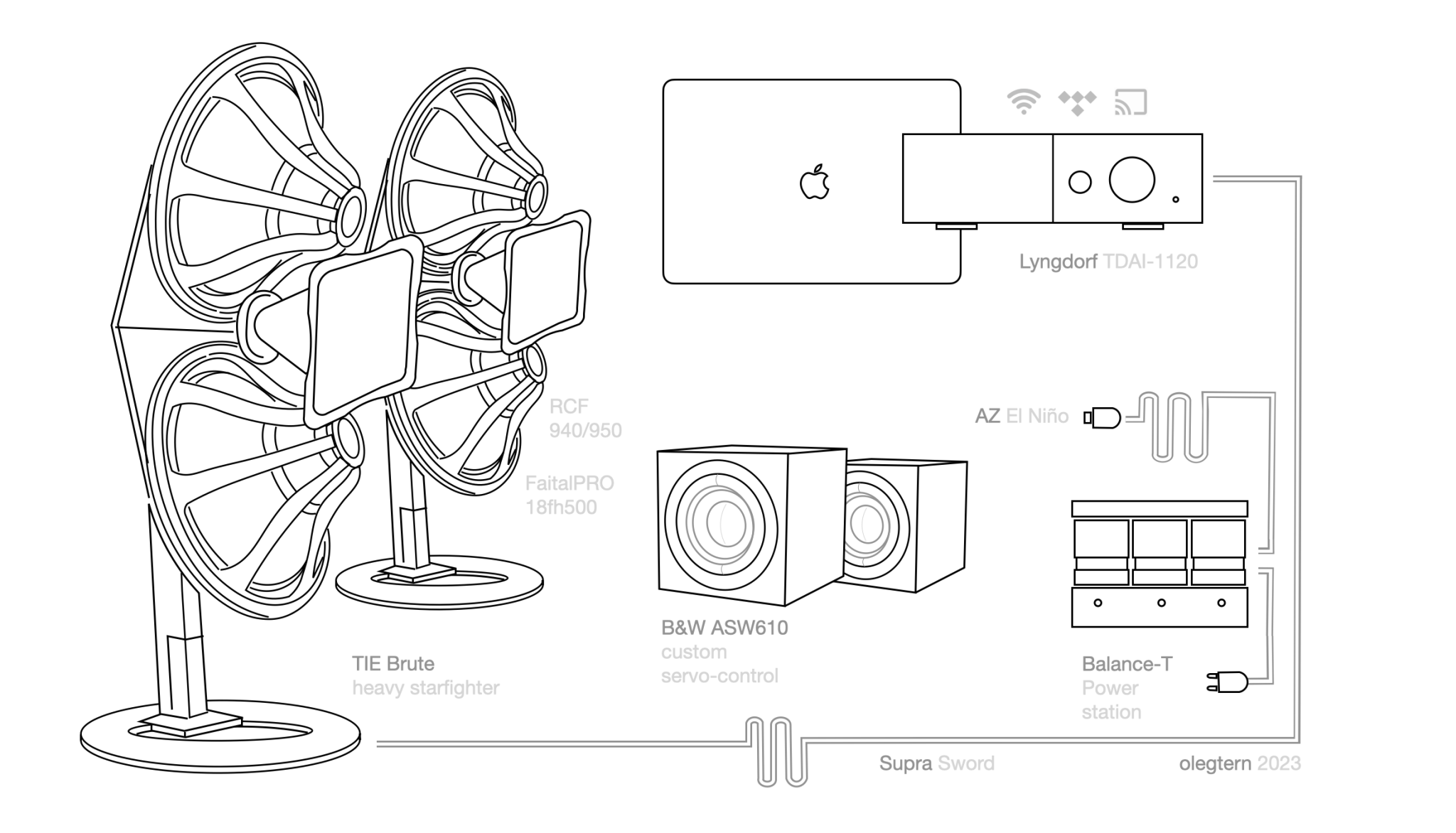

Hi, you can find some info in this thread: https://www.diyaudio.com/community/threads/tie-brute-open-baffle-horn-speakers.372804/Could you tell us more about your speakers - I’m also planning an OB / horn hybrid: OB bass / mid up to c. 600hz crossing over to a horn
In short, OB/Horn speakers + servo subs. Passive crossover (I still haven't finished it, but all versions were not bad))) + EQ in Lyngdorf TDAI-1120.

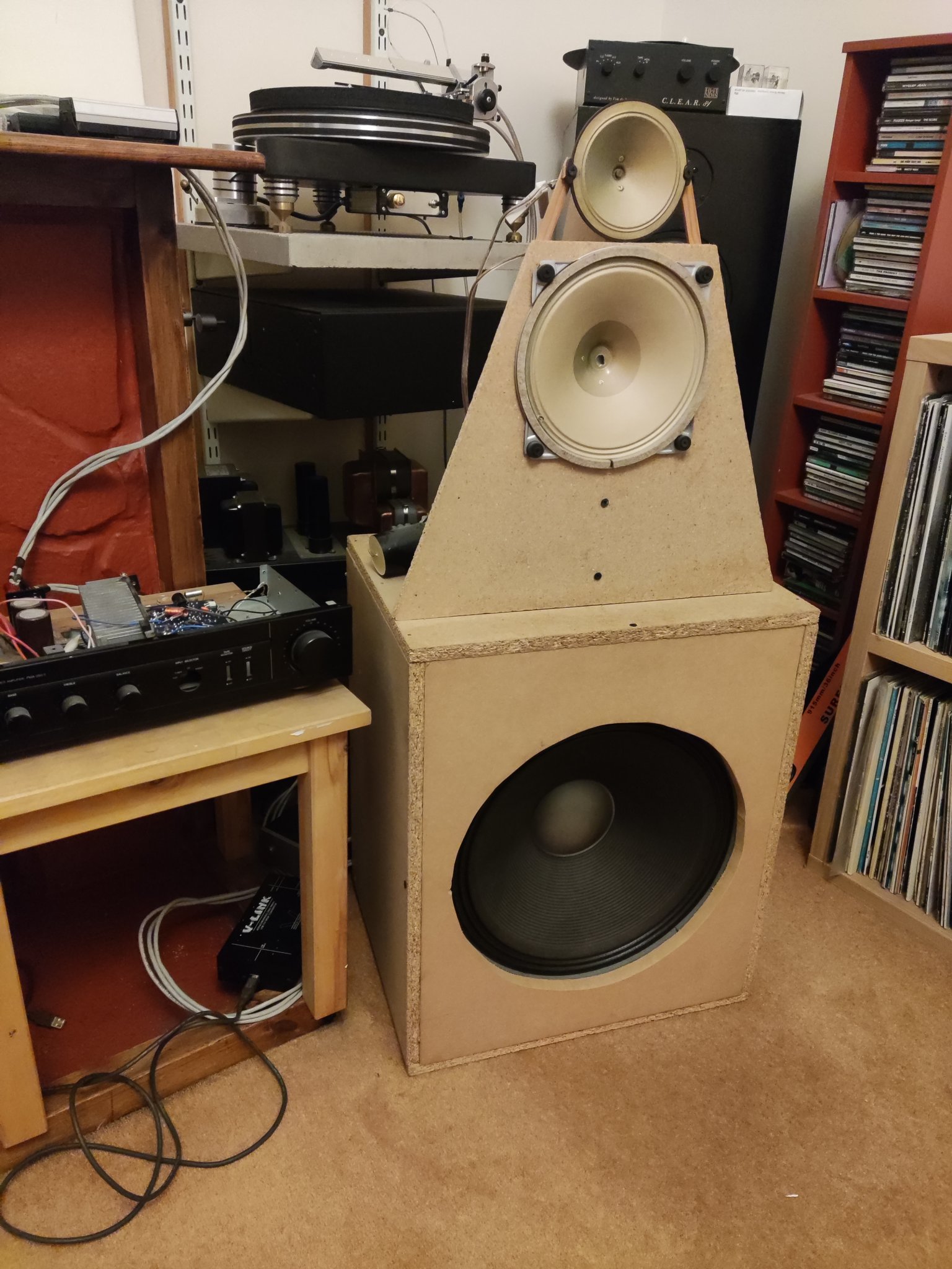

I bought a pair of Lampizators with Saba green cones a few years ago from a guy on another forum. I didn't really get on with them and they were put aside as I got another pair of OBs. I thought that the cohesion between the bass and mid/treble was not to my liking or not quite right.The design was based around lampizator project 17. Except I changed the front baffle shape and put a resistor network in front of the tweeter to dial it back a bit. 15" is an open backed u-frame.
So it says mid to bass is crossed around 300-400Hz.
http://lampizator.eu/SPEAKERS/PROJECTS/P17/Endorphine from Kingston Kitchen.html
The sound is quite coloured and it certainly doesn't have a flat frequency response. But it does something I really like and haven't been able to find in a hifi speaker. It sounds very open and relaxing but I also find the timing very good. Makes other speakers sound closed in.
Last week I thought that I would give them another go by using the mid/treble with the bass from the other OBs. They would clearly need a little tweaking to make them gel given the sensitivity, but I had forgotten just how open the mid/treble is, great for acoustic guitar. When I took them out it sounded somewhat dull

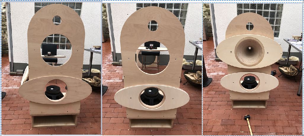

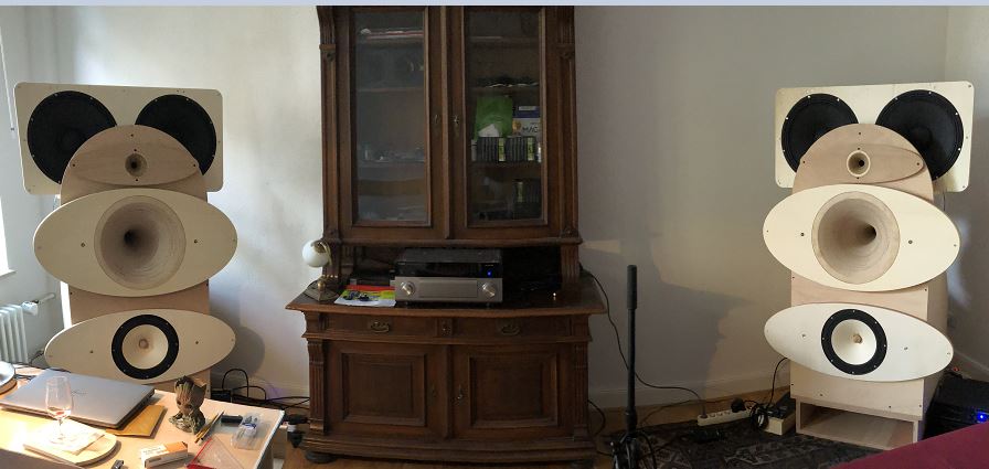

I would like to offer a short presentation of my latest slot loaded open baffle project in ongoing development. Here the latest version with the strange mickymouse ears for the kickbass:
![SLOB-mit-Micky-Maus-Ohren-Capture-2.JPG SLOB-mit-Micky-Maus-Ohren-Capture-2.JPG](https://www.diyaudio.com/community/data/attachments/1084/1084188-8d9c720e8043241eeebe13cc6c3ef345.jpg)

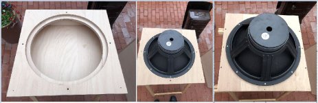

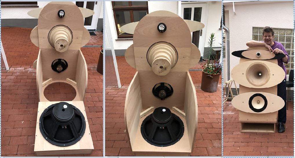

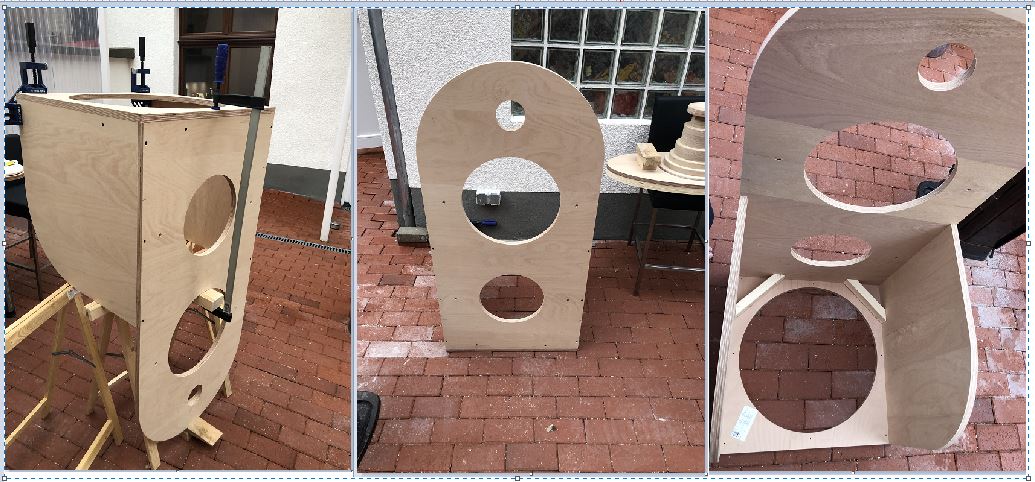

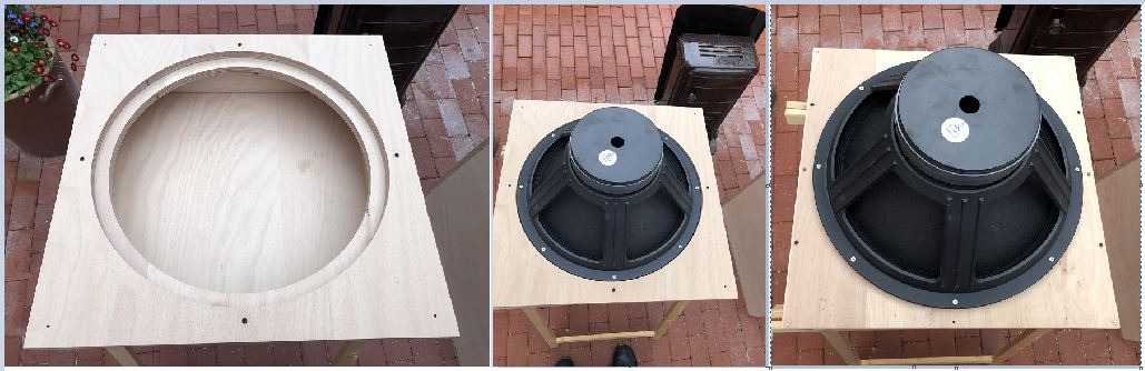

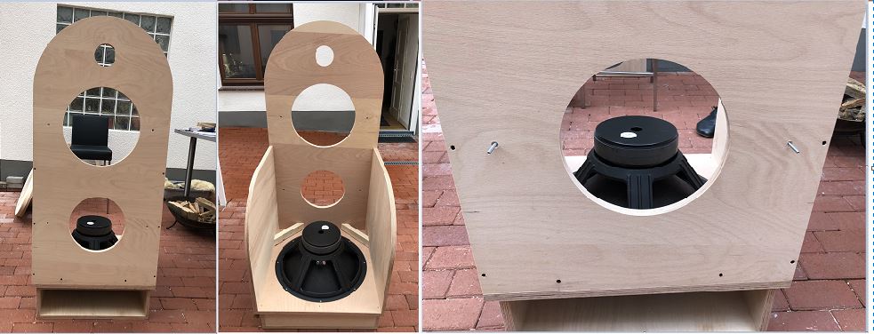

And then some fotos of the construction details:
![01_FotoStrecke-neue-SLOB-Capture.JPG 01_FotoStrecke-neue-SLOB-Capture.JPG](https://www.diyaudio.com/community/data/attachments/1084/1084193-4f28284280833d27902fb373ed790457.jpg)
![02_FotoStrecke-neue-SLOB-Capture.JPG 02_FotoStrecke-neue-SLOB-Capture.JPG](https://www.diyaudio.com/community/data/attachments/1084/1084192-0d995a0a707ab94bd3b120ed000636a7.jpg)
![03_FotoStrecke-neue-SLOB-Capture.JPG 03_FotoStrecke-neue-SLOB-Capture.JPG](https://www.diyaudio.com/community/data/attachments/1084/1084191-46326ae4578cf74cc7d8bb6bf952b2cc.jpg)
![04_FotoStrecke-neue-SLOB-Capture.JPG 04_FotoStrecke-neue-SLOB-Capture.JPG](https://www.diyaudio.com/community/data/attachments/1084/1084190-69ea2c335e54134587acfb64332dd1c3.jpg)
![05_FotoStrecke-neue-SLOB-Capture.JPG 05_FotoStrecke-neue-SLOB-Capture.JPG](https://www.diyaudio.com/community/data/attachments/1084/1084189-6a28ee007493b83b8aa32aeab5260343.jpg)

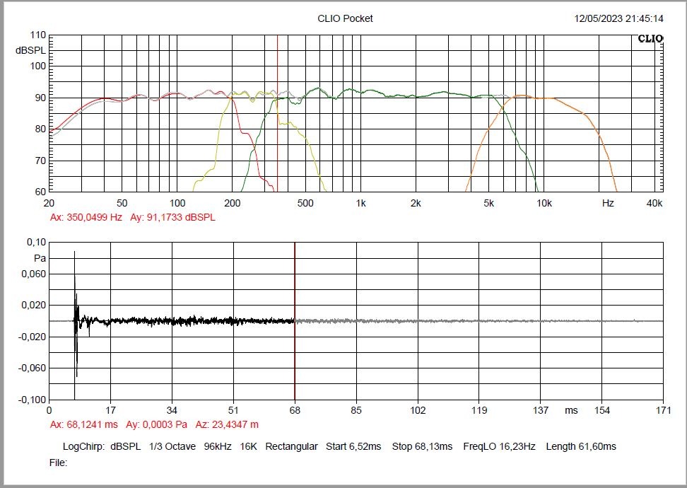

Last but not least the first measerument without the mickymouse ears kickbass and Visaton TL16H supertweeter replaced with see actual specs below
![FG-SLOB-SW-Midbass-Midrangehorm-Highrangehorn-Capture.JPG FG-SLOB-SW-Midbass-Midrangehorm-Highrangehorn-Capture.JPG](https://www.diyaudio.com/community/data/attachments/1084/1084196-07d9c97743912d3e6865d9ad952b4f4a.jpg)
Very quick some tech specs
Subwoofer 21 inch HSB21
miniDSP active CO BP LR4 10 Hz - 85 Hz
power amp Crown XLi 800 bridged mode
Kickbass 2 X 15 inch Celestion FTR15-3070C
miniDSP active CO BP LR4 85 Hz - 170 Hz
power amp Crown XLi 800 parallel mode
Midbass 12 inch Sonido custom chassis
Plate amp Hypex FA 123 CH1 active CO BP LR4 170 Hz - 340 Hz
Midhorn Tractrix Curve Woodhorn 16 inch with B & C DCM 414 compression driver
Plate amp Hypex FA 123 CH2 active CO BP LR4 340 Hz - 3400 Hz
Tweeterhorn Tractrix Curve Woodhorn 5 inch with 18sound NSD1095N compression driver
Plate amp Hypex FA 123 HF CH active CO HP LR4 3400 Hz
