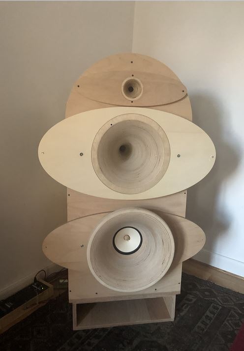

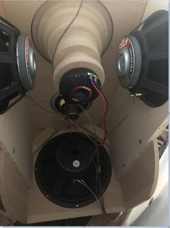

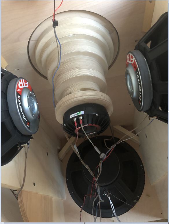

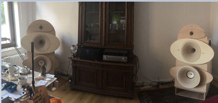

Juli 2023 Refresh of SBA_SLOB_GUY OB PROJECT in the not too big Home Office room, pics says more than long explanations
The waveguide for the 8 inch is used here only like a filler driver between the side mounted 2 X 15 inch kick bass and and the midrange horn with the compression driver - it's a kind of waste but the final setup will be moved to the big room under the roof top later. The cabling is in complete prototype state, this has to be done much better for the final installation.

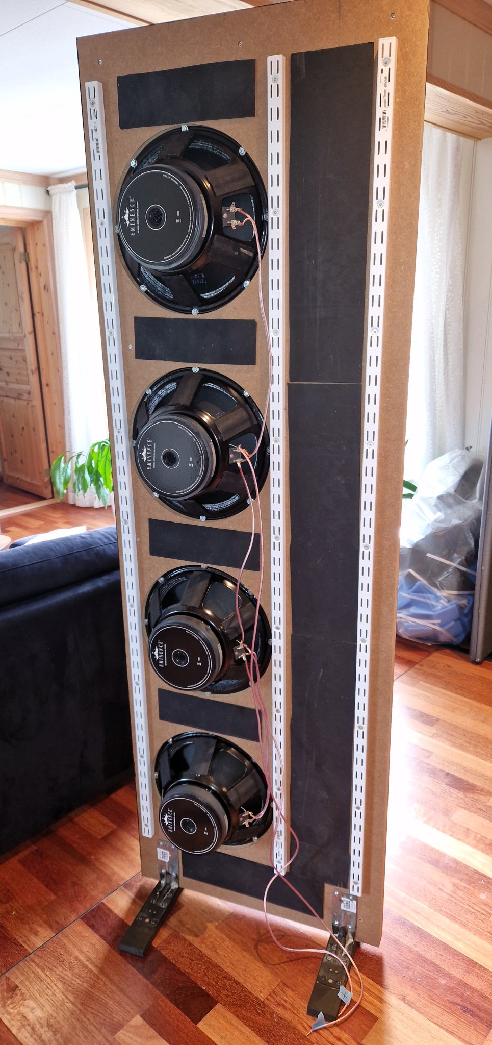

What happened to you big B&G ribbon / multiple woofer system ?My latest creation - dipole mid bass for my more or less butchered Magnepan 3.7s. The baffles are 600x1800 mm, and are using the Magnepan to extend the effective baffle width. Drivers are Eminence Delta 12A. I have four of these puppies, for the L and R front speakers, and the L and R surrounds. The centre channel has something similar. Crossover points for the mid bass dipoles are 80 and 450 Hz.

No worries with Magnepan, since the moving mass of the bass driver is less than 10 grams. The speaker itself weighs about 30 kg.
For my mid bass dipoles I selected drivers with very low Mms. The total moving mass here is less than 140 grams, while the total weight is about 75 kg.
I worry about vibration with OB panel speakers... is there any conclusive data that it is not an issue?
I use braced 3/4" MDF and resonance is not audible to my ears at low to moderate levels. If I listened at head banging levels which I don't, I'm sure I'd get audible resonance.
I used a double layer of 19 mm MDF with steel rails for increased stiffness, and some bitumen sheets for a little dampening. It turned out very good, with no audible resonances, and very little vibration can be felt on the baffles themselves.
As mentioned before, the finished speaker weighs about 75 kg. The moving mass of the four Eminence Delta 12B woofers I used is just 128 grams. The 1/125 rule is satisfied
(1/586)
I think some of the trick is to select drivers with low Mms. I do remember trying the opposite, with a Beyma 21" that had 370 grams moving mass. That did not work so well in a small and light baffle.
