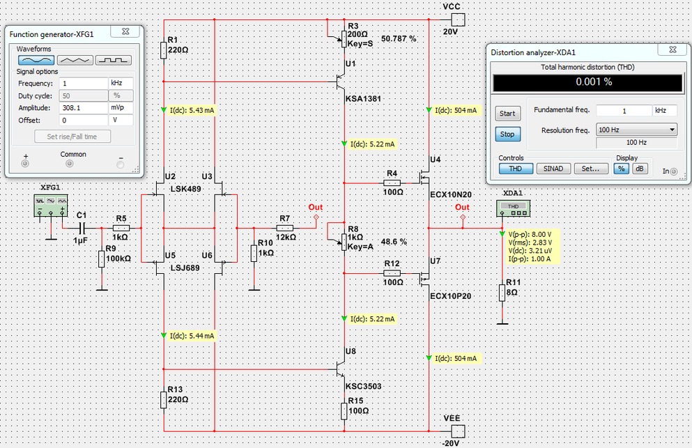

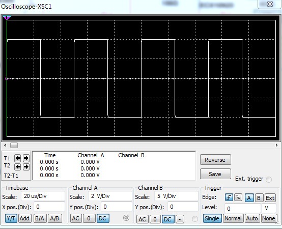

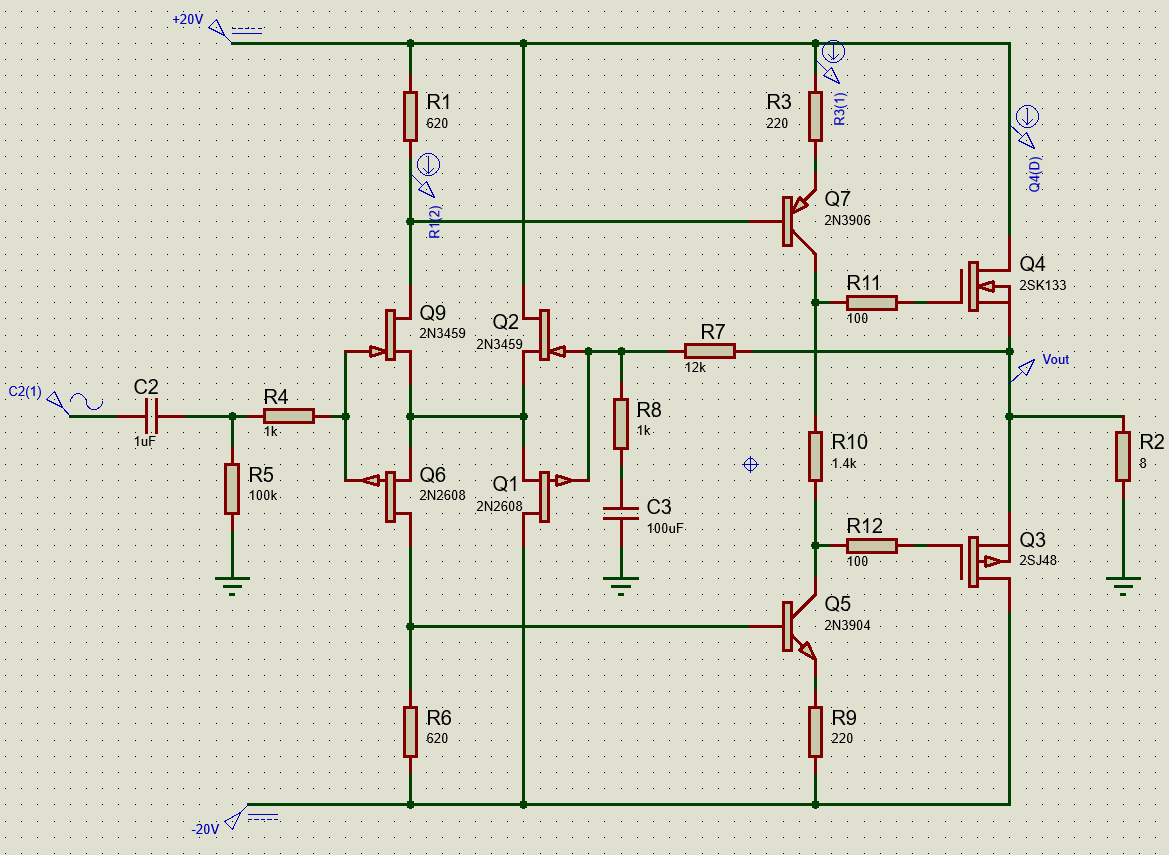

Pondering this further, If I run square wave sims into various capacitive loads, it looks to be stable. However, if I run a Loop Gain sim using the Tian method I can see the erosion of margin, even if I add a small inductor to account for the the self inductance of the wiring. Is simulating capacitive loading with the Tian Probe method reliable? I've never thought to look at it that way. I've used square wave testing to assess this.
My thought is that I’ve done simulations into various capacitive loads from 100n to 2U and saw no signs of instability. So why the inductor?
honestly, I do not know...
I don’t think it will be possible to check anything with this solution, we need to think about it...What do you think of a daughter board concept for the IPS/VAS?

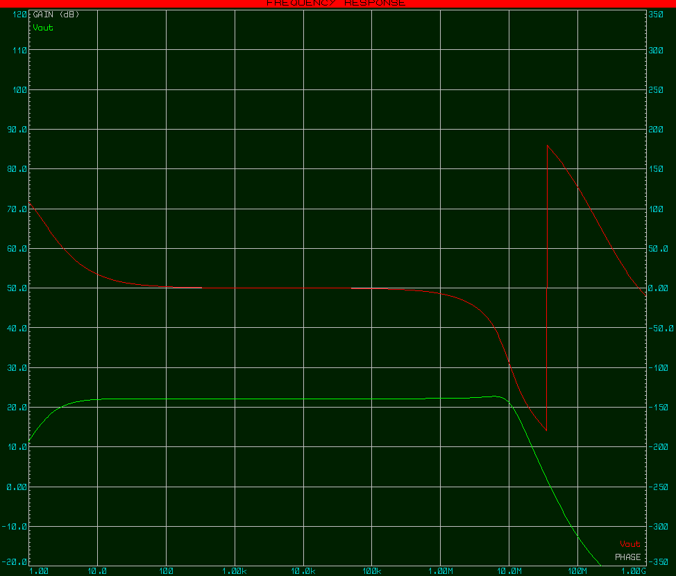

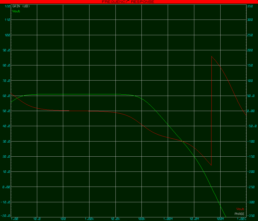

unity gain frequency 29 MHz !?!?, with “jump” in Pi/2 and + 60 degrees. !?!?What do you think of a daughter board concept for the IPS/VAS?
Perhaps I have some incorrect element models. But they haven't let me down yet...
I get a ULGF of 3.1 MHz with 30 db and 65 degrees of margin using the Tian probe method. My VAS models are Bob Cordell's, MOSFETs are VDMOS models from Ian Hegglun on this forum and JFETs are from Linear.
Not clear what you mean by "with “jump” in Pi/2 and + 60 degrees".
at high frequencies on the drains Q1.1 and Q1.2. the common-mode signal is summed at the B-E of transistor Q3.Not clear what you mean by "with “jump” in Pi/2 and + 60 degrees"
everyone uses this method and you it shows that nothing happens, so I think that we have different models of transistors.I get a ULGF of 3.1 MHz with 30 db and 65 degrees of margin using the Tian probe method.

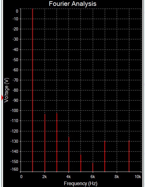

Some progress to report…
I’ve spend considerable time in simulations refining the design with practical concerns in mind. Some of the goals that I’ve tried to attain are:

Another reference I forgot to mention - For Lateral MOSFET stability, the ideas from this thread are used: Revisiting lateral MOSFET stability
From the thread referenced in post 170. Simulations do not reveal any issues. But I've seen several threads mention stability issues with Exicon Laterals, and these gate to drain caps seem to resolve them. Adding them in simulations didn't seem to degrade anything, so I'm suggesting to add them. Until one of us tests without them to see if any issues arise.

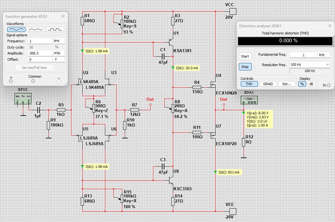

Hi Lineup,
Your design has some key differences from mine. I'd like to explain why I chose different values.
- Gain: You design has a higher gain. I choose to lower the gain with more feedback to address distortion that was rising rapidly with frequency. I suspect your THD sims are all at 1kHz. Try looking at 10kHz and 20kHz to see how more feedback affects it.
- VAS Current: Similar to #1, more VAS current helps at higher frequencies.
- IPS Current: I'm suggesting 1mA because this seem to be the NULL tempco point for LSK489/KSJ689. You get a bit less slew rate, but more temperature stability. You'll see Linear's and Bob Cordell's design notes using this current It's not explicitly stated, but I suspect this is the reason. I also have degeneration on the P channel to address gain mismatches between the P and N channels at 1mA. Linear and Bob Cordell both discuss this.
- MOSFET gate stoppers: I'm using higher values as well as caps across the gate to drain. This is to address stability concerns that arise in practice. Simulations WILL NOT reveal this. Many builds on these forums using Exicon devices all discuss this issue. The solution if higher gate stoppers and caps across the gate and drain. Take a look at the thread I referenced in post #170.
- Device models: Since this is a simple design, it's sensitive to parts selection. Especially the VAS. What models are you using for the VAS? Are they D or E grade? This makes a big difference. Benpe and I are both using NOS SC3503E/SA1381E for our testing. These are out of production parts. I'll be testing later with in production SC3503D/SA1381E. Based on sims, the gain mismatch on these will cause DC offset in the 30 to 50mV range. I plan to address this using different resistor values to N vs P sides. My sims tested with models from Bob Cordell and Cabirio (found here). In addition, I modded these models to adjust the gains to see how it affects DC offset and OPS bias stability with regard to temperature.
- Feedback Cap: Your design lacks a feedback cap. I'm assuming you are not running temperature and voltage variance sims. I found that a feedback cap is needed to guard against DC offset changes that occur with temp and voltage changes that will occur in the real world.
- Miller Caps: You are running much higher values. With my 15p caps, I'm getting 25db and 65 degrees of margin on Loop Gain analysis. Can I ask why you values are so much higher? The margins I am getting seem high enough for stability.
- Higher Rails: I'm running higher rails to allow for a 25W region that is out of clipping and has good performance. If you look at the graph I attached in post 166, you can see that distortion climbs much quicker after 25W. Also, 24V to 30V main rails seem to offer the best economy with a 2U chassis, allowing the design to make full use of the heatsinks without running too hot.
- Output networks: Your design does not have a Zobel or Theile network on the output.
