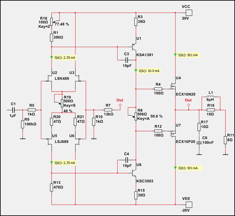

yep, a truly matched quad would of course be best. most diyers do some spot matching: IDSS, maybe VP, but not transconductance, any of the various capacitances, etc. true curve tracers are rare and expensive. most importantly, our resident semiconductor gurus here will tell you cannot have perfectly matched N & P devices anyway while residing in our universe (laws of physics and such), so you'll have to cheat to get good complementary matching done anyway 😈. or get a good time machine to go back to the time of the 2SK163 and 2SJ44 devices from NEC. It seems they were about the best complementary pair of low noise, high gain devices available for us regular people.

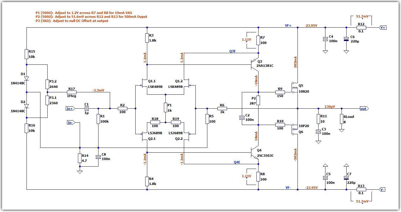

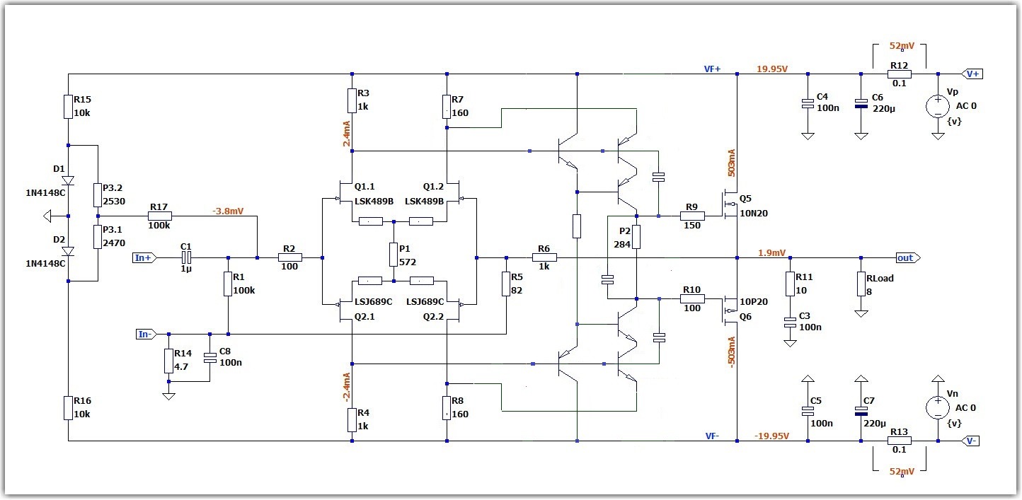

Bob Cordell discusses using LSK489/LSJ689 in his book (Chapter 9 figure 9.12). He recommends adding 100R source resistors to the LSJ689 to balance out the transconductance issues. Something like this. It seems to perform similiar to LSK170/LSJ74 in simulation.
@Hennady Kovalsky
Interesting circuit. You have added components.
Is the performance good? THD? Bandwidth?
I have added resistors like that in the sources.Bob Cordell discusses using LSK489/LSJ689 in his book (Chapter 9 figure 9.12). He recommends adding 100R source resistors to the LSJ689 to balance out the transconductance issues. Something like this. It seems to perform similiar to LSK170/LSJ74 in simulation.
I have changed the DC-offset again.
I have increased the VAS current to 10mA.
Here is the current version. THD is 0.00050%

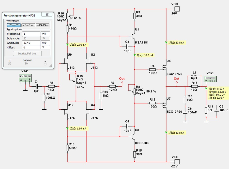

I think J113 works best with lower currents.Another question for the experts: We often see 2mA used for LSK170/LSJ74 IPS. Is there a similar heuristic for J113/J176?
Nelson Pass Uses 0.5mA per J113 in his DIY FrontEnd 2022.

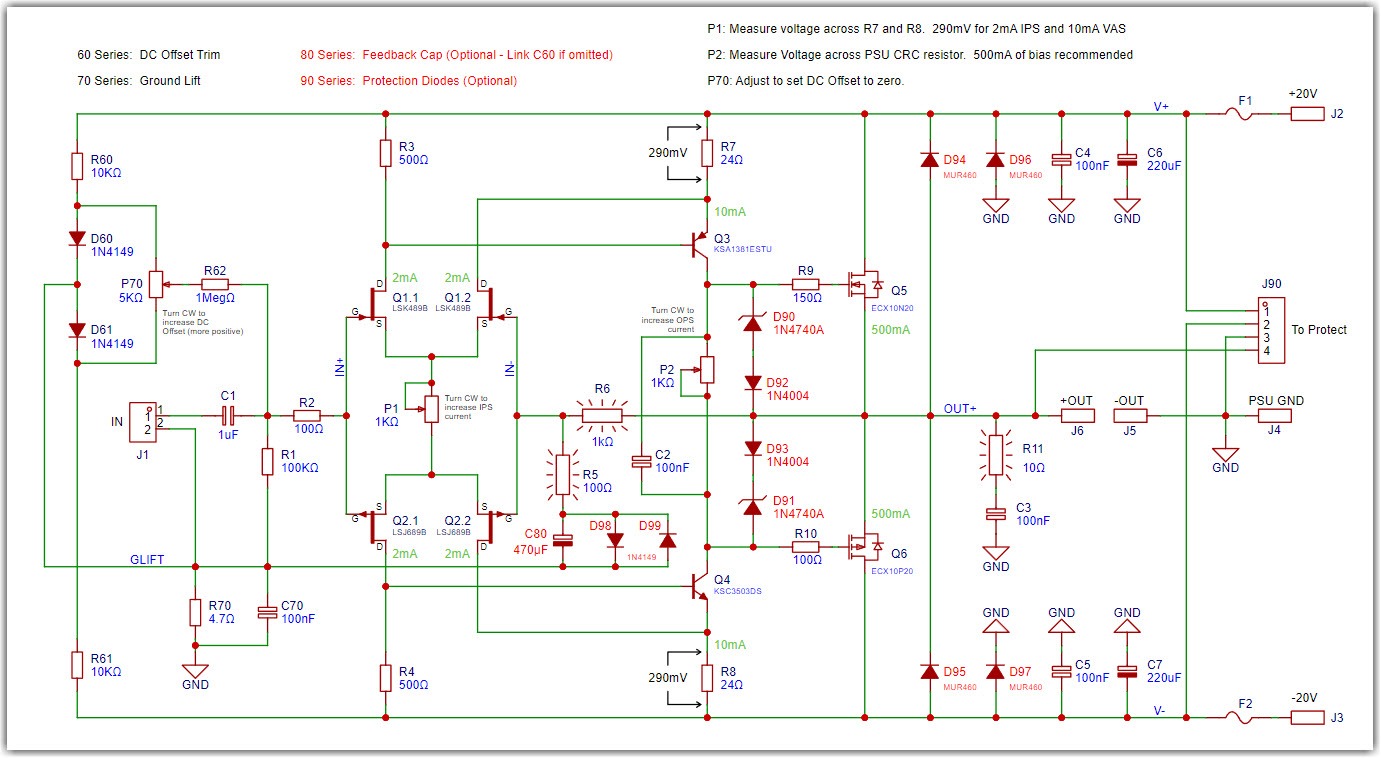

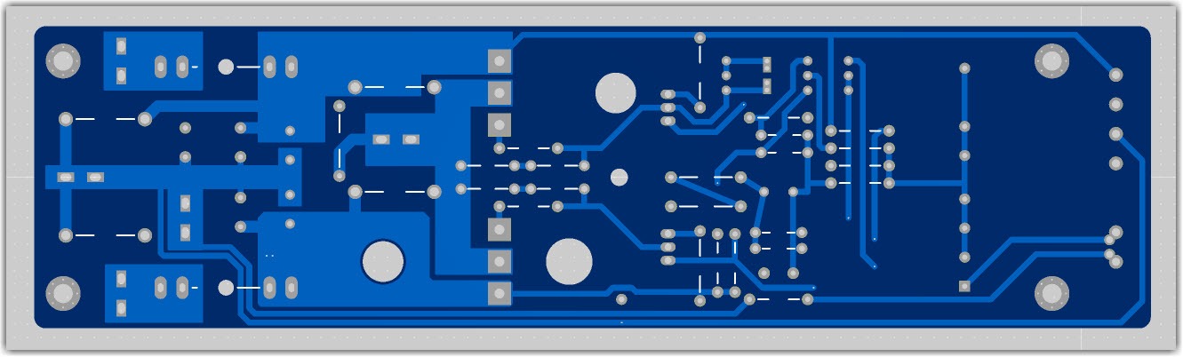

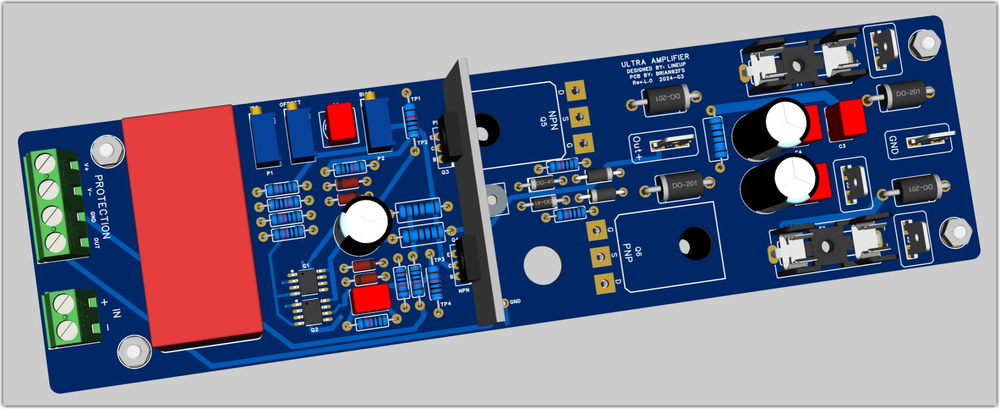

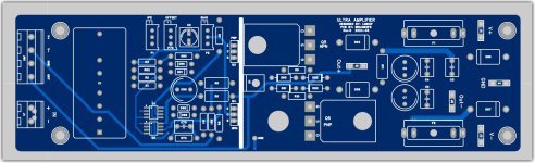

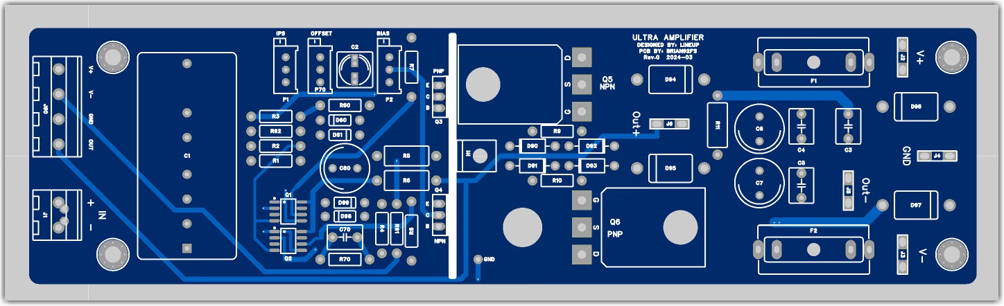

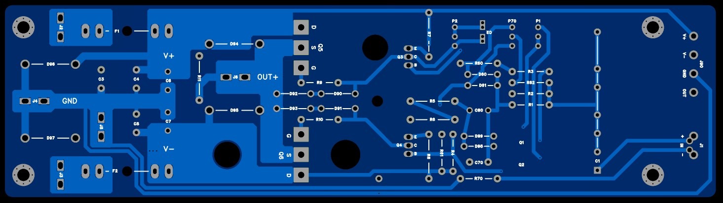

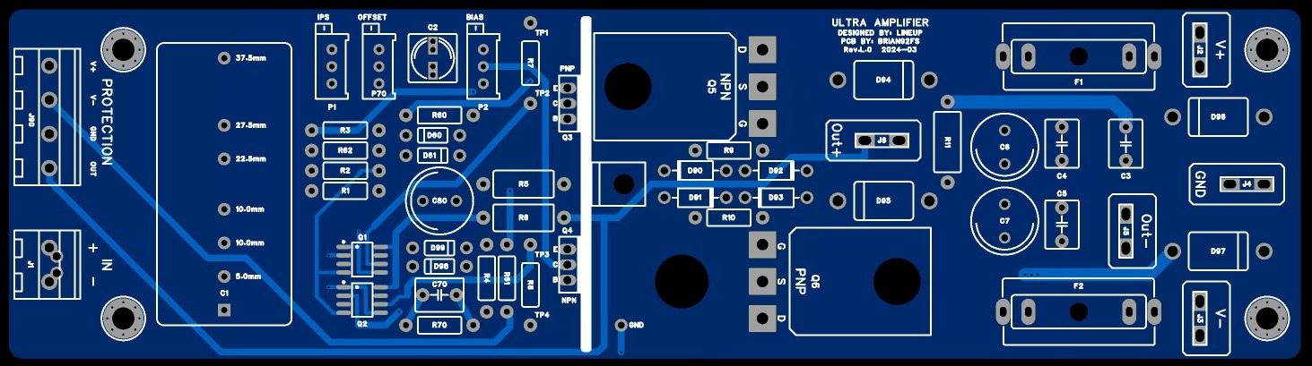

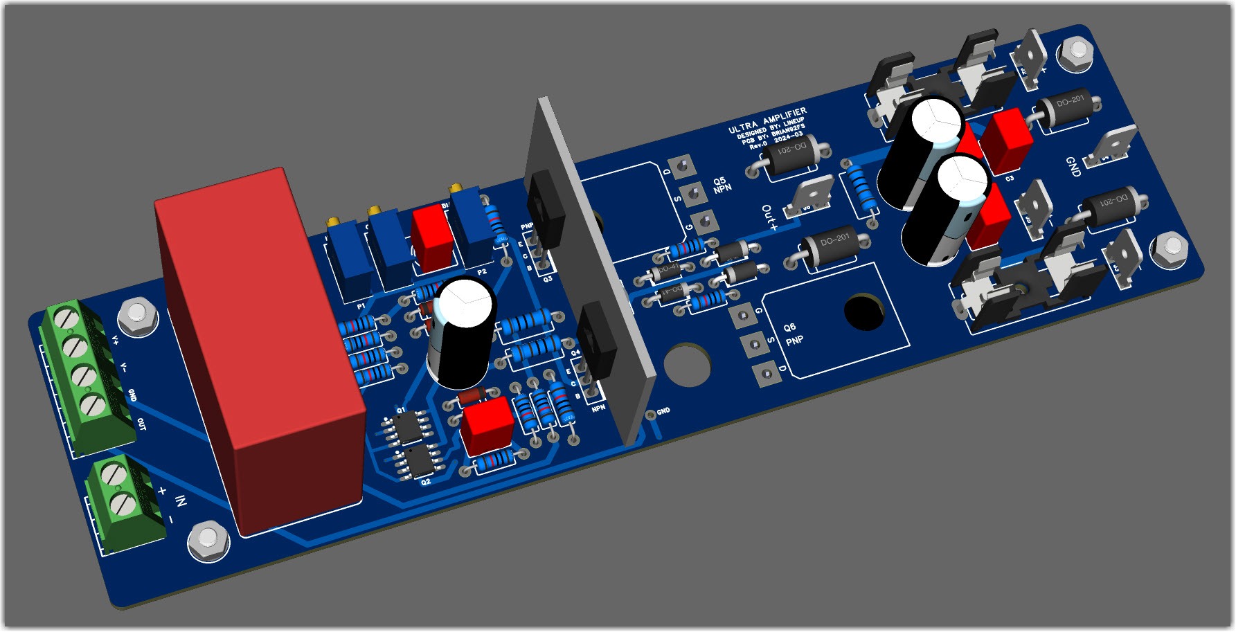

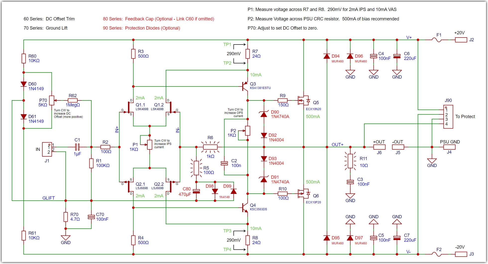

Getting closer on the PCB. Probably needs a bit of tweaking still and a check of the silkscreen elements. Also need to cleanup the pours.
A couple of notes on my thinking:
- The values on the schematic are from my version of the design. However, the board should accommodate most of the different versions of the design that have been proposed.
- JFETS are LSK489/LSJ689 in SOIC package. The boards can be modified to use other devices in the future.
- It is designed to work with Dissipante 2U 300mm deep heatsinks. The clear space on these heatsinks after accounting for mounting brackets should be 59mm x 260mm. This board is 52mm x 192mm.
- The R7 & R8 measurement resistors have a longer pitch to allow for easier attachment of probes to the resistor leads.
- The feedback network has provision for 1W devices if the builder wants to use lower value resistors for noise considerations.
- A provision for a DC cap on the feedback network has been added (80 series numbering). It has bypass diodes to allow for a smaller devices to be used if the feedback network is low noise. It is yet to be determined if the DC offset will be stable without it. If it is not needed, the cap can be replaced with a link.
- Provisions for protection diodes and a connector for a protection board has been added (90 series numbering). These are all optional
- The bias pot bypass cap C2 has provision for polyester and electrolytic devices. This allows a higher values to be used if needed during the actual build.
- The VAS transistor heatsink uses 1/16" (1.6mm) thick flat aluminum stock. It is mounted using a Keystone 616 L bracket.
- There is a ground pad near the VAS heatsink if the builder wants to ground it.
- The extra hole near the output devices is to allow for the mounting of a temperature monitoring device. This would be used by the protection board, which is outside the scope of this thread.
- As show, it uses side adjusting pots which allows for it to be adjusted from the top when mounted in the chassis. However this would require a second PCB for the right side. I may try to do this... depends on how much motivation I can muster.

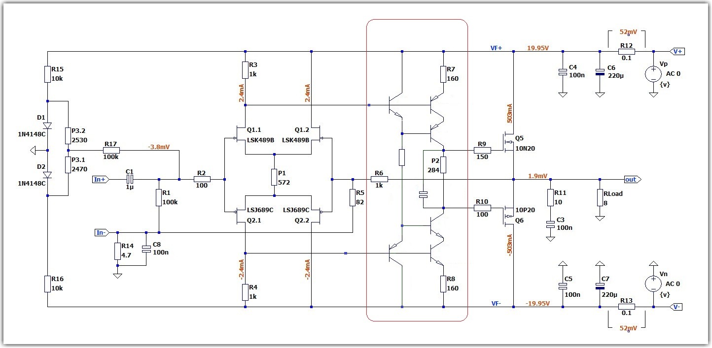

beautiful layout!Any feedback on the layout?

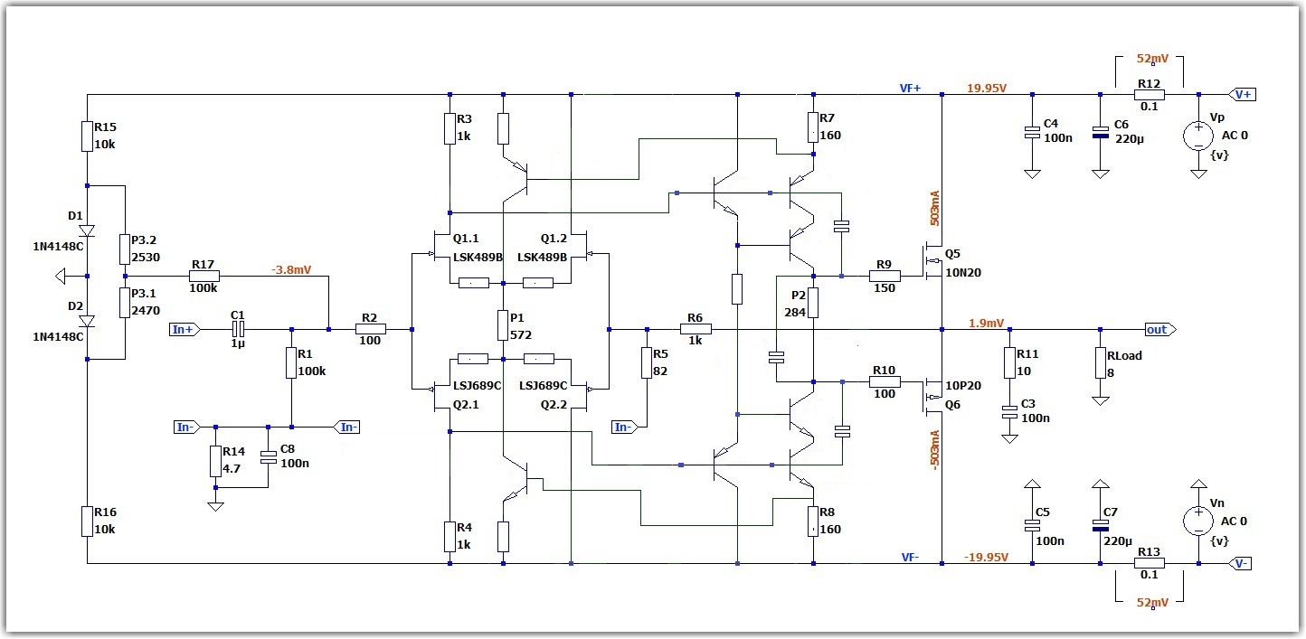

But the circuit is not ready yet, the current Q3Q4 is very weak for linear control of the output transistors, Q1 and Q2 do not amplify anything.
What is the dependence of the stability of the operating point on temperature and the level of potential difference in the supply voltage buses?
Q3/Q4 have about 10mA, plenty to drive MOSFETs, perhaps a bigger problem is the +/-20V rails giving little headroom - it takes a fair few volts to turn on laterals, with low voltages this becomes a substantial loss of output range unless the drivers have separate higher voltage rails, such as +/-25V
Say the output devices have 1nF of gate capacitance, and you need to charge the gate to 6V above source, that's 6nC of charge each, so 10mA can charge two of those in 1.2µs, which is fast enough for audio. Of course more loop gain would help stop distortion from rising at higher frequencies where the drivers work harder, but you don't have to worry about slew limiting.
